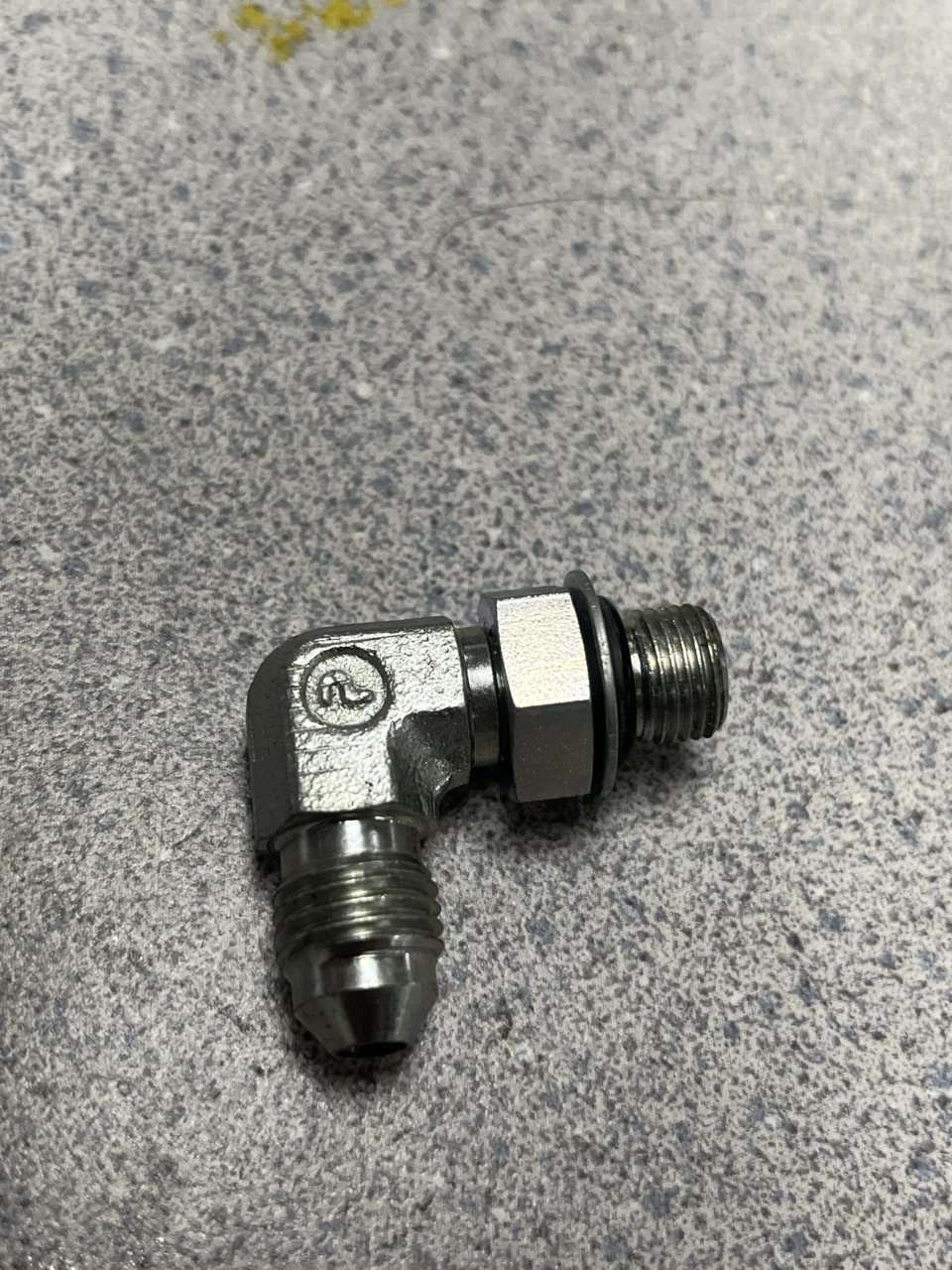

    Looks like I already have one. 1/8”BSPP x 1/4” JIC. Then I’ll just make up SS/Teflon hose for the feed.
    I know 5/8 hose is recommended for return but is 1/4” suitable for the inlet?

    Yup

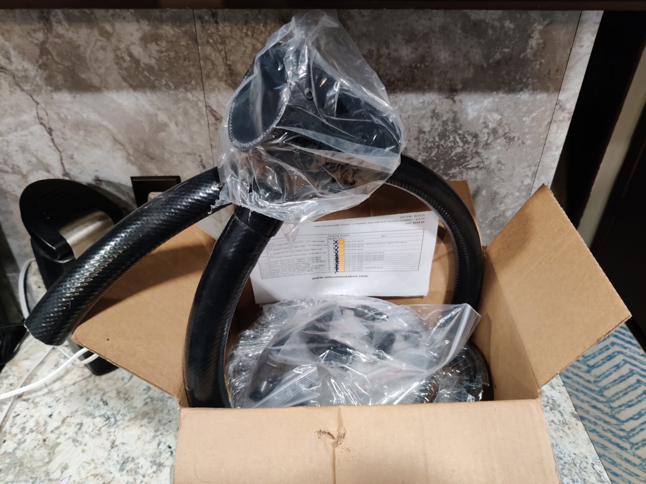

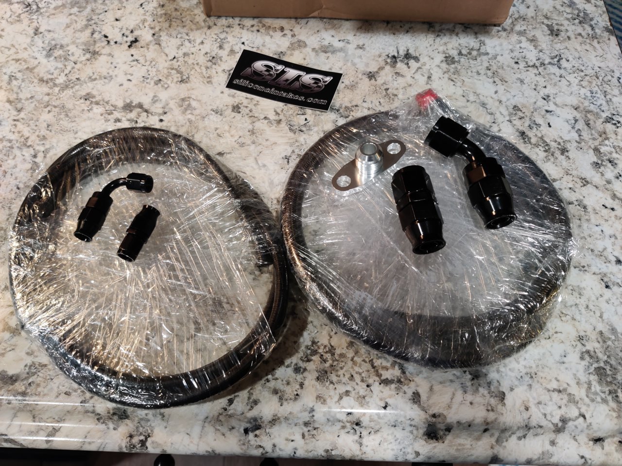

    Man I just ordered a 1/8th npt tee. Looks like I'll be swapping it for that one posted above. I just received everything else I need for the oil lines from Silicone Intake solutions
    3ft 10AN (I hope I got enough) 5ft 4an.
    I think I'll have what I need for the recirculating BOV now too.
    I also got 2 of the 2.75 to 2.5 couplers for the MAF.
