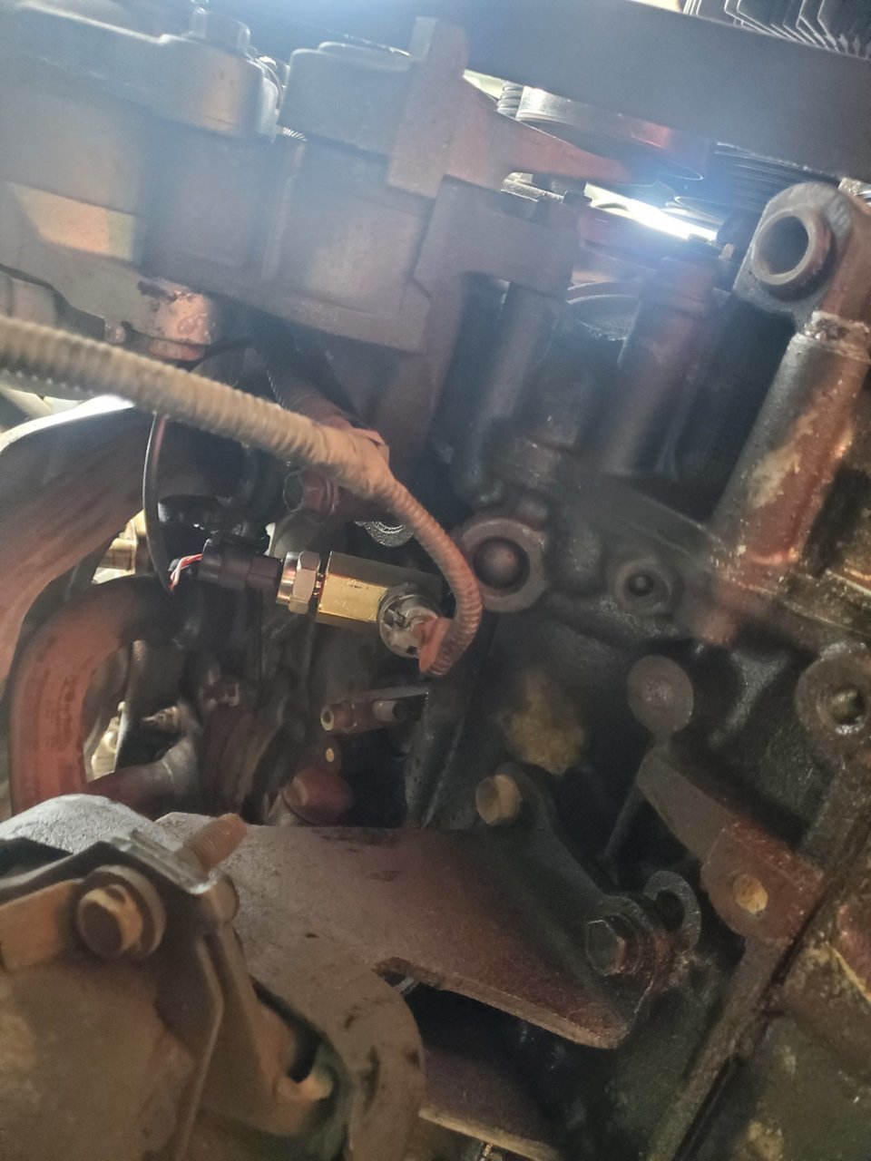

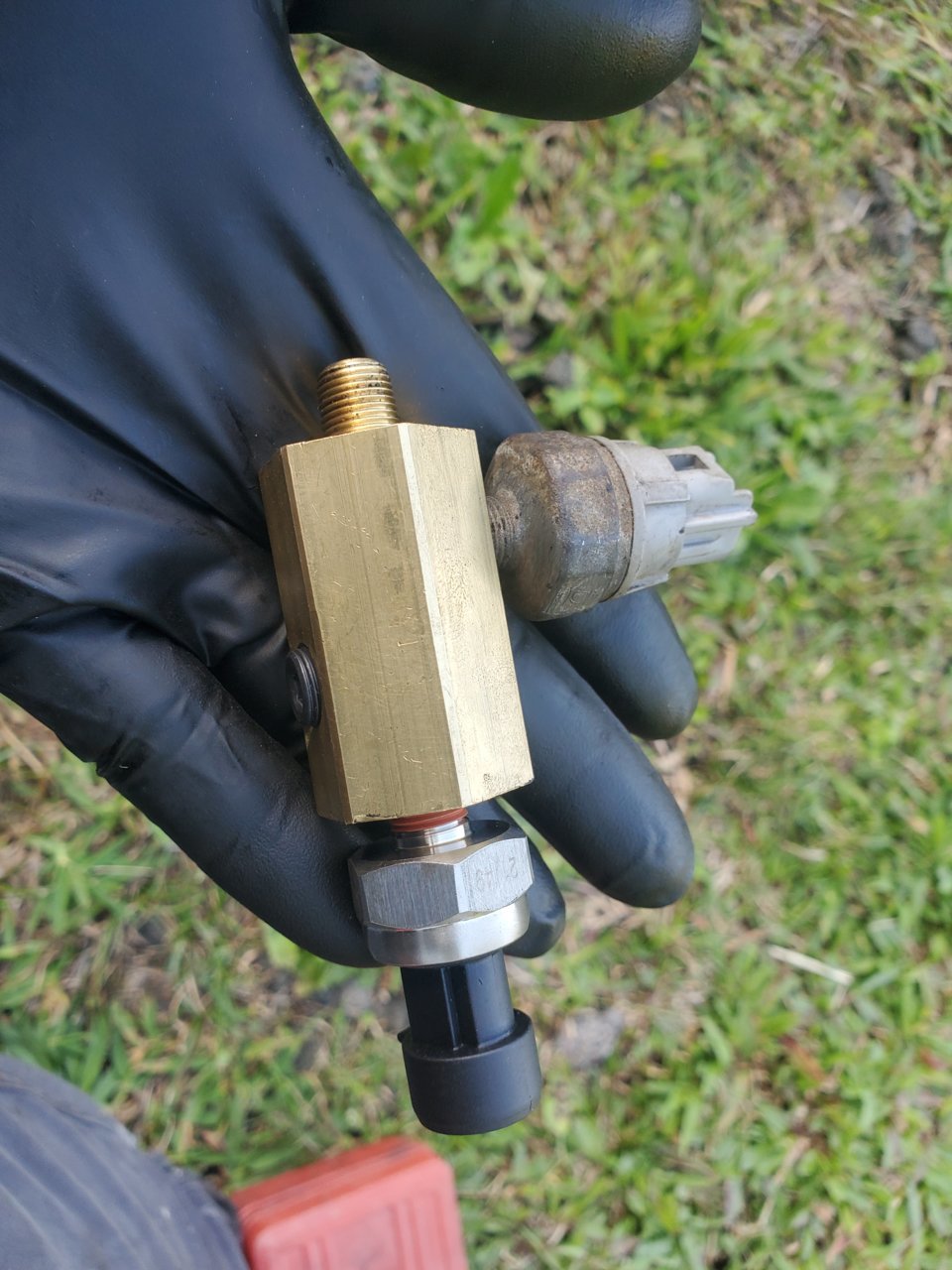

    Behind the alternator is factory oil pressure sensor. Just take it out and lego the pieces together.

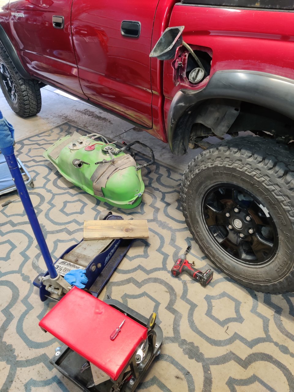

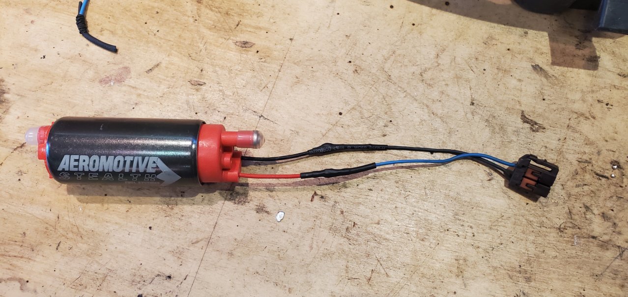

    In other news I took advantage of a mostly empty fuel tank and installed the Aeromotive 340 fuel pump. I was expecting it to be noisy but the neoprene sleeve it comes with must be doing its job
    It's a small step in the turbo build that I'm glad to be done with.

    I didn't. Just soldered the old plug onto the pump. No problems so far and should be fine for the power figures I'm at

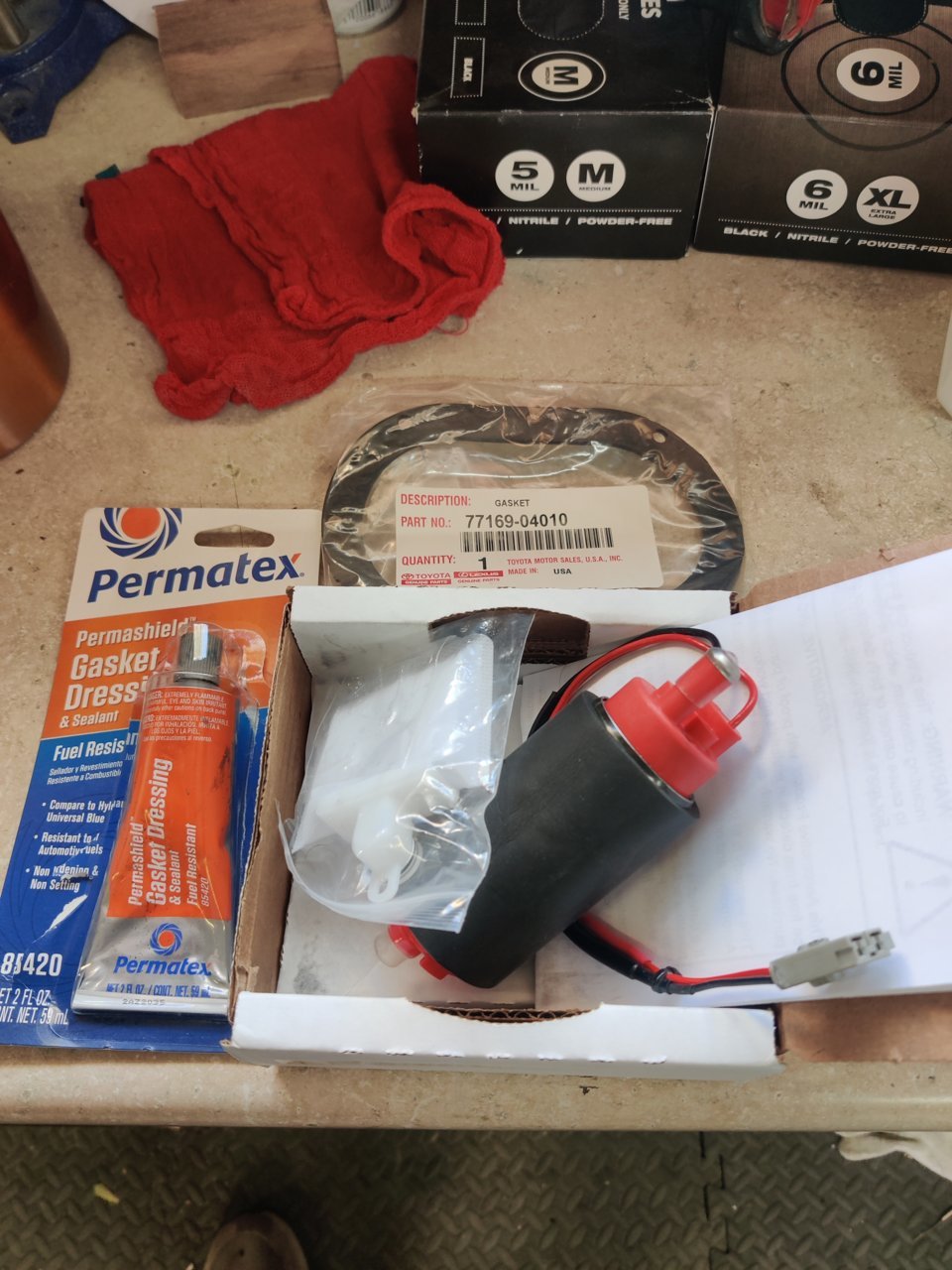

    I did the same thing, soldiered the plug to the pump.
    I also use permatex on the pump gasket and love that stuff. It doesn't really dry and can be a pain to clean up but It does the trick

    what was your reasoning to putting rtv behind the pump gasket? if you have a new rubber gasket you shouldn't need any additional sealing

    The stuff he used isn't RTV, its commonly known as hylomar, its non setting, just helps gaskets seals on rough surfaces, probably not necessary but wont hurt anything.

    I had issues with a leak for a long time. changed the gasket, didn't work. changes the pump hanger assembly and gasket and it still didn't work so I got a new tank, another new gasket and installed it all with the permatex stuff and haven't had issues since. I probably didn't need it but since I had it on hand I used it

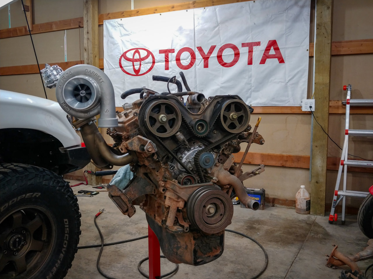

    Little mockup before I go back to cleaning.
