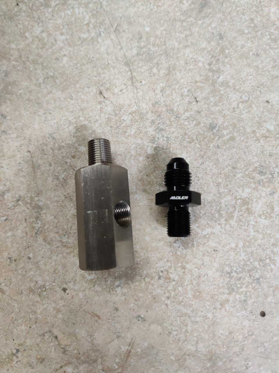

    Good feedback thank you. I hadn't thought about flow reduction while heater is running I'd like to think it's not enough flow reduction to make much of a difference. Don't some of the 4runners have extra coolant lines for back seat heaters?
    I will switch to a metal Tee but the ones posted above aren't the correct size for me
    Side note I thought I'd check this out as an alternative to Teeing into the oil pressure sensor for the oil feed. Just slap this bad boy into the plug below the oil pressure sensor.
    Podavelle 4AN Male Flare to 1/4 NPT Pipe Male Fitting Adapter Union Coupler Straight Aluminum Black https://www.amazon.com/dp/B09KY7JR94

    Thought about this as well, but the T may be nice if you wanted to run a pressure gauge as well. You planning to run an oil cooler pre turbo?

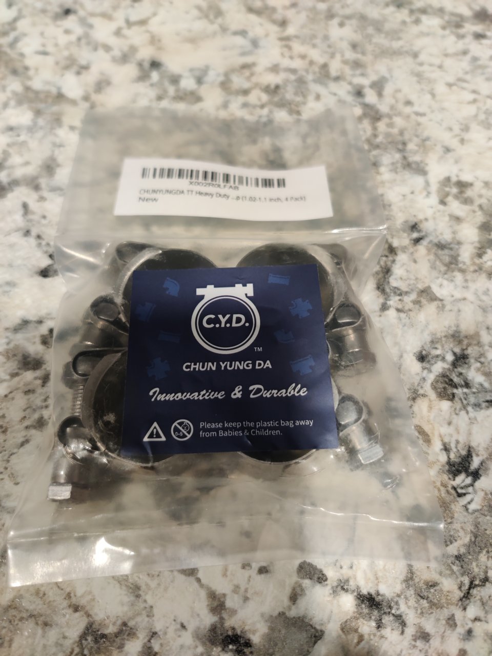

    Side note
    I checked the fitment on these clamps for the 25MM BOV and they are too small so I ordered the next size up hopefully they fit. These clamps are 3/4" wide and seemed sturdy
    Next size up is 29-31mm. We'll see how it fits in a few days
    CHUNYUNGDA TT Heavy Duty Hose Clamps-Clamping Hose OD 29-31 mm, Stainless Steel Solid T-nuts, Band and Screw for 1-1/8 Fuel Line(1.14 -1.22 inch,4 pack) https://www.amazon.com/dp/B08P54F6RQ

    The port below the oil sensor is larger than 1/8 bspt. I say it is 1/4 from memory.

    :anonymous:Good thing I wasn't depending on it,
    They may have had a 1/4 option.
    ill still need it to connect the oil feed line too the Tee now that I think about it so it's not a waste after all just.

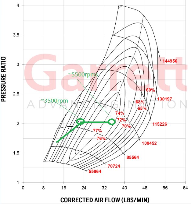

    Damn, that was a long read. Finally made it through the many pages/posts of this thread with very little skimming (ok maybe more than a little, but not much).
    Sorry for the brain dump below in advance...
    I think I have concluded, that for the 5vz the gt3076 spec'd turbo would be the most ideal, for my power goals (325-350 crank HP tops) but now what I am trying to figure out is essentially what turbine a/r to go with (.63/.82/1.01).
    How I am understanding it is, the lower the a/r the quicker to spool at lower RPM? So for example sake:
    .63 = 2300rpm
    .82 = 2750rpm
    1.01 = 3000+rpm
    The above numbers are just pulled out of my ass and me speculating based on everything I have read thus far, hoping someone can gauge me on that or am I completely off base?
    If the above is more or less correct, than I would be leaning more toward the .82 a/r to try keep out of cruising or closed loop boost as much as possible (my normal driving and shift patterns are at or below 2500rpm). Reasoning behind that is that initially I wont have any tuning/piggyback so won't to avoid any boosted/lean situations as much as I can. I did have expectations to graduate to a piggyback ecu, but am noticing the options are now very limited due to discontinuations and alternatives still out there are rather pricey. Other short/medium term solutions I have been thought about and looking into further are a Split Second Enrichner to possibly help those close loop boost situations and/or Meth set up to supplement AFR into more richer territory if needed while open loop boosted at higher psi, but am aware those are band-aid solutioning a situation where ultimately the way really solve would be to go piggyback or stand alone.
    Below is the 3076 compressor map and plotted points where at my power goals would roughly be, based on walking through the garret site reference material here. If I did it right, that would be somewhere around running ~13 PSI to reach that goal which would be a long way down the road if ever realistically. But even at lower PSI to start the truck would be running through the efficiency islands of that map pretty nicely yes? With no real concern of surge or choke
    again sorry for the wall of text, just needed to type it out and hear myself think essentially.

  13. Mar 23, 2023 at 8:22 PM

    Jon
    2000 4runner, 1996 Tacoma
    Yeah, pretty much.
    Just got to say 35r with .82 is quite responsive. Can't imagine a 30r.

    Maybe too much then? I know I seen in your thread but your on a 3576 or 3582?

    Its a 3582r. If you have a deal on a 30r kit, don't hesitate. You will definitely need tuning for those power goals.

    @GoJo
