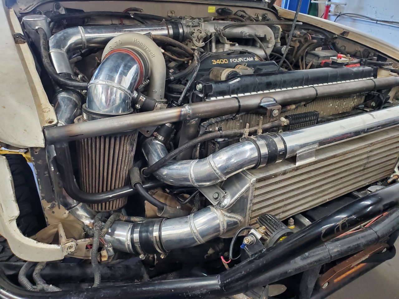

    It has an intercooler.
  11. Mar 31, 2023 at 5:39 PM
    Yota X
    Yota X Some say dresser, I say dryer.
    Jul 11, 2019
    #298961
    5,268
    NW New Jersey
    1st gen
    ls turbo, tons, 40's and a partidge in a pear tree
    Did you fab up that core and piping?
  12. Mar 31, 2023 at 5:50 PM
    Jon64l
    Jon64l Well-Known Member
    Jan 12, 2016
    #174799
    1,691
    Jon
    2006 Tacoma, 2000 4runner, 1996 Tacoma
    I fabbed the entire kit.

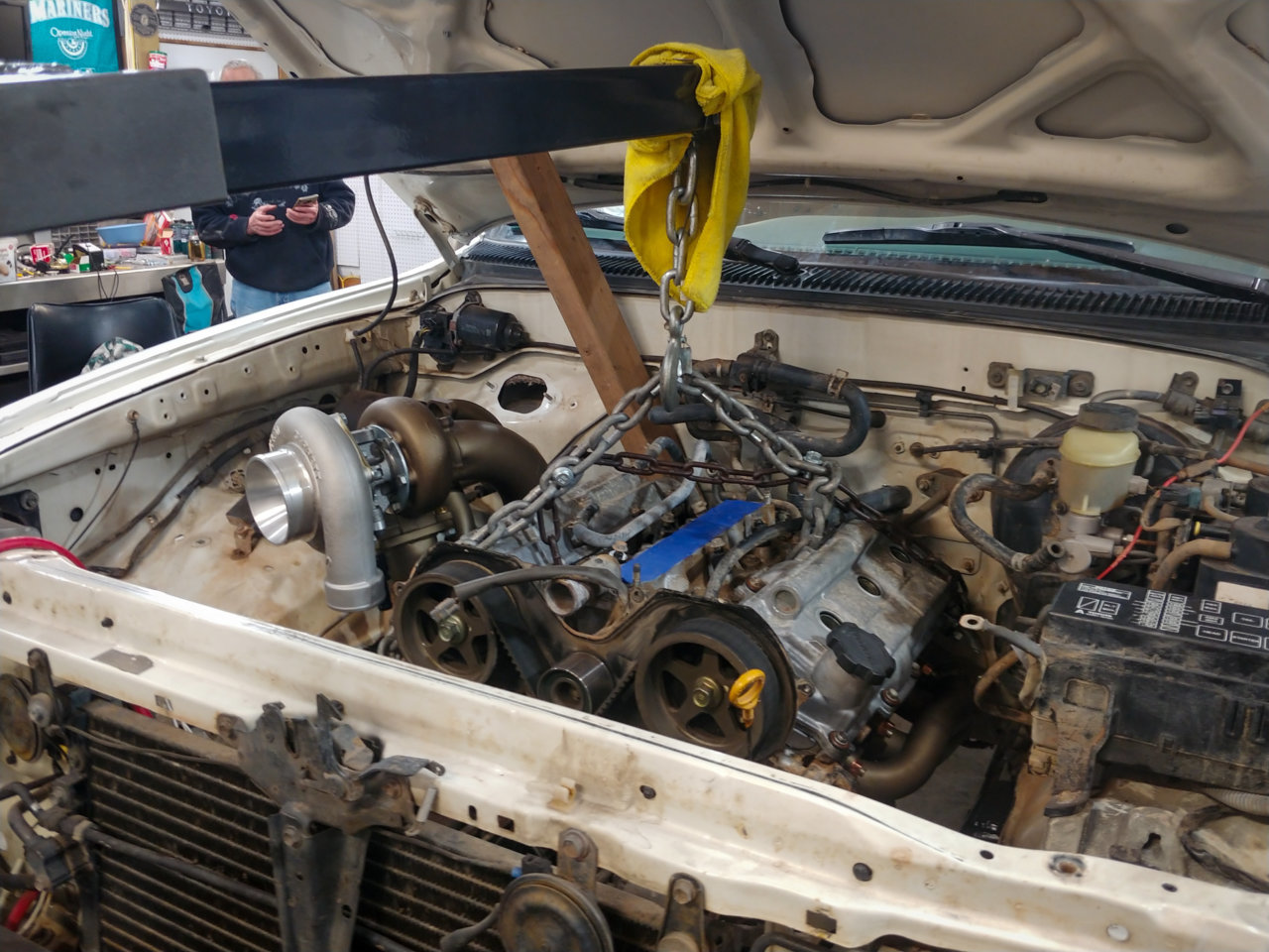

    It looks much better in here than on my office counter.

    Can't wait to see this come together. You have an IC kit figured out?
    Speedytech7 likes this.
  20. Apr 2, 2023 at 9:33 AM
    Speedytech7
    Feb 20, 2014
    #123587
    58,586
    FCQM+VG Cheney, Washington
    It's less Tacoma and more mod
    Yeah measuring for one of the ones from frozen boost. Water to air is kinda the only option I have avail. Hey do you have any pics of your oil drain bung location on your pan, I found a decent area and got it put on, but I'm not 100% sure if it is above the level or not
