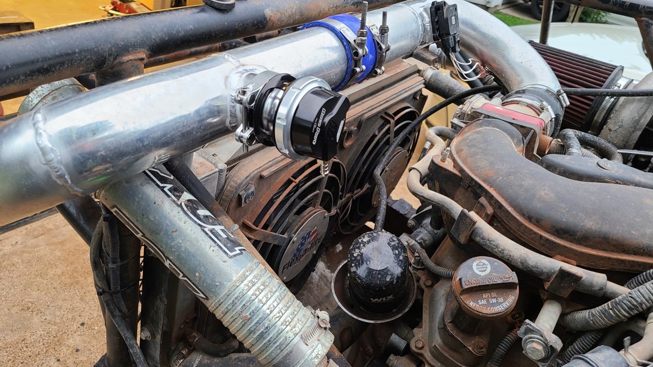

    Torspd Custom Turbo kit [] Borg Warner 9180EFR Turbo [] Haltech Elite 2500 [] TiAL Q BOV [] TiAL V44 Wastegate @ 15psi [] CP Pistons [] CP Carrillo Rods [] ARP Head studs [] ARP Main Studs [] ARP Header - Head Studs [] Ported Heads w/ 1mm oversized valves intake/exhaust [] Brian Crower Forged Stroker Crank [] Darton M.I.D. Sleeved Block [] Kelford Camshafts [] Torspd 160* T-stat mod [] APR Large Fuel Rail [] Walbro 460 LPH E85 Fuel Pump [] FueLab FPR [] APR T56 Conversion Kit [] KP RACING Built T56 [] McLeod Racing Custom Twin Disk Clutch [] One Piece Aluminum Driveshaft [] MGW Shifter [] Custom lowering kit [] Ohlins Front Coilovers [] QA1rear shocks [] Custom Ron Davis Radiator [] Dual SPAL Electric Fans []
    BOV pre MAF works fine. As long as you give it about 6 to 8 inches gap. May or may not require a flow straightener.

    I have the TiAL BOV. Changed the spring out so that it is closed during idle.
    Speedytech7 likes this.
  19. Apr 7, 2023 at 9:07 AM

  20. Apr 7, 2023 at 9:09 AM
    Speedytech7
    Feb 20, 2014
    #123587
    58,575
    FCQM+VG Cheney, Washington
    It's less Tacoma and more mod
    That's good looking!
