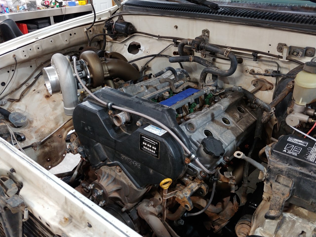

    If I could have changed one thing for that build, I would have used a Synapse Engineering BOV. It's design would have made it much harder to have debris intrusion. Given where that truck spent most of its time.

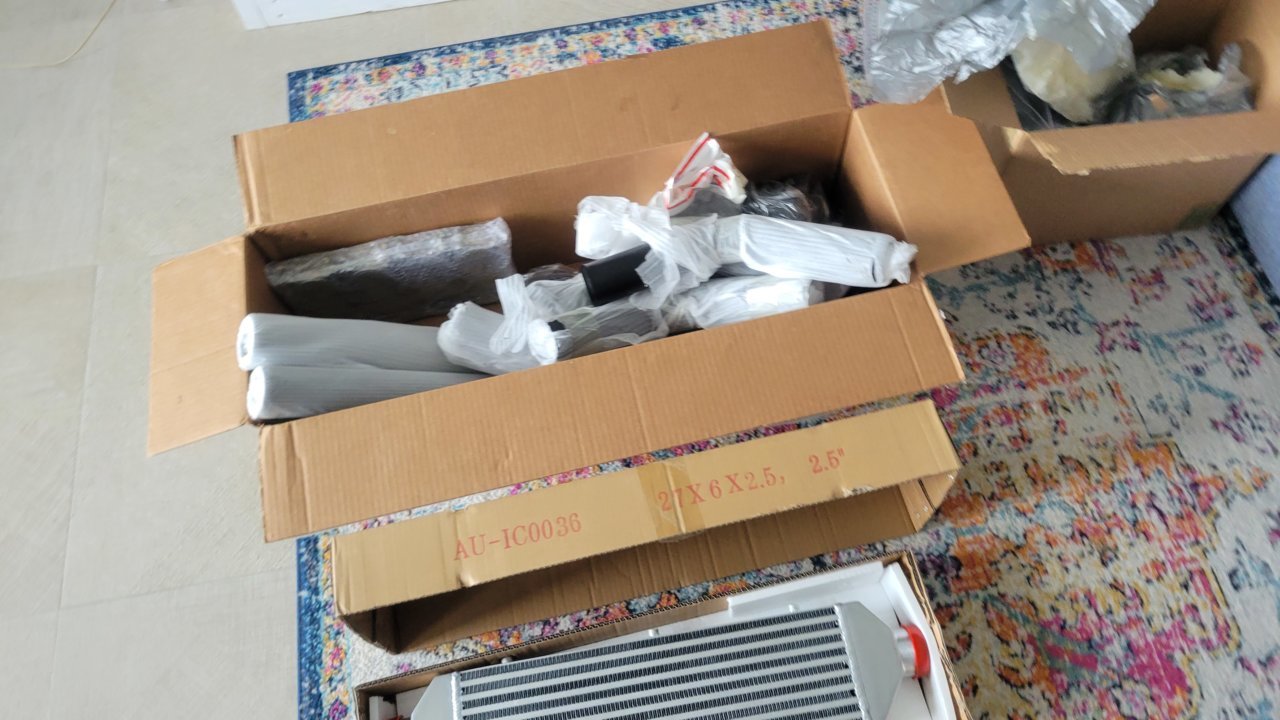

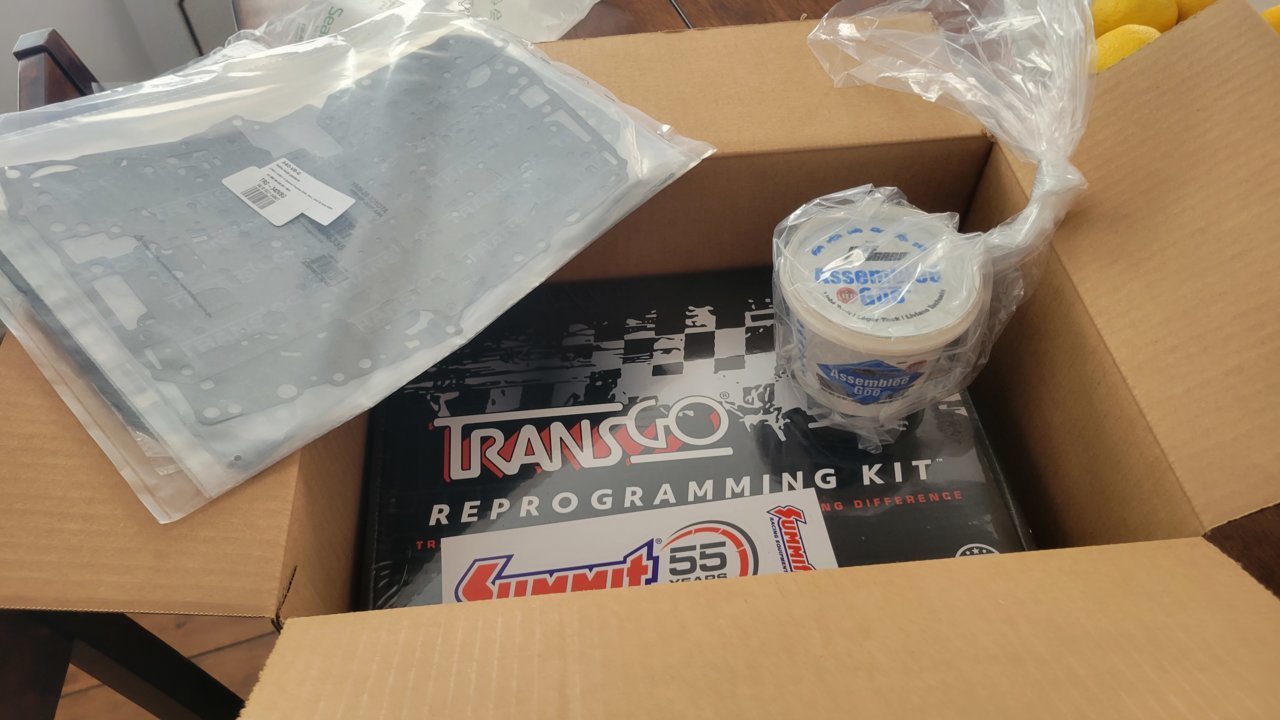

    Mas goodies, sorry speedy no feet pics this time ;)

    Happy Easter Goodies!

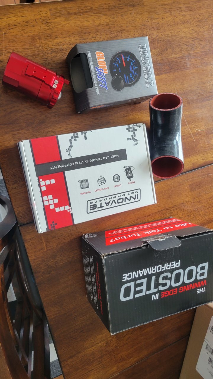

    I'm over here turning my laptop upside down trying to read boxes

    Gotta make you work for the goods! :rolleyes:

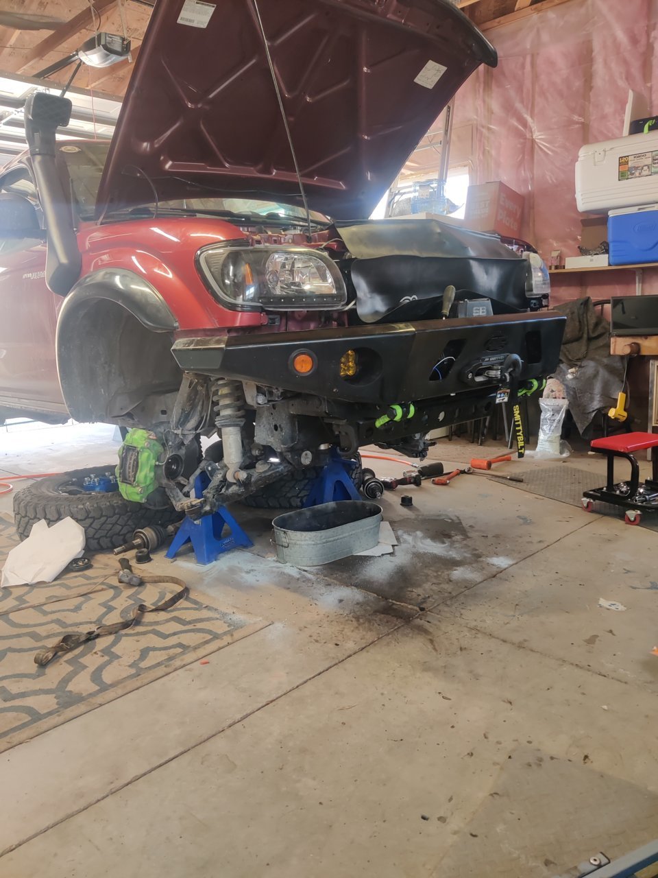

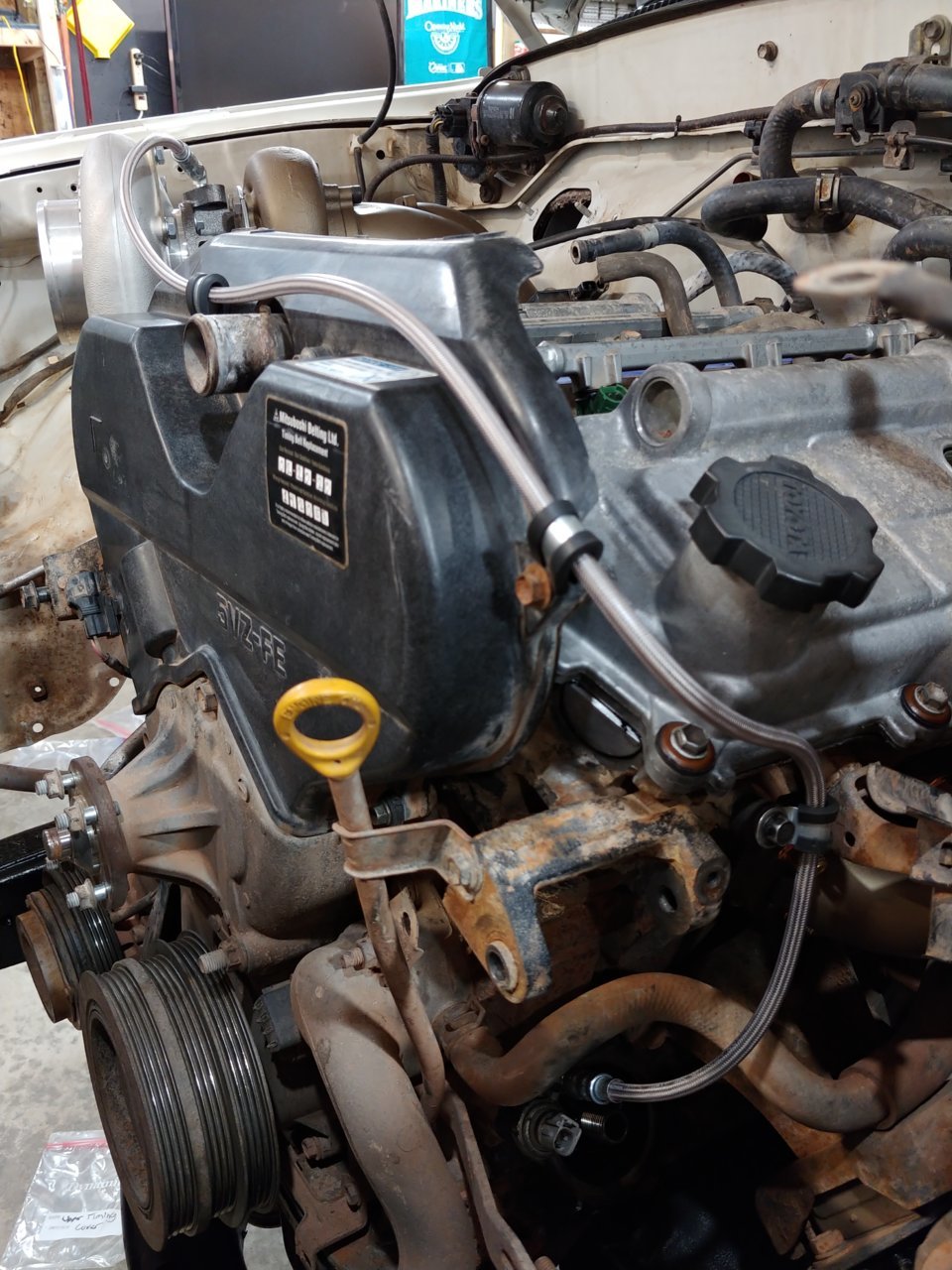

    Well the feed line is run now, that wasn't fun to finagle in there.

    Two most important parts are in the engine bay. Win.

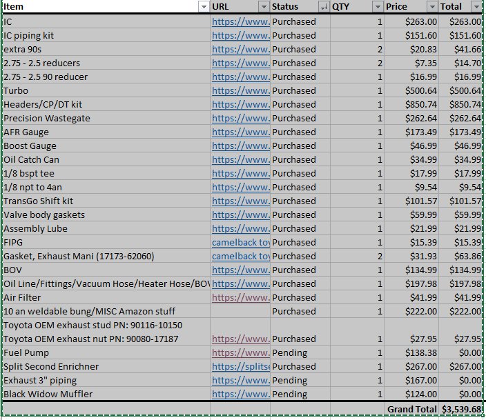

    Have had a couple asking in other threads so will post it here but looking to be about ~4k for my set up to start (no EMS or Meth Injection yet):
    URLs if interested:
    Item URL
    IC -- https://www.cxracing.com/IC0036?search=IC0036
    IC piping kit -- https://www.cxracing.com/KIT250-EB-BLK?search=KIT250-EB-BLK
    extra 90s -- https://www.cxracing.com/SH250-4BK-90-85?search=SH250-4BK-90-85
    2.75 - 2.5 reducers -- https://www.cxracing.com/SH275R250-3BK-76?search=SH275R250-3BK-76
    2.75 - 2.5 90 reducer -- https://www.amazon.com/dp/B0BKP5L7BW?smid=A14677NNBRVIZ1
    Turbo -- https://www.cxracing.com/TRB-SGT3582-82-T4-V-RR?search=3582 .82
    Headers/CP/DT kit -- https://www.cxracing.com/products-b...on-lexus-4runner-tacoma-hulix/MF-DP-5VZFE-KIT
    Precision Wastegate -- https://www.amazon.com/gp/product/B00BNAJNA4?ie=UTF8
    AFR Gauge -- https://www.amazon.com/gp/product/B072MXHR5Y?ie=UTF8
    Boost Gauge -- https://www.amazon.com/gp/product/B007FHHEVO?ie=UTF8
    Oil Catch Can -- https://www.amazon.com/gp/product/B0B4ZJYK3K?ie=UTF8
    1/8 bspt tee -- https://www.amazon.com/gp/product/B07PK9JHQM?ie=UTF8
    1/8 npt to 4an -- https://www.amazon.com/gp/product/B00408NTEM?ie=UTF8
    TransGo Shift kit -- https://www.summitracing.com/parts/trg-340-hd2/make/toyota/model/tacoma/year/2003
    Valve body gaskets -- https://www.summitracing.com/parts/trg-340vbg
    Assembly Lube -- https://www.summitracing.com/parts/SUM-705050
    FIPG -- camelback toyota
    Gasket, Exhaust Mani (17173-62060) -- camelback toyota
    BOV -- https://www.summitracing.com/parts/tbs-ts-0203-1223
    Oil Line/Fittings/Vacuum Hose/Heater Hose/BOV coupler -- https://www.siliconeintakes.com/
    Air Filter -- https://www.summitracing.com/parts/spe-8132?rrec=true
    10 an weldable bung/MISC Amazon stuff -- amazon (consisted of 10an weld on bung, fuse block, heat shield, red FIPG, better V band clamps to replace CXRacing kit ones, please an addition 3" to connect up exhaust)
    Toyota OEM exhaust nut PN: 90080-17187 and 90116-10150 -- https://www.lceperformance.com/Header-Stud-Set-5VZ-3VZ-p/1045031.htm
    Fuel Pump -- https://www.amazon.com/dp/B012HRFKTE
    Split Second Enrichner -- https://splitsec.com/product/lsc1-001-universal-fuel-enrichment-module
    Exhaust 3" piping -- https://www.amazon.com/dp/B07CPM9GV5/?coliid=I2RRT25N4Y2VMI&colid=2X3DUOR1KWLI8&th=1
    Black Widow Muffler -- https://www.amazon.com/dp/B084ZWCG2Z/?coliid=IEQPGKQIKL670&colid=2X3DUOR1KWLI8
    unstpible, 5 Lug Fury and Jon64l like this.

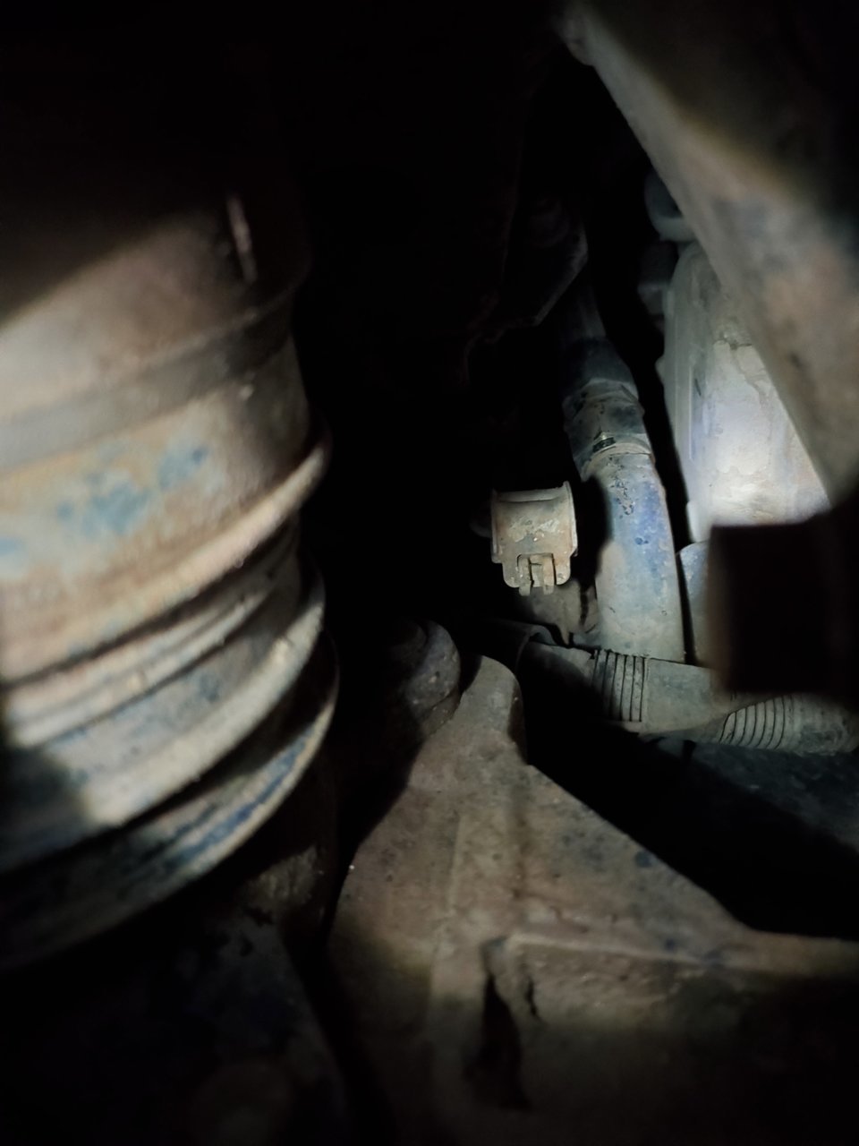

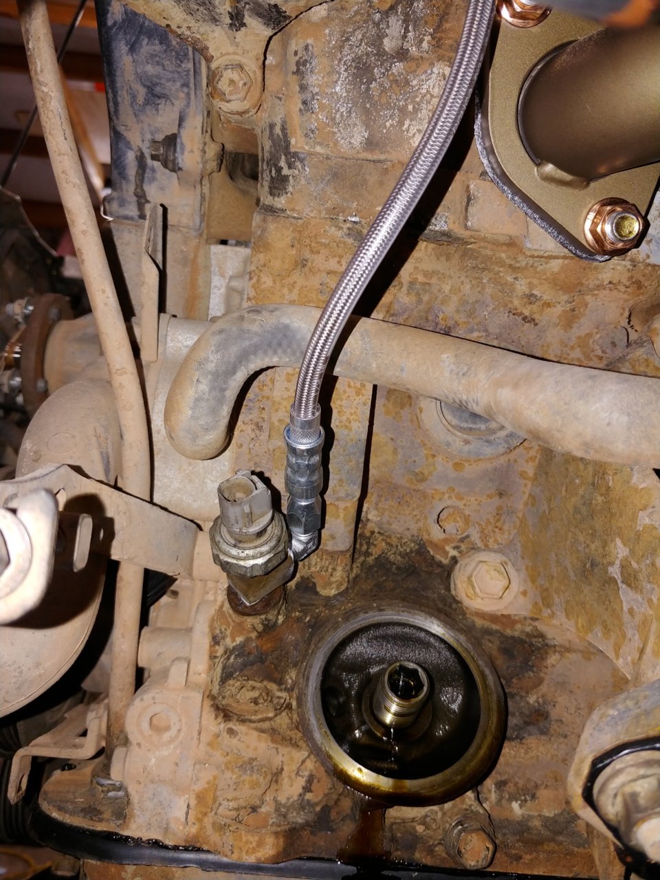

    I found myself needing to know where the oil return line bung needs to be welded on the 5vz oil pan sooner that expected. Can someone hook me up with some pictures and or measurements? I've got my CV's out, now onto removing the dif
    Torspd likes this.
  20. Apr 14, 2023 at 5:41 PM
    Jon64l
    Jon64l Well-Known Member
    Jan 12, 2016
    #174799
    1,634
    Jon
    2000 4runner, 1996 Tacoma
    Hard to tell, but mine is behind the Ac compressor. Used a 1" 90 degree bend and welded to pan then welded -10 on top. The hose connects above oil level this way, so turbo/line can be removed without leaking. Had to cut a cresent wrench handle down to be able to fit in there.
    unstpible likes this.
