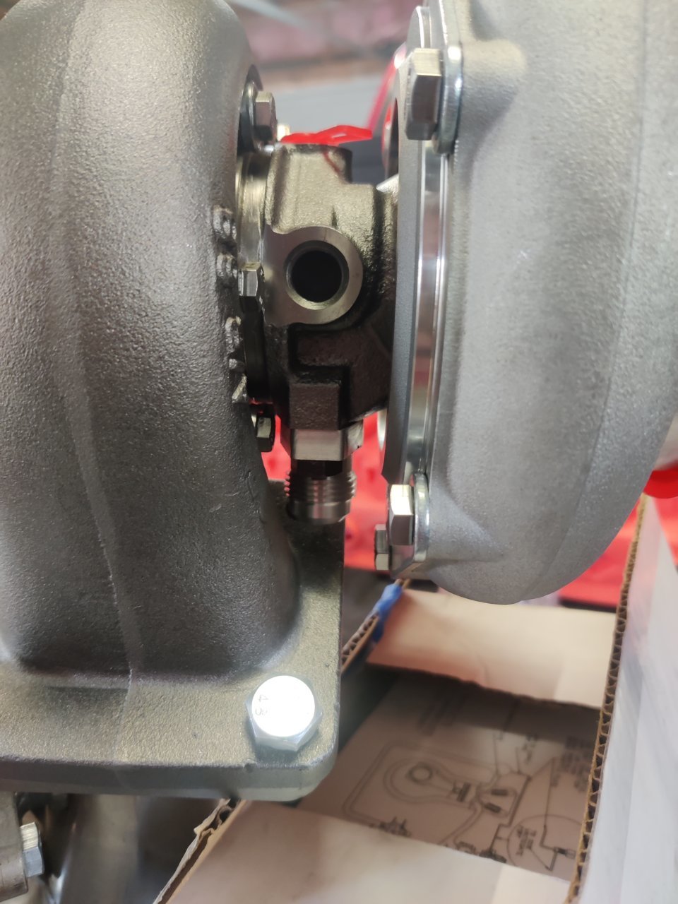

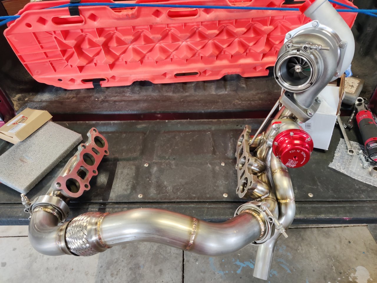

    CX used flat flanges on everything and i figured a flat flange would mate up better to the turbo down pipe since it's flat. I was just going to use the female side but thought if they machined the male end flat it would give it a bigger surface area for the seal

    Same shit is same, both styles leak anyway..

    I understand M/F is a superior flange but I'm not a welder and don't really want to cut all the fittings of and redo them.

    I found a shop who will Cerakote the manifolds, will take them in tomorrow for all the details but I'm glad to have found a local shop.
    Now I just need to pick a color

    You should test fit everything first.

    Male/female seals better. All flanges leak if they are warped. The techniques prevent that.
    Agreed^^^ Definitely test fit first.

    CX Racing Turbo kit. TransGo shift kit. All Pro Apex bumper and skids. Smittybilt XRC 9.5 winch. All Pro Upper control arm's. Bilstein 6112's with 600lb coils. Eimkeith's lower control arm reinforcement plates. Perry Parts bump stops. All Pro spindle gussets and alignment cam tabs. All Pro standard 3" leaf springs. Bilstein 5125's rear. Extended rear brake lines. Rear diff breather relocation. MagnaFlow catback with resonator. Bluetooth stereo. Memphis 6x9 door speakers. Diode Dynamics SS3 Pro Amber fog lights. Single piece headlights. aftermarket grille. Anzo taillights. LED 3rd brake light. 4runner sunglass holder and dome lights. Master Tailgaters rear view mirror with 3 directional cameras, G shock sensors, and anti theft system. Honda windshield washer nozzles. Stubby antenna. Scan Guage II. 2nd Gen Snowflake wheels powder coated black. Cooper Discoverer ST Maxx 235-75/16 Denso 210-0461 105 amp alternator. Speedytech7's big wire harness upgrade. Aeromotive 340 fuel pump. Haltech Elite 2500. Tacomaworld sticker. Tundra brakes with Adventure Taco's hardline kit
    It all felt good to me:notsure:.
    The flat Vband flanges can be a pain to keep squared I see how the M/F flanges would come in handy.
    The oil drain being at the 6 o'clock position Will be a tight squeeze
    it might be better fitted on the other side of the T4 flange at say the 5 o'clock position.
    I'd like to order two high quality 2.75" Vband clamps for the crossover pipe. For now I just have better nuts on the clamps that came with the CX kit.
    Turns out the 3" male flange I had converted into a flat flange isn't a good fit. the outer diameter of the flange was greater than that of the turbo's flange so I'll take the Evil Energy one I have on hand (that matches the diameter of the turbo flange correctly) to the machine shop to have it de flange gendered.
    The father and son that own the machine shop both drive Tacomas so that's a bonus.
