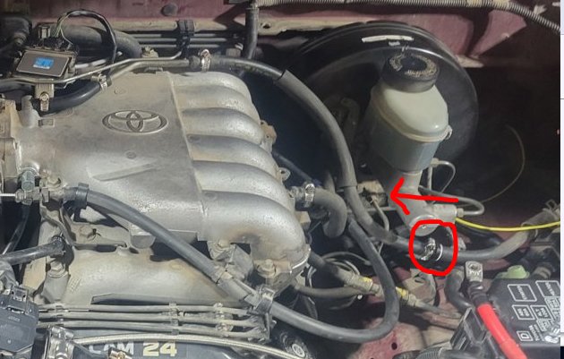

    Which one is that? I did put one in there on the line just under brake fluid res. If you zoom in you can kinda see, that the line your talking about?

    Utah
    @Speedytech7
    Air flow allowed in the direction of arrow?

    Yup that's right

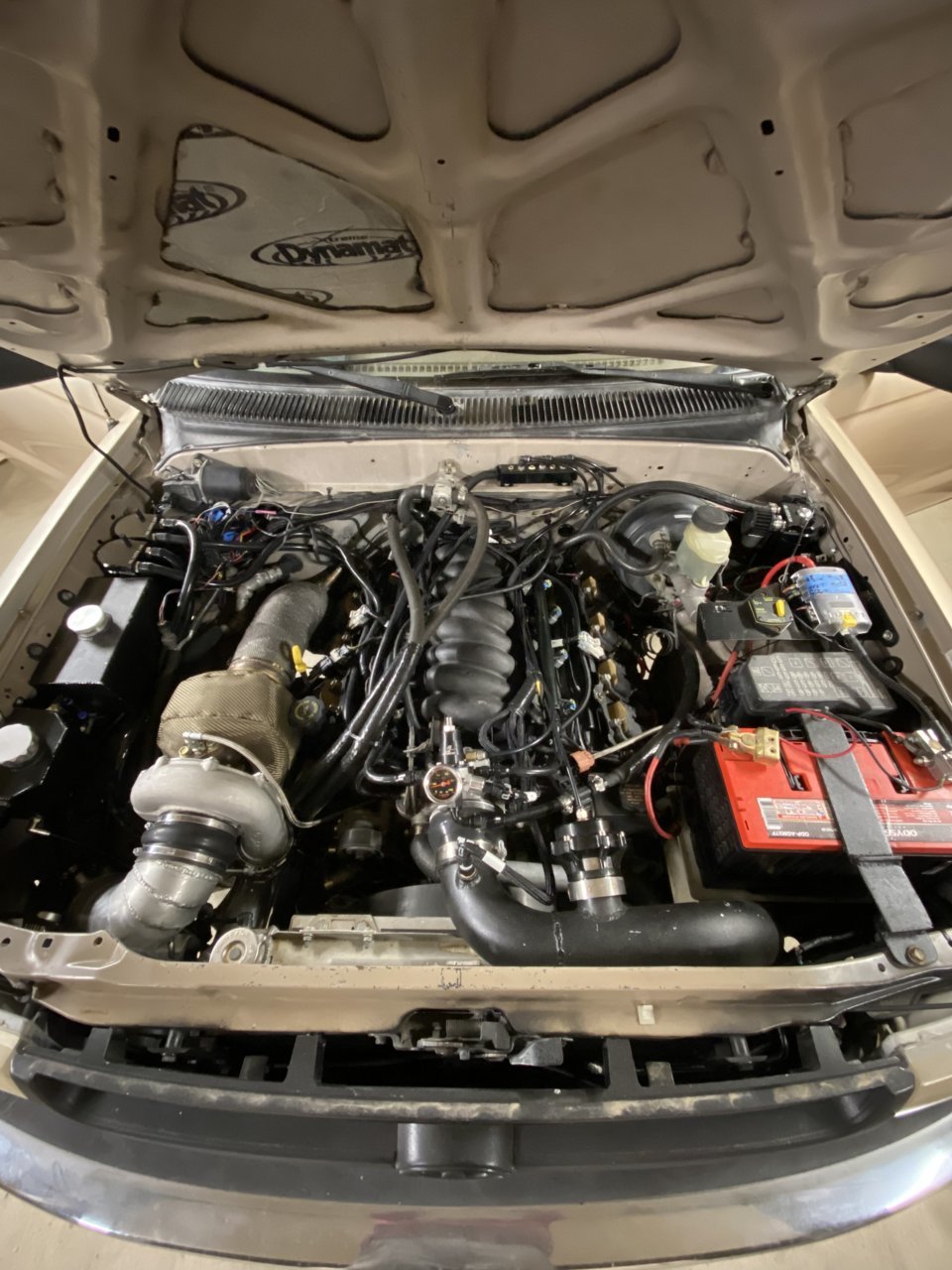

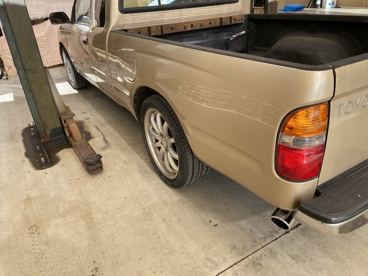

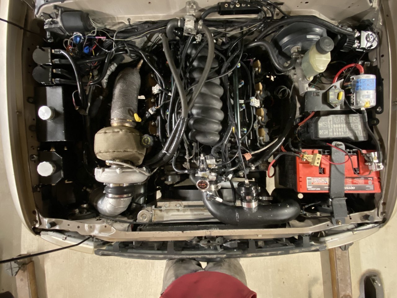

    BC559958-69D3-495E-9BAF-6D355442482C.jpg I finally got the beast running at gate pressure (7psi) holy shit....an LS swapped 1st gen is a good time.
    Also changed the exhaust system from a single 4” into 3” duals plus added straight through mufflers on each side to quiet it down, looks nice since I put on TRD exhaust tips, haha.
