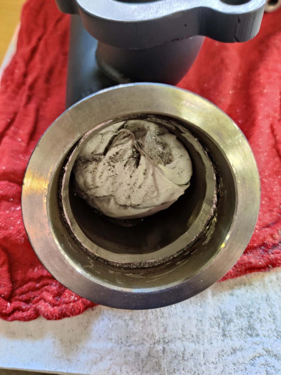

    I'm both anxious and hesitant. Ive been banking on being able to have regular drivability at low boost without messing with the ECU side of things until I can collect the dough and knowledge to go full haltech.
    I also really want to get this turbo on because driving around with a leaky manifold is chugging gas so fast I don't dare travel more than 60 miles from home.
    I did get the inside of the pipes clean up with a dremel so that's technically a little bit of progress/procrastination progresstination
    Also managed to scratch the Cerakote a little bit so I have an extra excuse to heat wrap them.

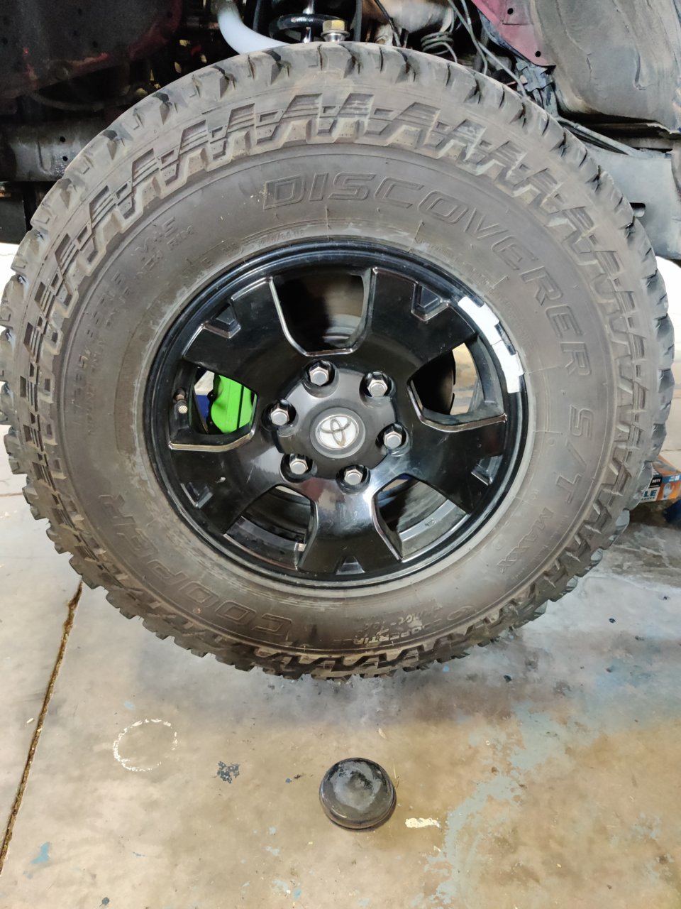

    I attempted to replace the inner CV axle seals because it's been leaking since I got the Diff back in but realized I only had the dust seals for the spindle side of things. Luckily I noticed right before pulling the CV out. I did go ahead and put the new dust seal on the drivers spindle and installed new OEM bolts on the LBJ while I was there.
    I put fresh lock tight on the wheel spacers and torqued them down and torqued the wheels on then looked behind me and noticed i forgot something
    I've had a serious headache all weekend and at least 5 metal slivers from going out to the garage in bare feet after making a mess with the dremel
