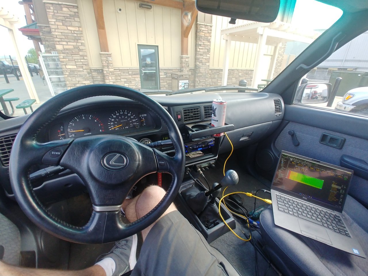

    It got kinda late so I'll have to give the flybys tomorrow or Friday. But did a solid 3.5hrs of street tuning. Played with the boost control until we were at 5.5psi and stopped there for the evening.
    Good to be outta the shop
