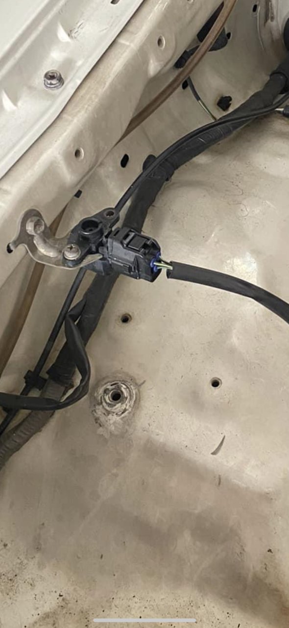

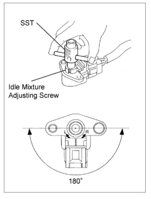

    Saw this on FBook, so has to be true. Don’t think these made it stateside as this was on a Hilux 3rz. Allows for adjustment of idle fueling. I didn’t see it on my made in Commiefornia 1999 model. Said to be coming out of the same wiring loom as MAF. Unless they have a different ECU but I assUme that during closed loop idle it would compensate. Although I had an injector isolator unseat and at idle I’d get a lean code. Clear it while moving it it’d never come back. Idle a minute or two and it’d pop back up.

    There is an unused plug that branches off of the MAF wire loom that I've seen. I wonder if that's what that goes to....

    US spec computers have no inputs or outputs marked for baro or MAP sensors. Technically there is a MAP sensor fed to the ECU but it's for sensing fuel tank pressure

    Who's to say that idle fueling device in question is a map sensor. Could just be a simple potentiometer to adjust

    Could be, the old trucks with VAF sensors had idle mixture screws since the column of air at idle isn't enough to move the VAF. Can't imagine why a MAP or MAF system would ever need manual adjustment though they're plenty sensitive to trim themselves. A lot of the Australian and third world country Toyotas came with computers incapable of closed loop fueling early on though, could be one of those.

    I would imagine that adjuster could be a product of some region specific emissions regulations too

    I think that plug has something to do with keeping a clean signal from the MAF to ecu.

    Did a little digging. Looking like it’s a barometric pressure sensor.
    Adjustable sensor it’s looking like.

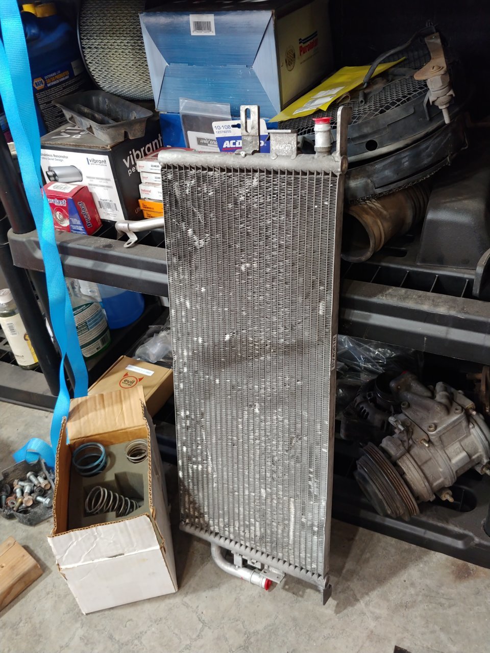

    Yeah I definitely notice a difference in power between a cold engine bay and a heat soaked one so I'd imagine it stays somewhere on the colder side with the water to air all plumbed up. Haltech tunes for the air temp change nicely at least. Finding a cooler that fits behind my grille is proving to be a nightmare. I thought I had a winner but it was 2" too wide... So thats just sitter here being clutter now.
