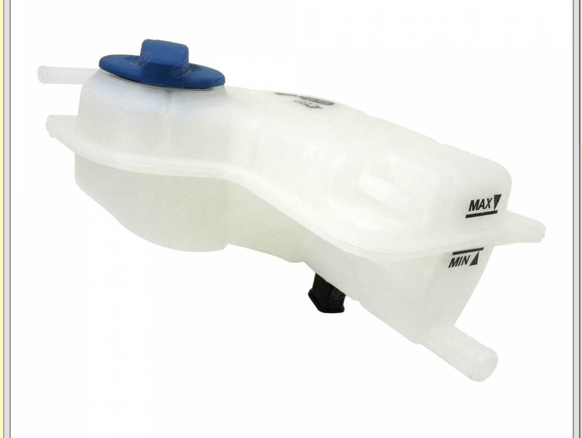

    I don’t know the fluid capacity, but for an OEMish look a coolant reservoir could be used. This is what my B6 Audi has. It mounts just below hood level and curved slightly. Maybe even rig the sensor up to trip a low light alarm. Or custom build a box out of an ‘old’ street sign.
