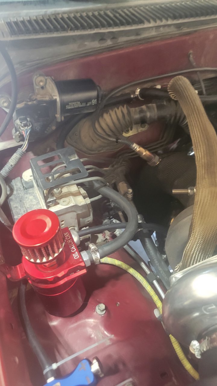

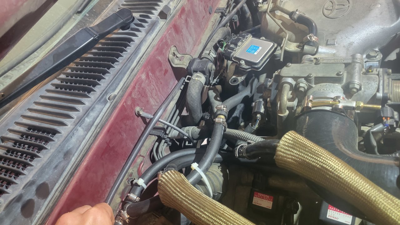

  18. Jun 5, 2023 at 11:02 AM
    GoJo
    GoJo Well-Known Member
    Mar 6, 2014
    #124740
    546
    Utah

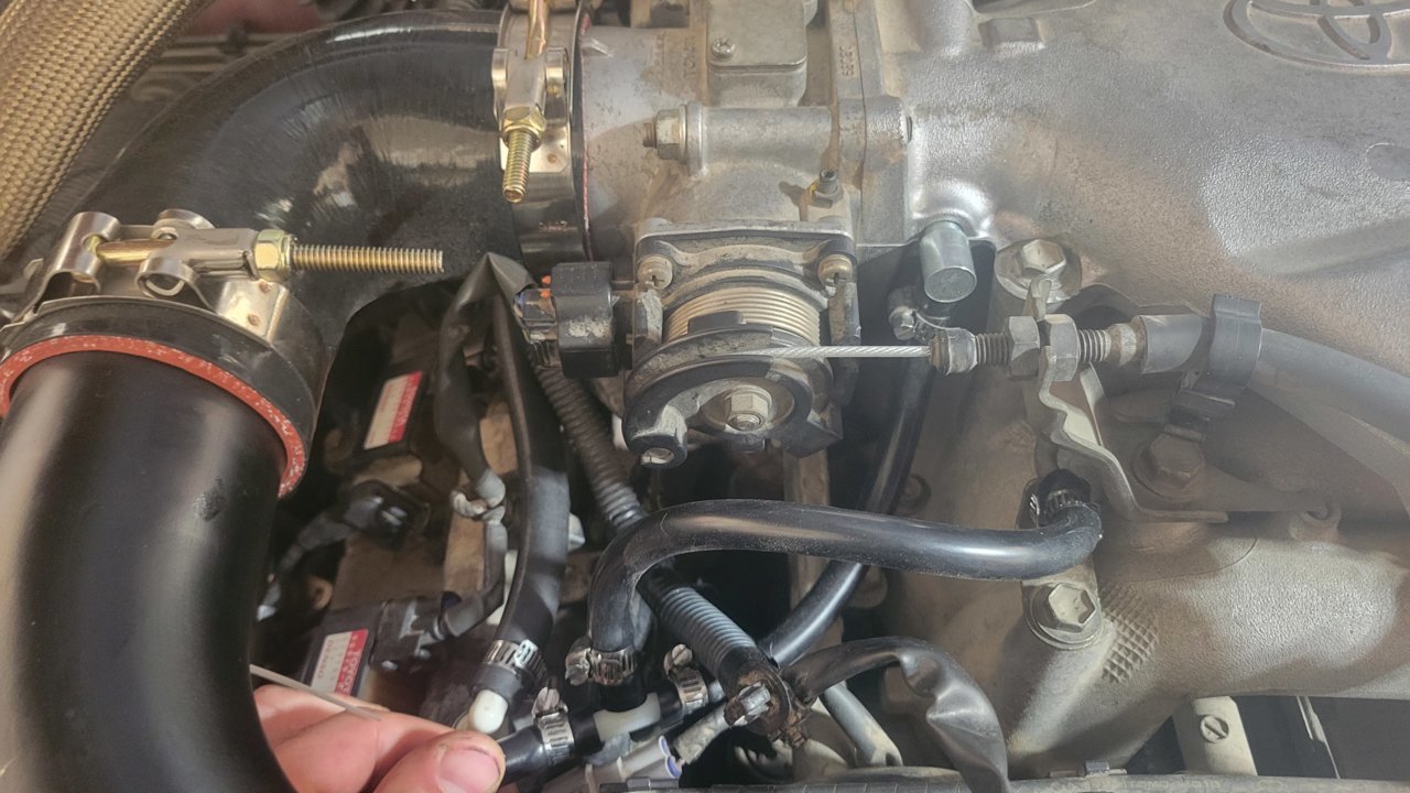

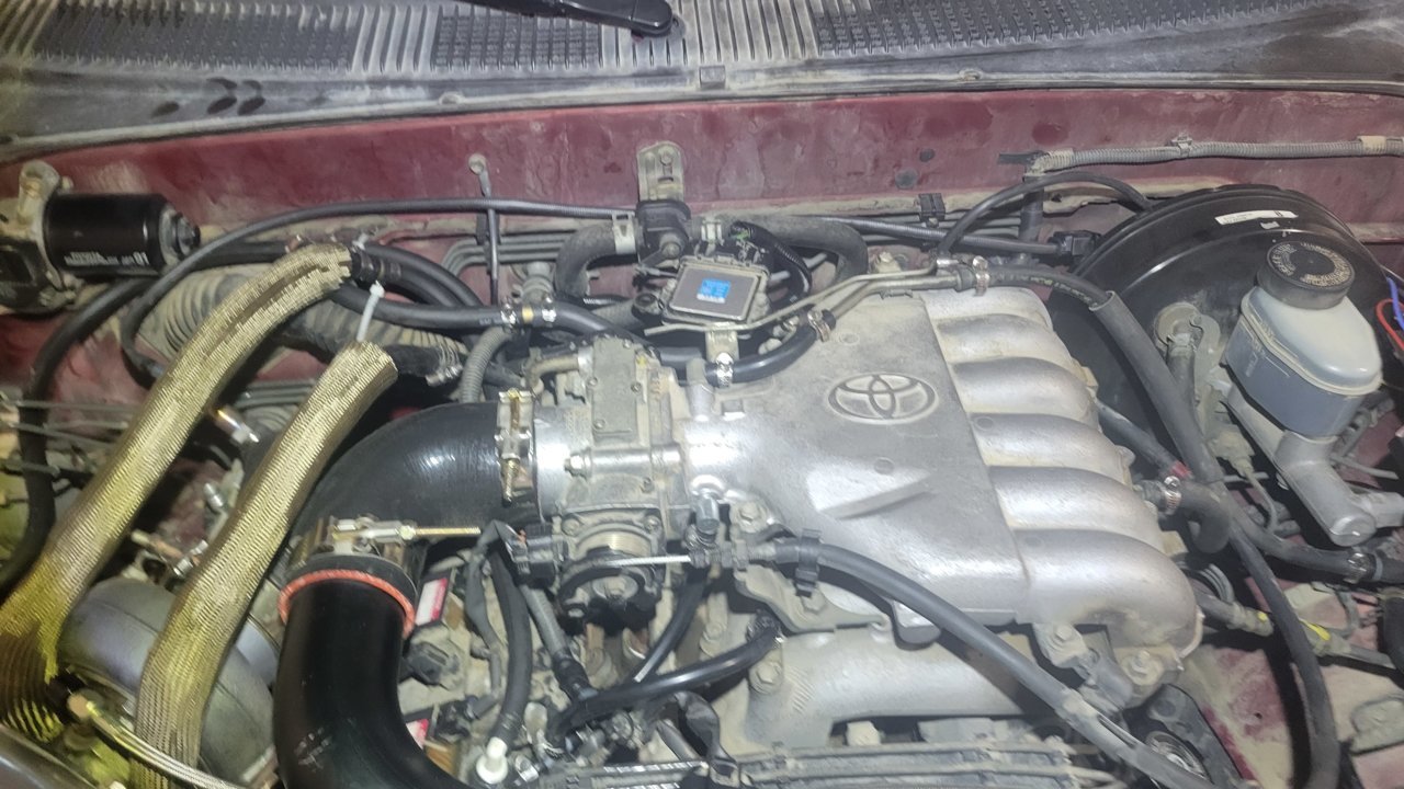

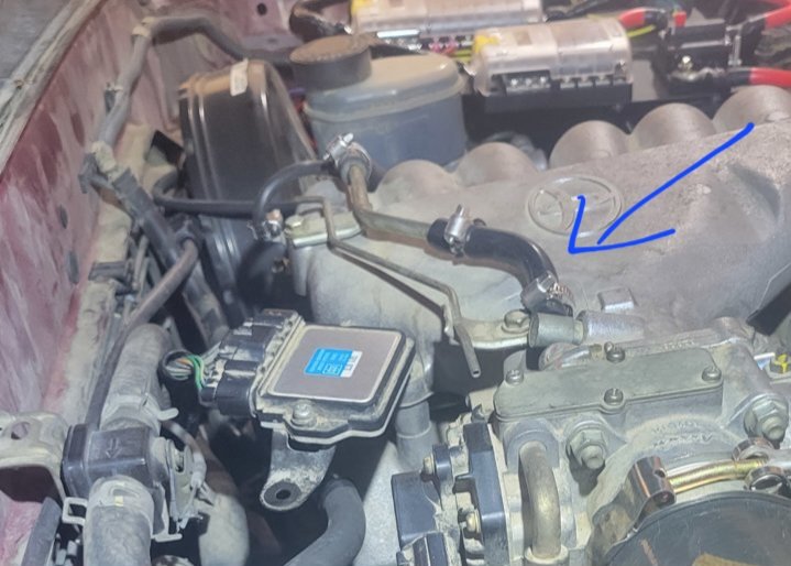

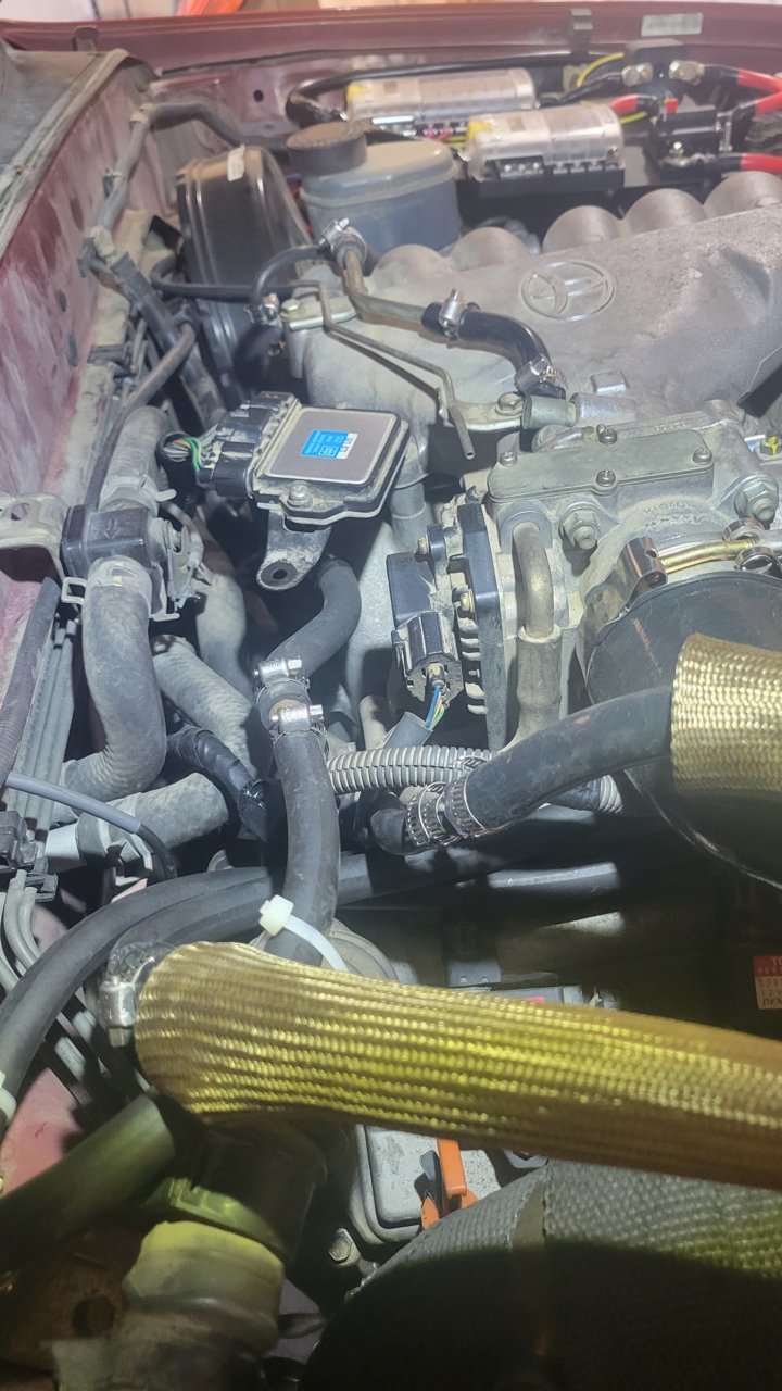

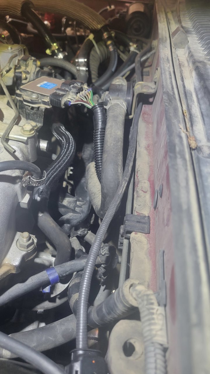

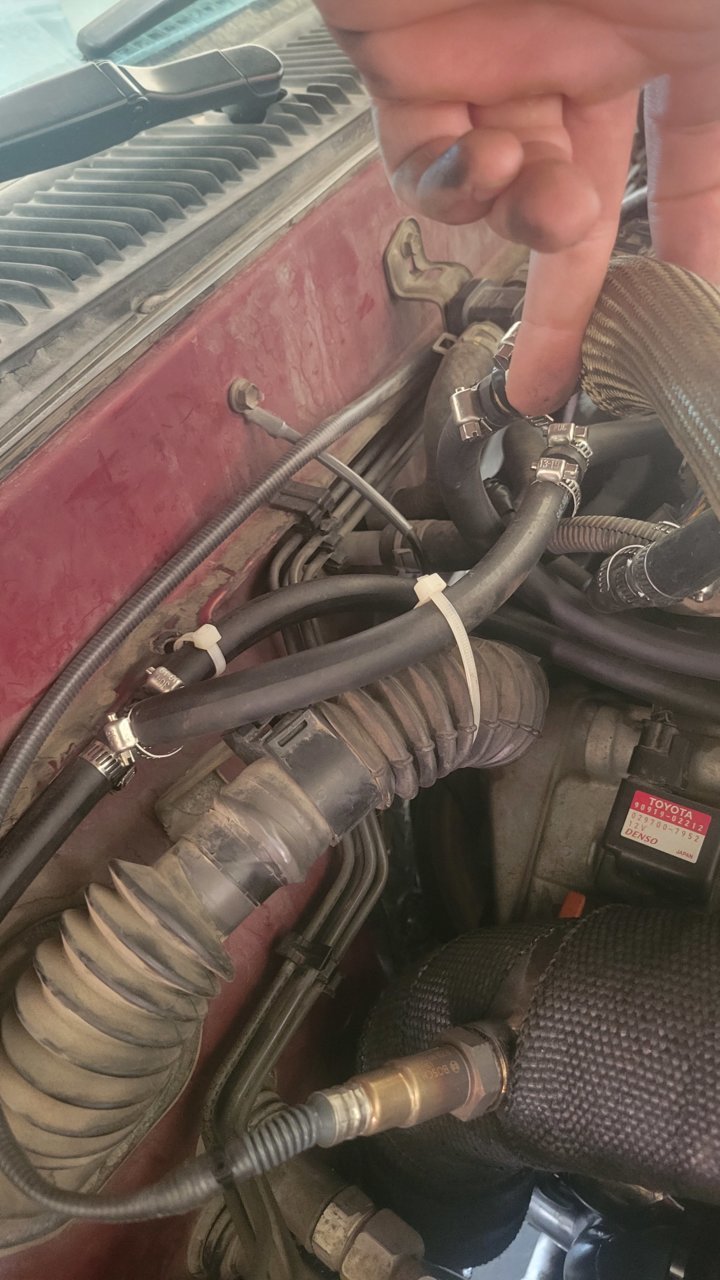

    FPR T'd with BOV into original PCV port
    Heat wraped lines are coolant. My hand is holding the T for the PCV and rear vent that then goes to catch can image further below
    Lumed one under ignitor is the rear vent, clamped one on top the manifold is my boost reference to gauge in side:
    Opposite side shot of the rear vent under ignitor
    PCV/Vent T
    Catch
    unstpible likes this.
  19. Jun 5, 2023 at 1:53 PM
    Torspd
    Torspd Tor-nication
    Sep 18, 2009
    #22958
    26,425
    Tor
    The Great America!
    MMVI 4.4L 4x4 Access Cab
    Torspd Custom Turbo kit [] Borg Warner 9180EFR Turbo [] Haltech Elite 2500 [] TiAL Q BOV [] TiAL V44 Wastegate @ 15psi [] CP Pistons [] CP Carrillo Rods [] ARP Head studs [] ARP Main Studs [] ARP Header - Head Studs [] Ported Heads w/ 1mm oversized valves intake/exhaust [] Brian Crower Forged Stroker Crank [] Darton M.I.D. Sleeved Block [] Kelford Camshafts [] Torspd 160* T-stat mod [] APR Large Fuel Rail [] Walbro 460 LPH E85 Fuel Pump [] FueLab FPR [] APR T56 Conversion Kit [] KP RACING Built T56 [] McLeod Racing Custom Twin Disk Clutch [] One Piece Aluminum Driveshaft [] MGW Shifter [] Custom lowering kit [] Ohlins Front Coilovers [] QA1rear shocks [] Custom Ron Davis Radiator [] Dual SPAL Electric Fans []
    Where does this go?
  20. Jun 5, 2023 at 1:56 PM
    Torspd
    Torspd Tor-nication
    Sep 18, 2009
    #22958
    26,425
    Tor
    The Great America!
    I only see one line going to the catch can, so that must be what the Tee is for in the earlier photo. That Tee, would perform much better being a Y. If you can get your hands on one.
    Basically, I am trying to figure out and make sure that you have no vacuum hoses connecting the intake manifold to the valve cover. If you do, that will create a lot of problems from being able to pressurize the crank case.
