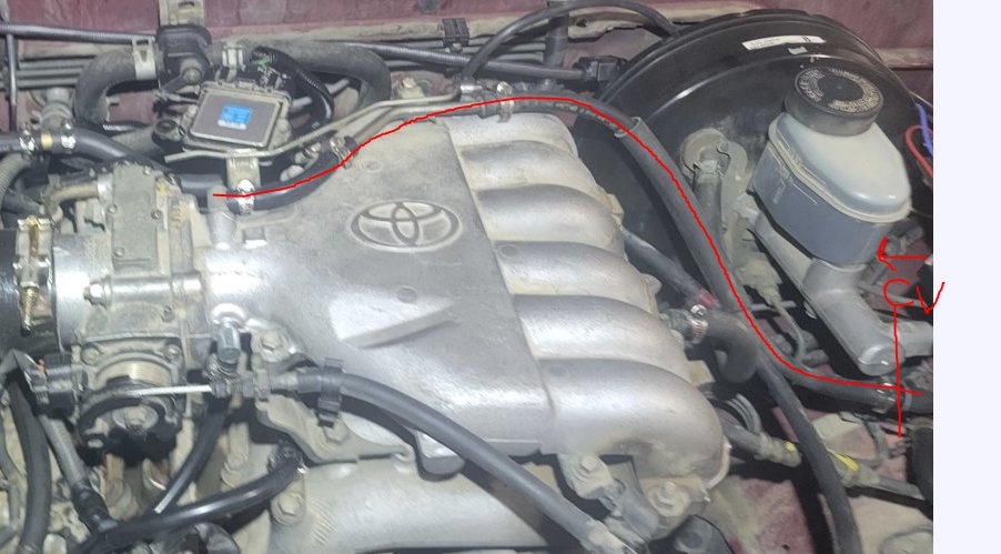

    That routes across over to the EVAP stuff. I believe its the EVAP purge line back to the gas tank, and I put in a check valve at the cross in the below, with air flow allowed <<<
    Thinking more on it, am I possibly introducing PSI into the crank with how I have the PCV and Vent T'd together?

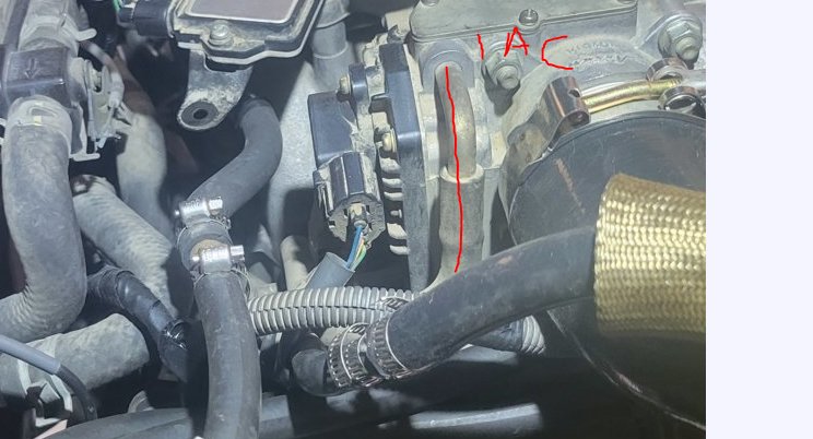

    Also, is the IAC vacuum tube ok to see boost? It routes back down to the top of the engine.

    Yea I tried to find a Y but no luck yet.

    Everything looks fine. Like Tor said, try to get a Y for better flow.
    GoJo likes this.

    Iac line can have a check valve. Mine does left over from SC days. Either way it won't pressurize case. Just re seal the pan probably. You might try to up the line size after the Y (T) so it has enough flow to support both the incoming lines. I had to weld up my own Y.

    It's less Tacoma and more mod
    It's fine to be tee'd in with other things, maybe not too many other things though

    Dedicated is perfered.

    Yea, I still have some of that 5/8 tubing left over from the oil drain fiasco that I was thinking to rig something up. Good to hear on the IAC, ill leave it as is for now. I still need to go test drive it today and see if tightening up made any difference, but re sealing is on the list here soon again.

    There is actually a port super low down on the runners just for it I think

    I think that port is gone on the later model Speedy. He could drill and tap the manifold to 1/8npt and put a barb fitting in if needed.
    Honestly it's probably still in closed loop. I think the vac line is negligible as is, but dedicated definitely won't hurt.
