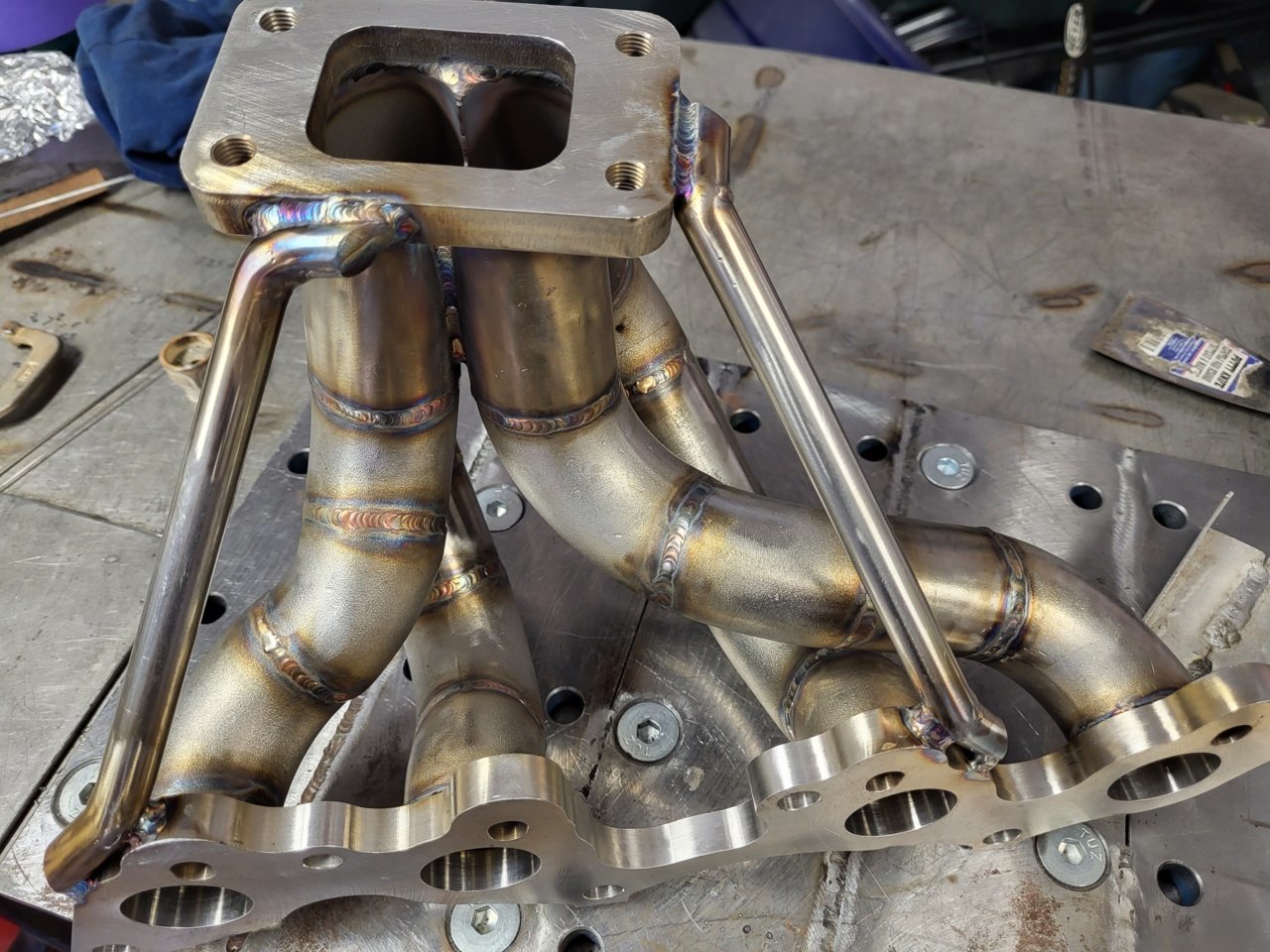

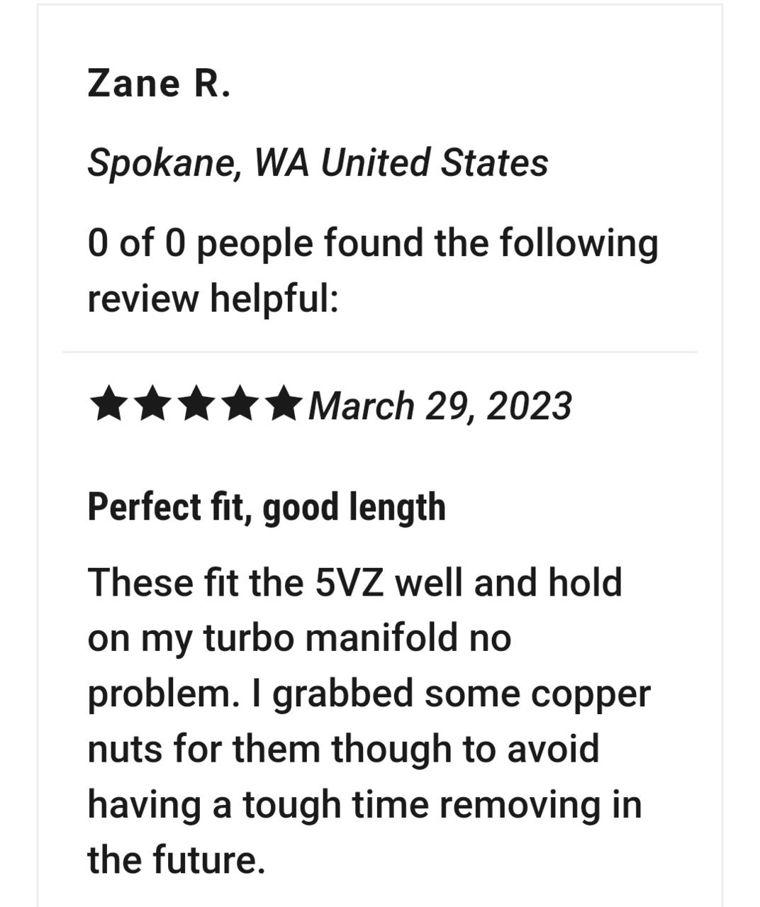

    I keep forgetting to order new exhaust manifold studs. I've been planning on getting the ARP set. Can someone confirm the size (or PN) for the 5vz
    10mm with a 1.25 thread?
    LCE has a set of 12 studs at $27+shipping for the 5vz seems more than reasonable.
    (im inclined to believe @Speedytech7 has a review on LCE's page for the studs.
    ARP Chromoly studs through summit for about $65
    ARP Stainless steel through summit are about $145.
    If memory serves me right stainless steel and aluminum like to fuze making anti-seize
    Absolutely necessary
