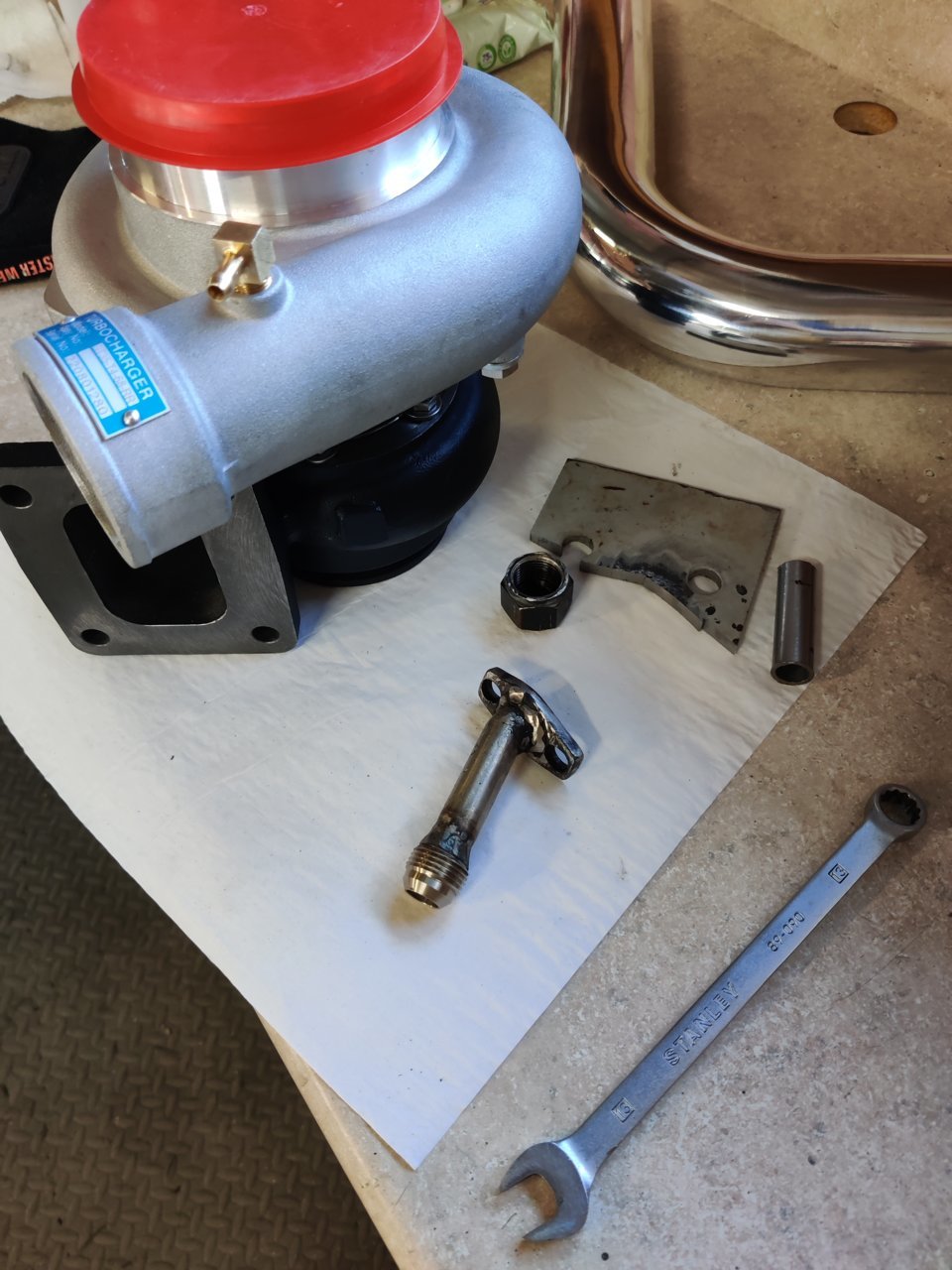

    Made my own ugly butt effective oil drain fitting :welder: IMG_20230702_184347.jpg

    Bro, it's on the bottom side of the turbo and it's going to be covered by a hose... I literally went to Lowes and got threaded metal pipe fittings with hose barb ends and screwed it into mine and welded the other on the timing chain window for the return... If it's stupid, but it works, it ain't stupid haha

    Looks good to me, mine is just an aluminum dealio with a brass AN conversion fitting jammed in. Whatever gets the job done.

    Looks good. Hit it with some paint or wrinkle powder coat and call it done. Keep up that good progress!
    Be sure to delete that tag on the compressor outlet. Boost leak waiting to happen.

    That's a really dumb place for that isn't it? Usually they put em on a flat spot on the compressor housing.

    Prevents over boost :thumbsup:

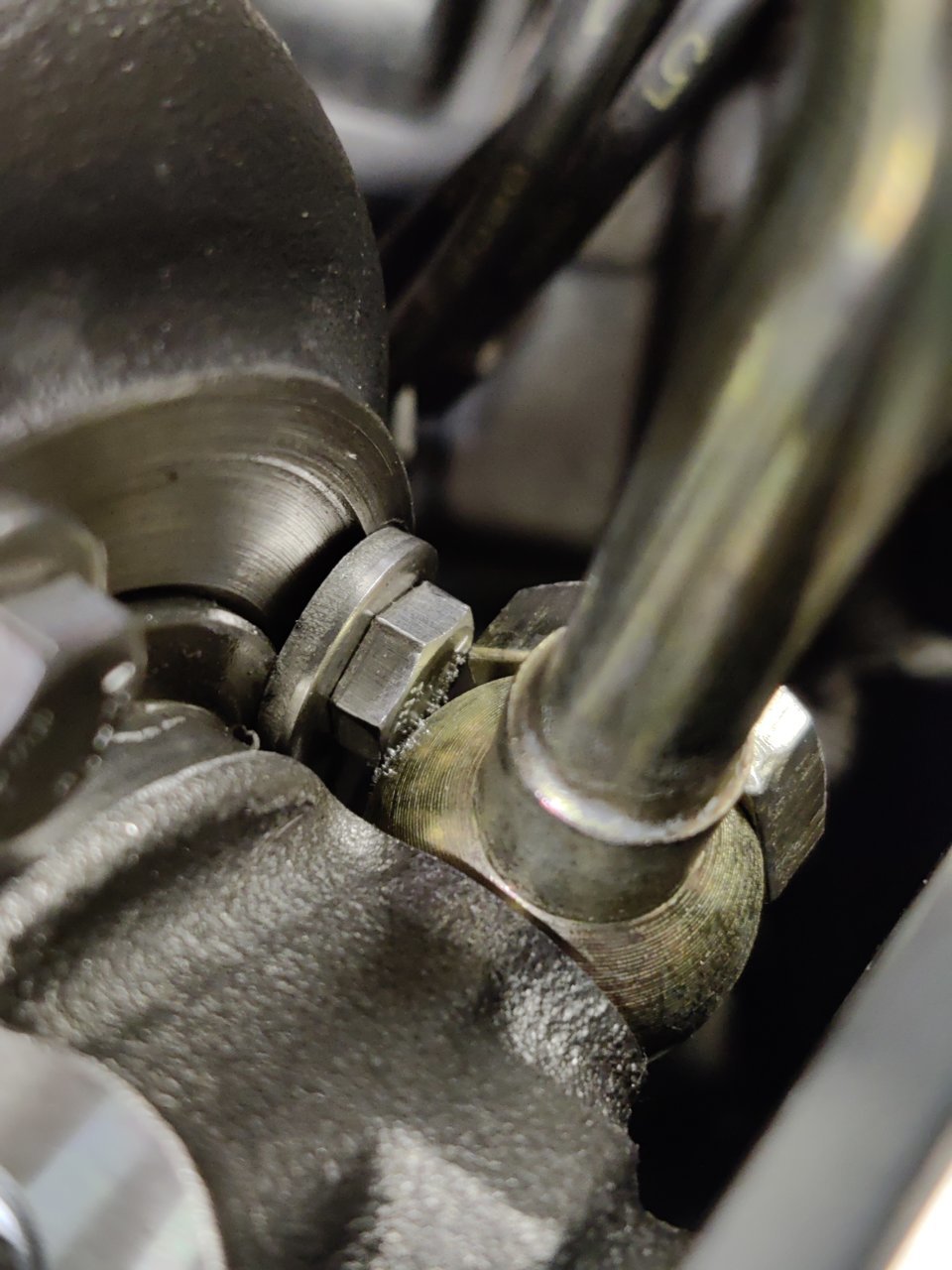

    I'm glad you mentioned that tag. I thought it seemed like odd placement. Apparently it's just standard operating procedure for CX to put things where they are an inconvenience.

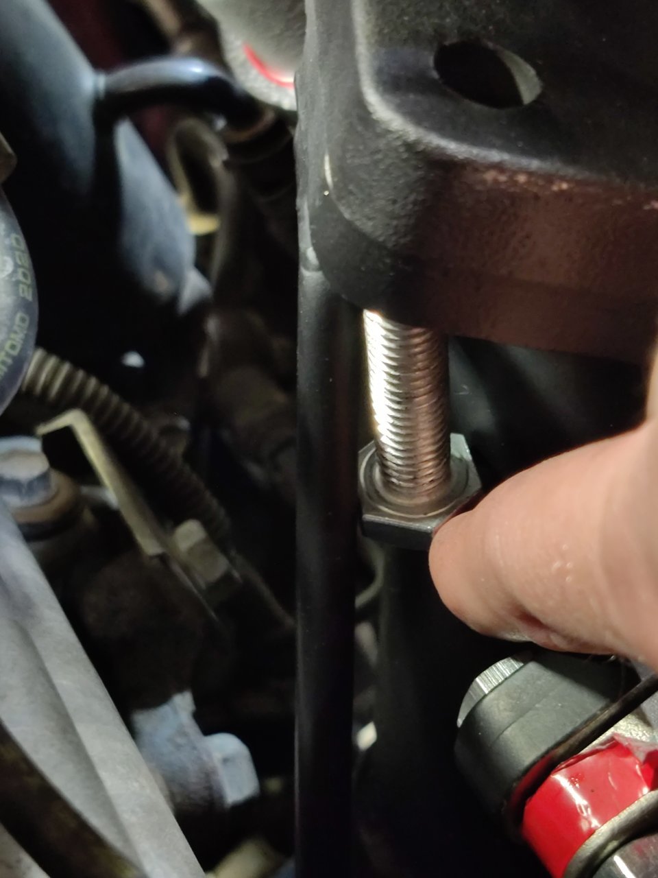

    The support rod coming up from the manifold to the T4 flange is right in the way for the mounting hardware and it won't go in the other direction either because the V band flange for the down pipe.

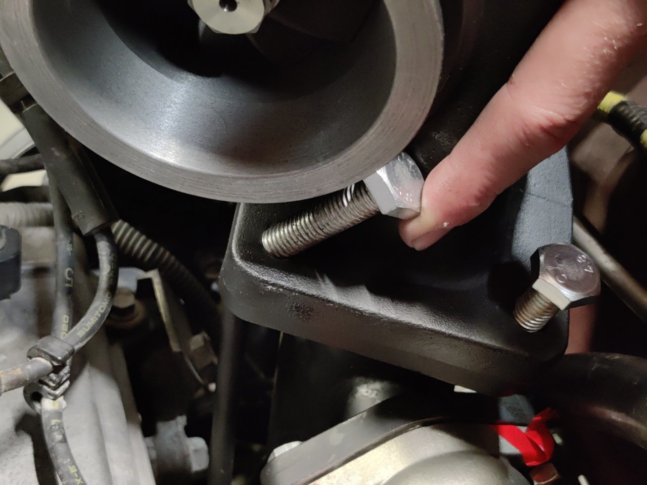

    Both of the banjo fittings for the coolant lines also hit the hardware for clocking the hot side when it's in the correct position
    (I noticed this a while back and may have already mentioned it)
    Little inconvenience add up but it's still been a fun project.

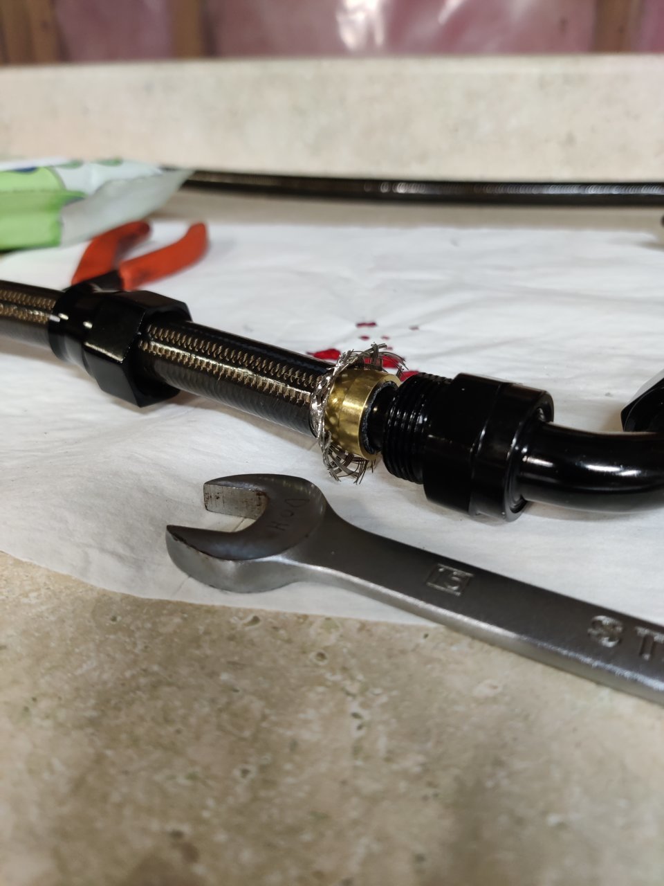

    I'll also mention I am not a fan of building my own braided lines. The very last fitting I put together for oil drain got me pretty good. Great opportunity to test my blood sugar levels if I were diabetic.
    I really hope they all seal correctly so I don't have to try my hands at it again in the near future.

    You could switch to studs for turbo mounting hardware. They are stronger anyway.
    Yeah clocking can be fun with fittings. Just gotta figure out which side of the bolt you want to be on. Looks like you could grind the bolt. Do those Banjos have crush washers? They should to help seal.
    Braided lines are fun, that one is different from what I normally have used (Earls). One trick that has worked for me is tightly wrap electrical tape 2 times around your cut line. Have everything set up then cut in the middle of tape with a angle grinder cut off wheel. Quickly blow out the line with air and assemble.

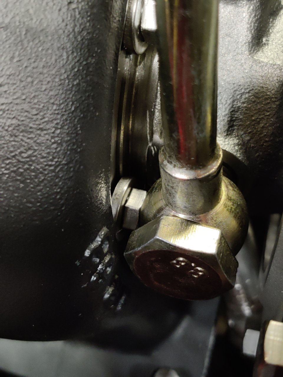

    I just knew you were going to notice the crush washers. I have them sitting with the other hardware and gaskets so I don't have to worry about damaging or loosing them while things are being mocked up.
    Good call with the exhaust studs as well :hattip:
    I did end up using electrical tape on that fitting but after I had already cut the line and feathered the stainless steel out when I realized I forgot to slip the other end of the fitting onto the hose after cutting it.

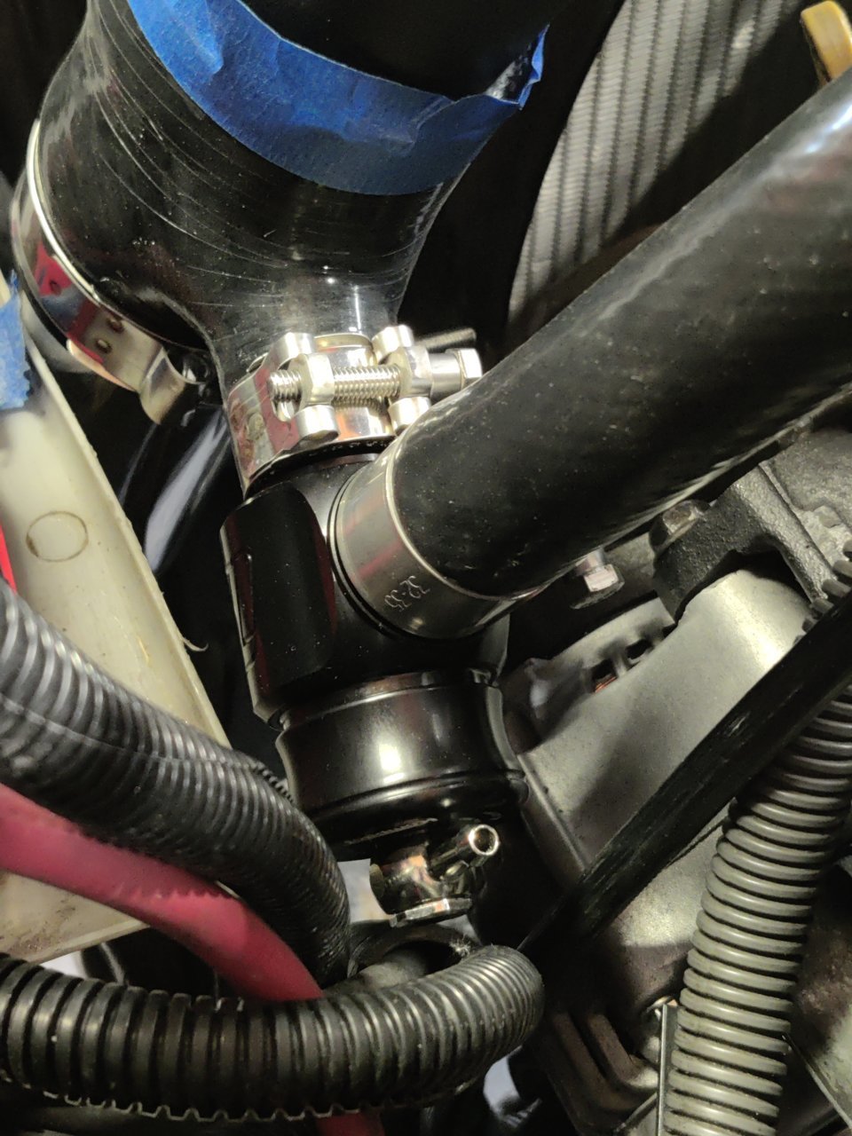

    Here's the BOV
    IMG_20230703_110808.jpg don't mind the tape it's just so I remember I need a Clamp that fits

    Good pics, that helps.
    Top of Bov goes to a port behind throttle plate. So when throttle is open and you are in boost, pressure will push on top of Bov diaphragm holding the valve closed. When throttle closes there will be vacuum in the plenum pulling the valve open to release the extra pressure in pipe.
    Vsv, that one went to the filter box originally.
    unstpible likes this.

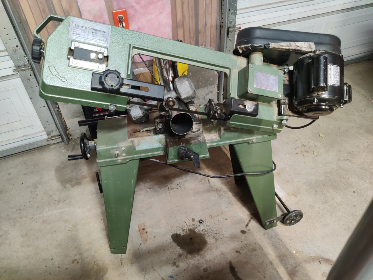

    This saw should make the exhaust pipe cuts much cleaner than the hand held dinky thing I use for the aluminum charge pipes but it's been sitting in a shipping container for a long time so it needed a little TLC.
