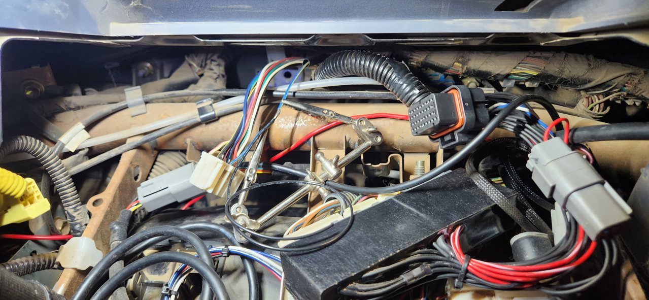

    Removing the airbag helps a ton. The wires between my adapter and HT plug are pretty short so I'm limited to where I could put it. No way could I fit the adapter and HT all in the OEM space. Having it up above the glovebox is also really nice for making any wiring changes.

    Your adapter is unique, the first I've seen from SNP that isn't a Boomslang (or at least doesn't look like their work in the slightest)

    yea I think they might actually make these ones in house for whatever reason. All the other ones have green wires which seem to be the norm for the boomslang harnesses.
    Do you have much longer leads between the adapter and HT plug on yours?

    yeah mine are about 10" long... and I purchased it direct from boomslang, but the build style, parts, and labeling are identical to Mike's which came from SNP.

    Hmm ya that length would make things a lot easier for me.
    You would think that the people that put together these kits would take that into consideration when selling a kit. It's one of those things that nobody talks about and was pretty annoying to find a solution for when you anticipated it just being a plug 'n play. The ECU location doesn't change on these trucks so wouldn't be too much work to determine what length wires are needed to be able to mount the ECU in the factory location or somewhere that makes sense. Then maybe even include a small adapter bracket or something to do what you did with the OEM ECU tray.

    Honestly you're right it would be super easy to 3d scan and then remove some of the fat to print a bracket to do what I did. The lengths are annoying even on mine but I don't have an airbag to contend with.

    Did you also remove the passenger airbag?

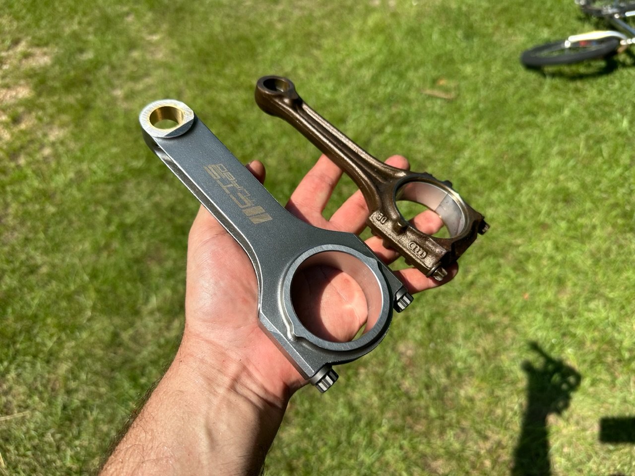

    Aiming for 400 at flywheel but rods good for 1.5-2x that. Audi/VW 1.8t.

    I was gonna say, those rods should handle a hell of a lot more than that

    Those rods look like they'll handle more than the block. Lol

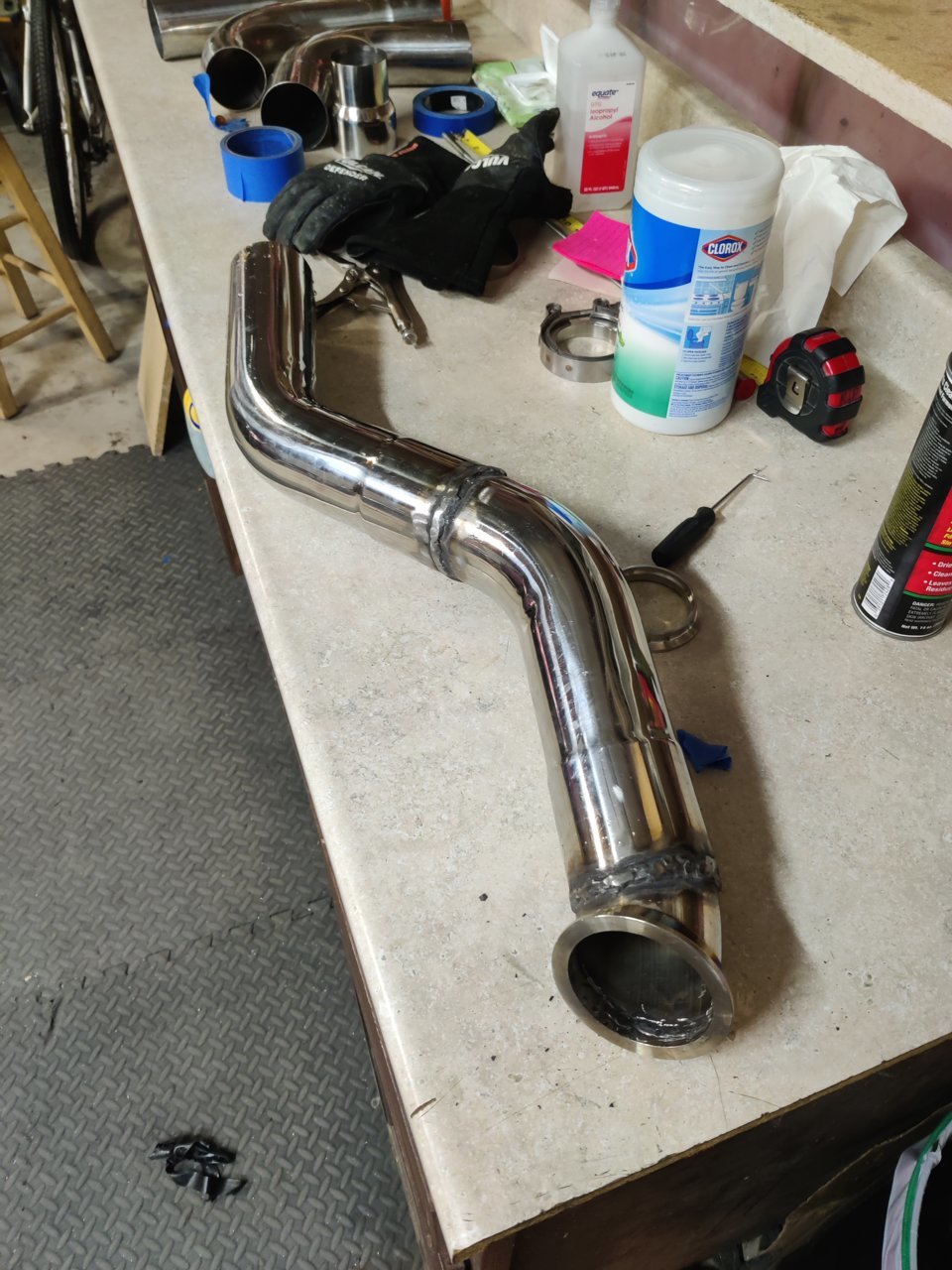

    I think the welds were a little too hot but if I turned the wire speed or temperature down it wasn't happy at all.
    I still need to add the O² bungs and figured out how I'll connect it to the catalytic converter but today me and the misses woke up feeling pretty sick so it might have to wait
  20. Jul 7, 2023 at 2:33 PM
    unstpible
    unstpible Well-Known Member
    Aug 16, 2012
    #84909
    3,894
    Derek
    Cedar City, Utah
    03 4x4 boosted V6 Auto 341k miles
    CX Racing Turbo kit. TransGo shift kit. All Pro Apex bumper and skids. Smittybilt XRC 9.5 winch. All Pro Upper control arm's. Bilstein 6112's with 600lb coils. Eimkeith's lower control arm reinforcement plates. Perry Parts bump stops. All Pro spindle gussets and alignment cam tabs. All Pro standard 3" leaf springs. Bilstein 5125's rear. Extended rear brake lines. Rear diff breather relocation. MagnaFlow catback with resonator. Bluetooth stereo. Memphis 6x9 door speakers. Diode Dynamics SS3 Pro Amber fog lights. Single piece headlights. aftermarket grille. Anzo taillights. LED 3rd brake light. 4runner sunglass holder and dome lights. Master Tailgaters rear view mirror with 3 directional cameras, G shock sensors, and anti theft system. Honda windshield washer nozzles. Stubby antenna. Scan Guage II. 2nd Gen Snowflake wheels powder coated black. Cooper Discoverer ST Maxx 235-75/16 Denso 210-0461 105 amp alternator. Speedytech7's big wire harness upgrade. Aeromotive 340 fuel pump. Haltech Elite 2500. Tacomaworld sticker. Tundra brakes with Adventure Taco's hardline kit
    Anything I should know about mounting the O² sensors? I know they should be on the top half of the pipe to keep them dry from condensation and the guage instructions say to have the Wideband at least 24" from the Turbo I feel like I remember seeing a few of the sensors much closer to the turbo to help keep them hot enough inside the larger diameter pipes.
    I did fill the downpipe with water to check for leaks and everything stayed dry on the outside so I'm happy about that
