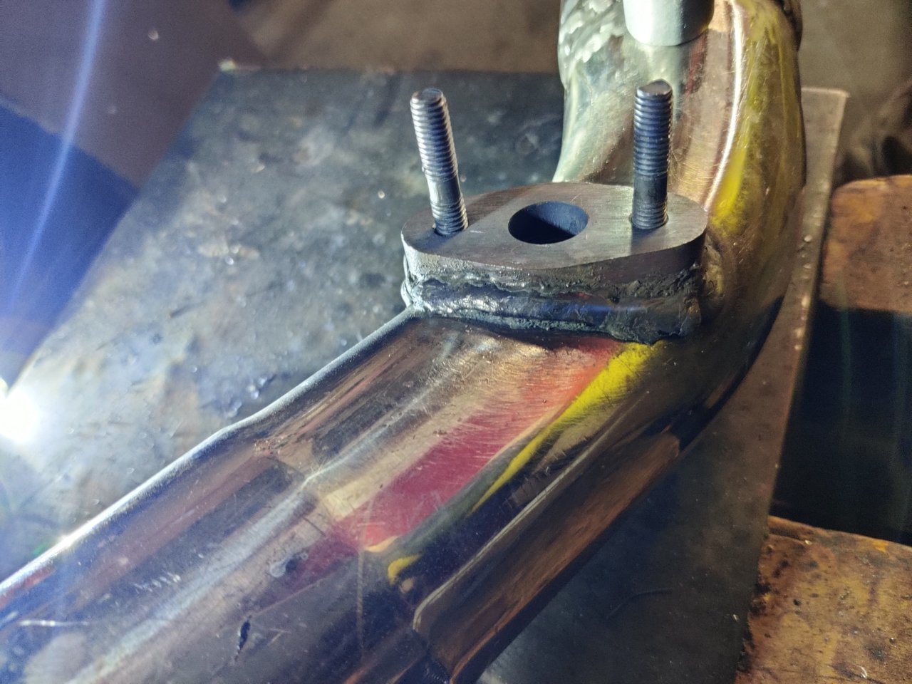

    MIG or flux cored? Where was the down-pipe material from? Stainless wire, or non?
    Those slip in sections were stretched, so being thinner that the non stretched material. That too could also make it a challenge. Depending on the machine. Just things to think about.
    Regardless, you melded them and they will do the job. What you may very well need, is to make a support bracket for the down-pipe to transmission bellhousing. Anywhere efficable. To help brace it from side to side vibrations. It will really help.

  5. Jul 7, 2023 at 8:02 PM
    unstpible
    unstpible Well-Known Member
    Aug 16, 2012
    #84909
    3,894
    Derek
    Cedar City, Utah
    03 4x4 boosted V6 Auto 341k miles
    CX Racing Turbo kit. TransGo shift kit. All Pro Apex bumper and skids. Smittybilt XRC 9.5 winch. All Pro Upper control arm's. Bilstein 6112's with 600lb coils. Eimkeith's lower control arm reinforcement plates. Perry Parts bump stops. All Pro spindle gussets and alignment cam tabs. All Pro standard 3" leaf springs. Bilstein 5125's rear. Extended rear brake lines. Rear diff breather relocation. MagnaFlow catback with resonator. Bluetooth stereo. Memphis 6x9 door speakers. Diode Dynamics SS3 Pro Amber fog lights. Single piece headlights. aftermarket grille. Anzo taillights. LED 3rd brake light. 4runner sunglass holder and dome lights. Master Tailgaters rear view mirror with 3 directional cameras, G shock sensors, and anti theft system. Honda windshield washer nozzles. Stubby antenna. Scan Guage II. 2nd Gen Snowflake wheels powder coated black. Cooper Discoverer ST Maxx 235-75/16 Denso 210-0461 105 amp alternator. Speedytech7's big wire harness upgrade. Aeromotive 340 fuel pump. Haltech Elite 2500. Tacomaworld sticker. Tundra brakes with Adventure Taco's hardline kit

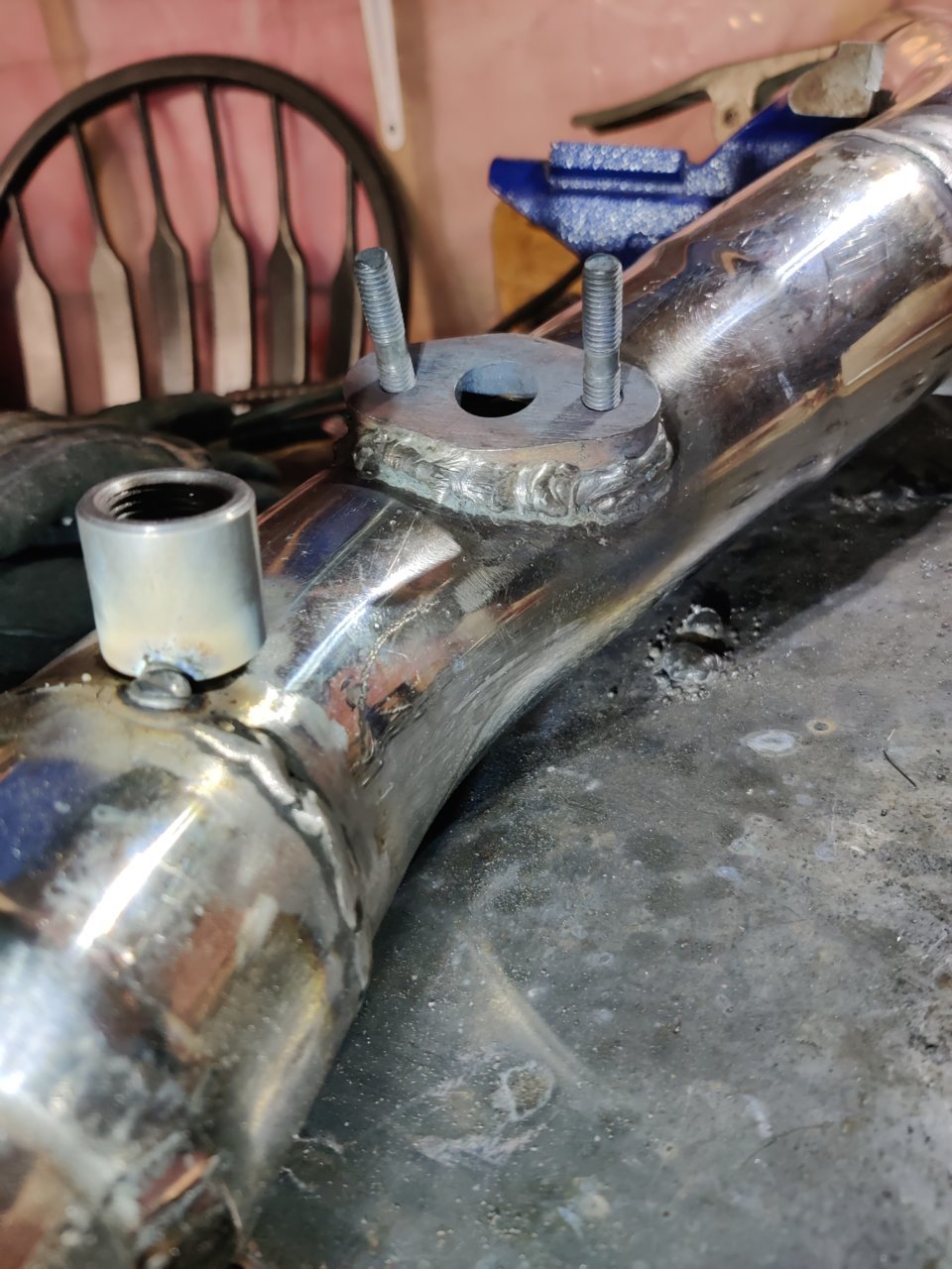

    Currently running an old 90amp Century machine we got for free. I'm using the BlackHorse Racing pipes and the .35 Blue devil SS flux core wire from Amazon.
    I was thinking about using the flange on the end of the catalytic converter closest to the down pipe as a way to add a support bracket I'll definitely look into it further now.
    I just finished welding the V bands to the catalytic converter and the end of the down pipe with a reducer.
    I'll have to do some major cleaning on the catalytic converter side, unfortunately the shop that instead the current exhaust welded everything together so I couldn't take it out to work on it and it's been a hassle welding overhead underneath the truck.
    Slowly but surely it's coming together. Still need to place the O² sensors and I also haven't ran the power supply for the Boost/AFR guage yet
    I haven't figured out how I'll supply the power yet and I'm not sure if I'll mount the guage on the A pillar like I originally planned.

    That stuff is hard to weld. Pain to get the weld started

    You're going to need more amps than that for SS
    unstpible[QUOTED] likes this.

    It's been working pretty good for me and I'm a complete novice so :notsure: maybe it's beginner luck

    How’s the penetration look like?

    I can see most of the welds poking through on the inside of the pipe.
    I probably should have been pre heating the metal too but completely spaced it.

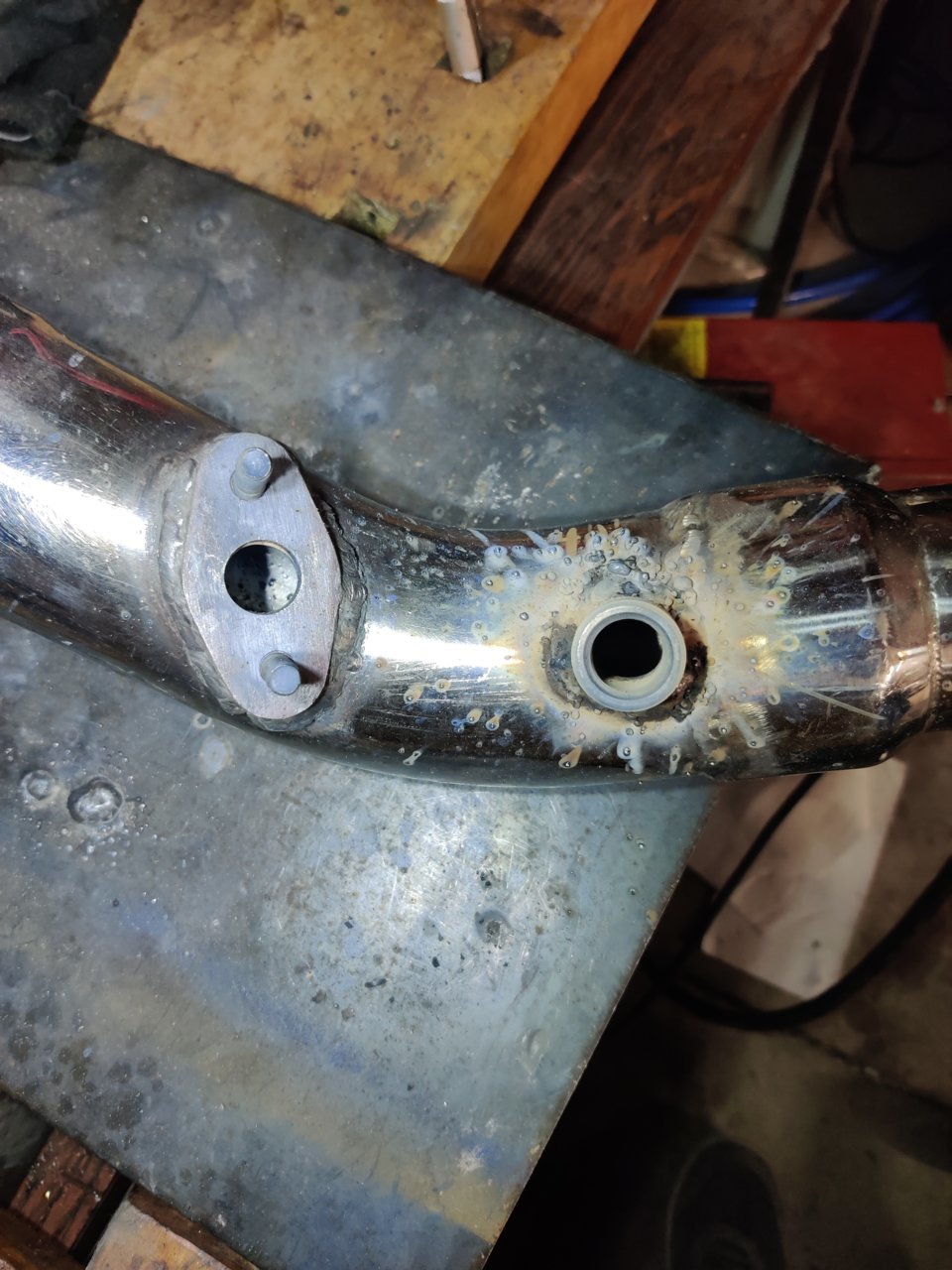

    I did however preheat last night while burning in the O² bungs. The first one I did was for the Toyota sensor and it welded soo smoothly I felt like I was hitting me stride. Went to weld in the wide band flange and as soon as I finish the second tac weld I ran out of wire. It was a real "Buzzz" kill.
    It was probably against my better judgment but I decided to slap the other regular harbor freight wire I had on hand back into the machine and finished welding the wide band in, holy cow that was a messy bugger

    That HF flux core wire sputtered like the polarity was wrong, compared to the stainless wire. Weird.
