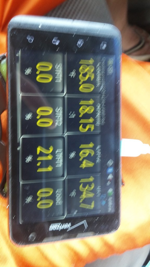

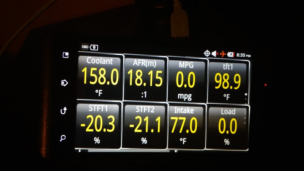

    This is bad rich yes? -20.3 and -21.1 short term fuel trim20170703_184158.jpg

    Yeah she pulling a lot of fuel. I'd say lean her up in 5% increments until things look good. Maybe buy a set of plugs after you are done. Under 10% in the LT and ST is where you want to go.

    She isn't going to save data until your coolant is above 160. Plus you want to tune once you are warmed up.

    Closed loop don't worry about your AFR's computer will hit 14.7 on it's own. You want to adjust fuel trims until they look good. AFR adjust is later down the road.

    Truck is in cold start mode until over 160.

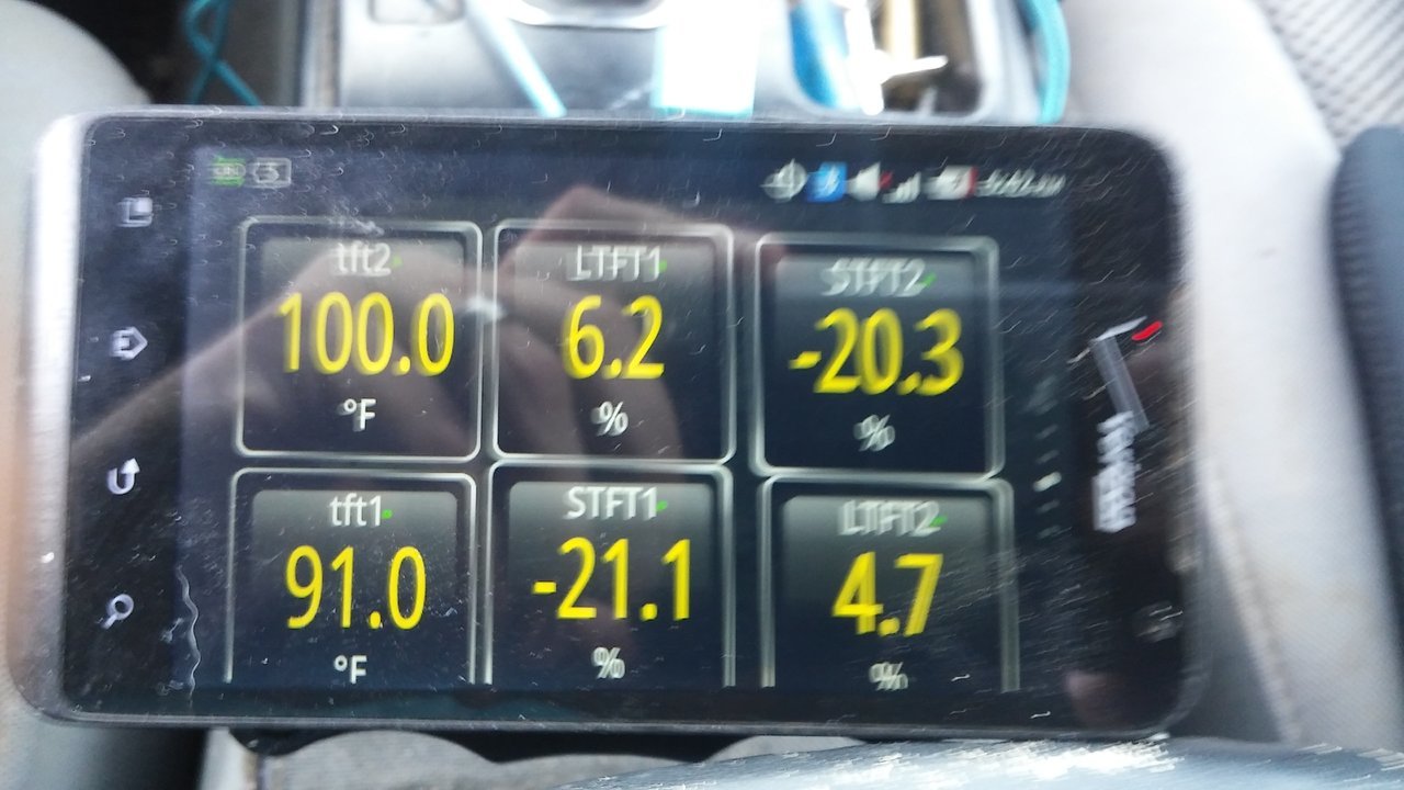

    20170704_080808.jpg Alright kinda halfway got my stft in check but my ltft are nuts now? Positive numbers are lean right? I dont understand how my lowest value is -.56 and some values are even positive, these injectors are over twice the size of stock so how could basically the same voltage produce a lean situation anywhere?

    Getting a bit too ambitious with that fueling. It takes a while to adapt to changes in closed loop. ST +LT + stock map = fuel output. Your fuel table is also added to the beginning of that equation. The way I tune CL is in 5% steps. For that setting you have here you want to add fuel because you got too aggressive. Add 5%. You will see your ST change and even feel the change in how your motor runs. Give it about 10 minutes for that 5% to make change to your LT and your St will zero back out. Once those St are back to zero you can take or add fuel again to adjust your lt to a safe area. Closed loop is a very slow process. Once you get good at it there are short cuts.

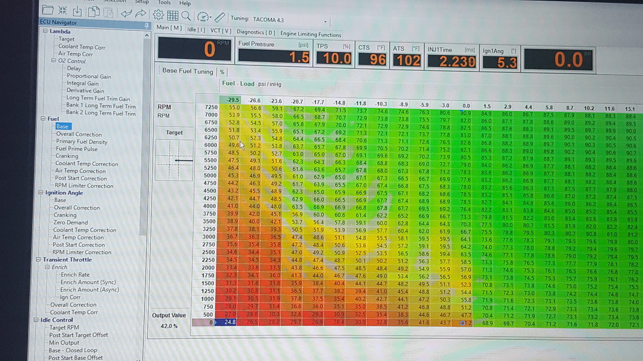

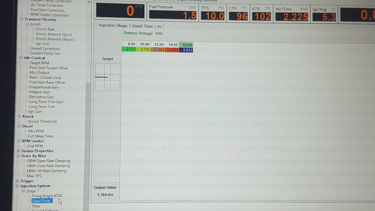

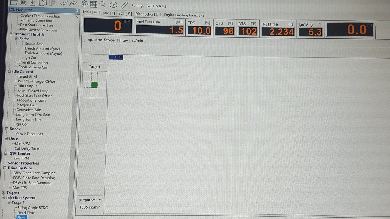

    The swap was easy. The "add in new injector profiles and it will run because VE map is already setup," was not the case. 35.2 AFR was a hair on the lean side at idle.....

    Same principle effect happened with the ProEFI. Had to add in a lot more fuel in the low rpm/load cells. Just the nature of these injectors. Had hoped for a different possible outcome, but knew it might still be the same.

    That V.E. fuel map was before the increases.
