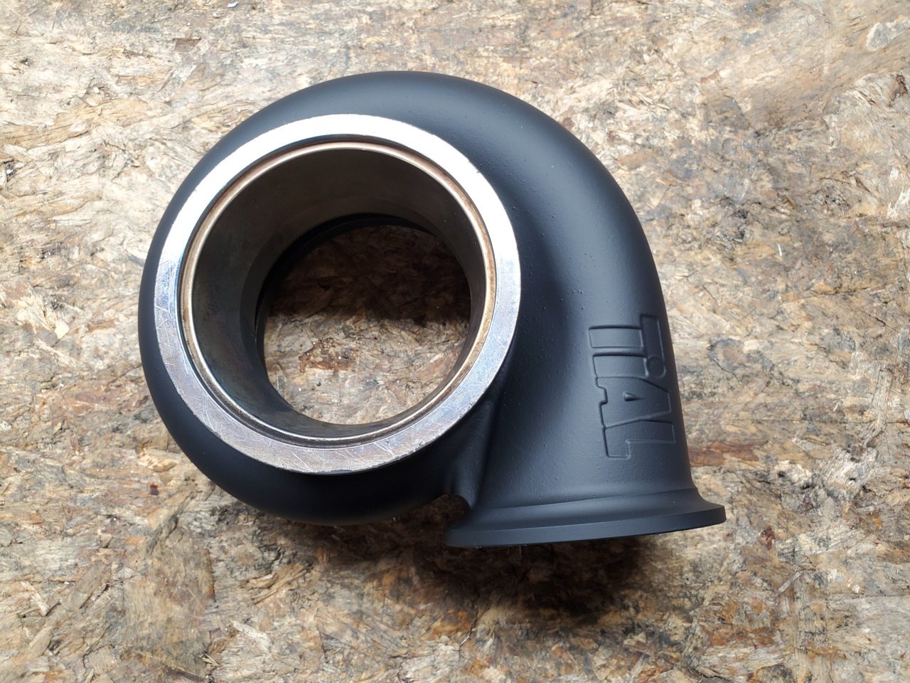

    Putting in some work on this contraption.

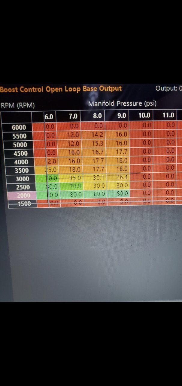

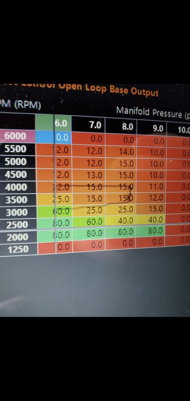

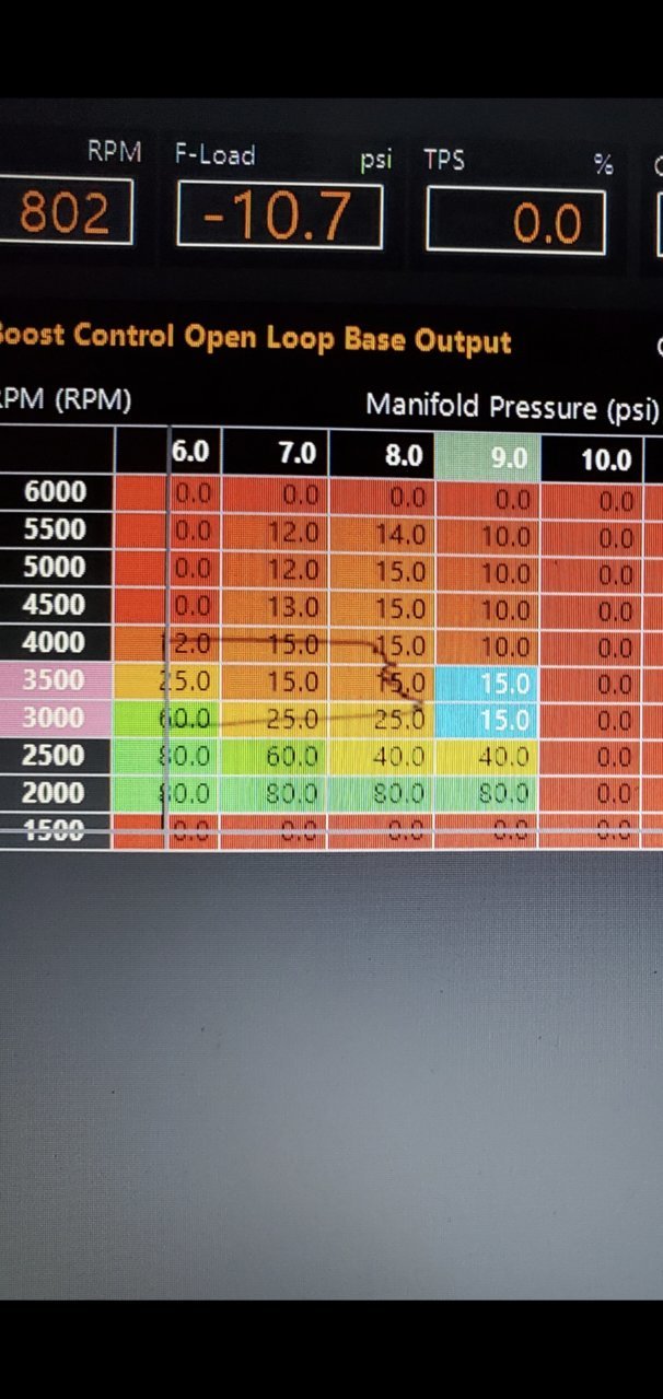

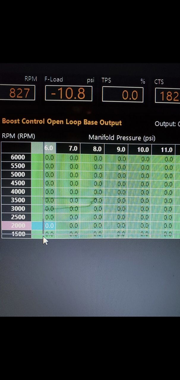

    Figured I would keep playing and switched to using the Top port boost control style.
    Used the same settings to start but knowing I would have to change them.Screenshot_20230822-161207_Gallery.jpg
    Very spooly and over shot.
    I kept pulling gain and it kept doing the same thing basically. Started to think I hooked it up wrong. Then I zeroed to map to see if that helped.
    Much slower spool and settled out at 8 psi. I'll goof with gain and see what I can dial in for spool.
    Speedytech7, Torspd and MadTaco461 like this.
  10. Aug 22, 2023 at 5:47 PM
    Torspd
    Torspd Tor-nication
    Sep 18, 2009
    #22958
    26,389
    Tor
    The Great America!
    MMVI 4.4L 4x4 Access Cab
    Torspd Custom Turbo kit [] Borg Warner 9180EFR Turbo [] Haltech Elite 2500 [] TiAL Q BOV [] TiAL V44 Wastegate @ 15psi [] CP Pistons [] CP Carrillo Rods [] ARP Head studs [] ARP Main Studs [] ARP Header - Head Studs [] Ported Heads w/ 1mm oversized valves intake/exhaust [] Brian Crower Forged Stroker Crank [] Darton M.I.D. Sleeved Block [] Kelford Camshafts [] Torspd 160* T-stat mod [] APR Large Fuel Rail [] Walbro 460 LPH E85 Fuel Pump [] FueLab FPR [] APR T56 Conversion Kit [] KP RACING Built T56 [] McLeod Racing Custom Twin Disk Clutch [] One Piece Aluminum Driveshaft [] MGW Shifter [] Custom lowering kit [] Ohlins Front Coilovers [] QA1rear shocks [] Custom Ron Davis Radiator [] Dual SPAL Electric Fans []
    Learning process for sure. I had the similar issue setting up my boost controller on the Haltech. Kept over boosting, and boost cut safety would kick in. Ugh. Did not like that feeling.
    You'll get it soon enough.

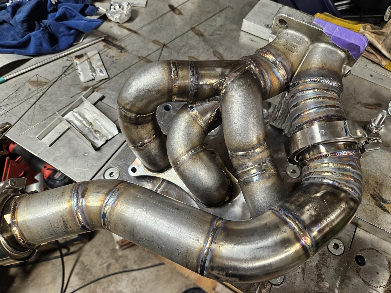

    All done! :woot:

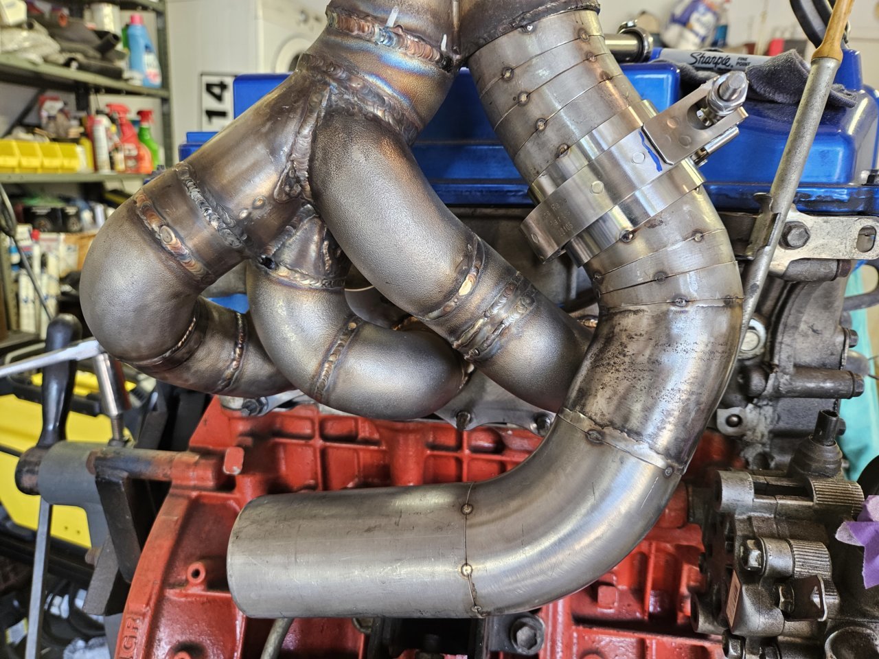

    Very nice @Torspd! I'm assuming Efr with internal gate?

    Yes sir. Made this one to place the turbo exactly where it used to sit with the older manifold.
