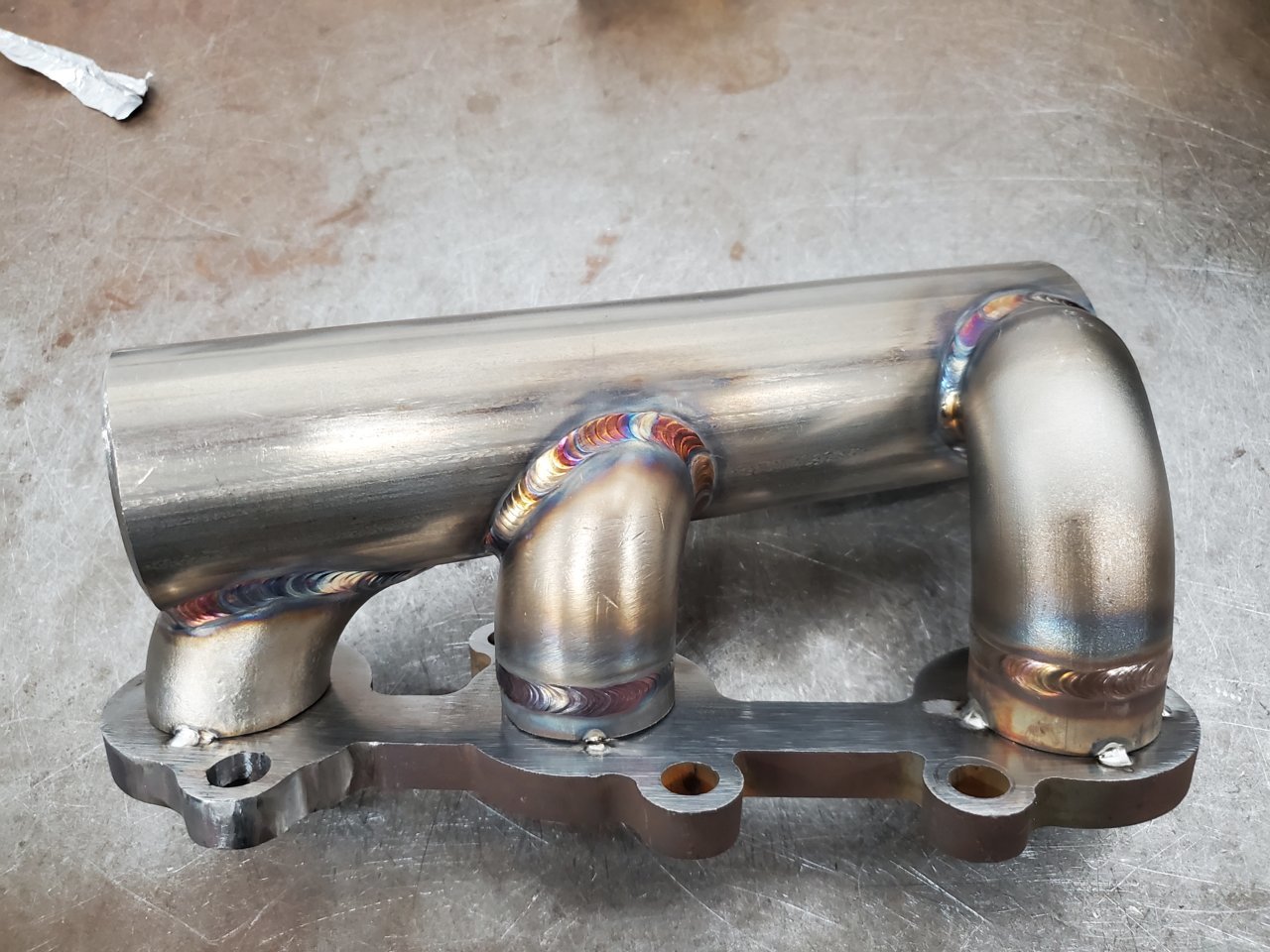

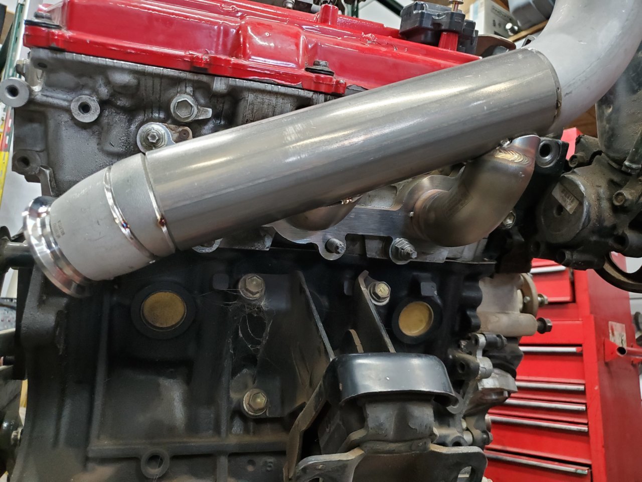

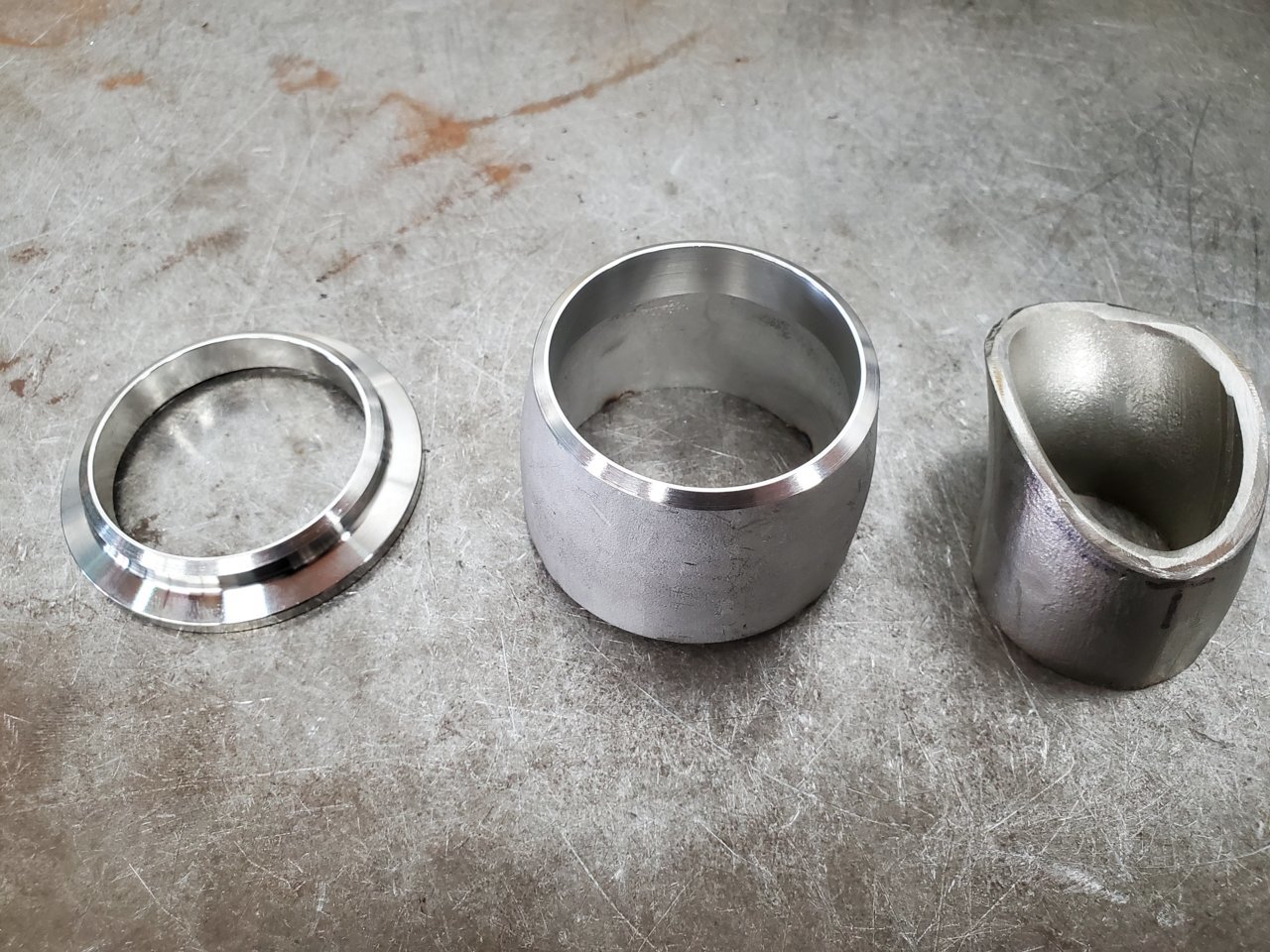

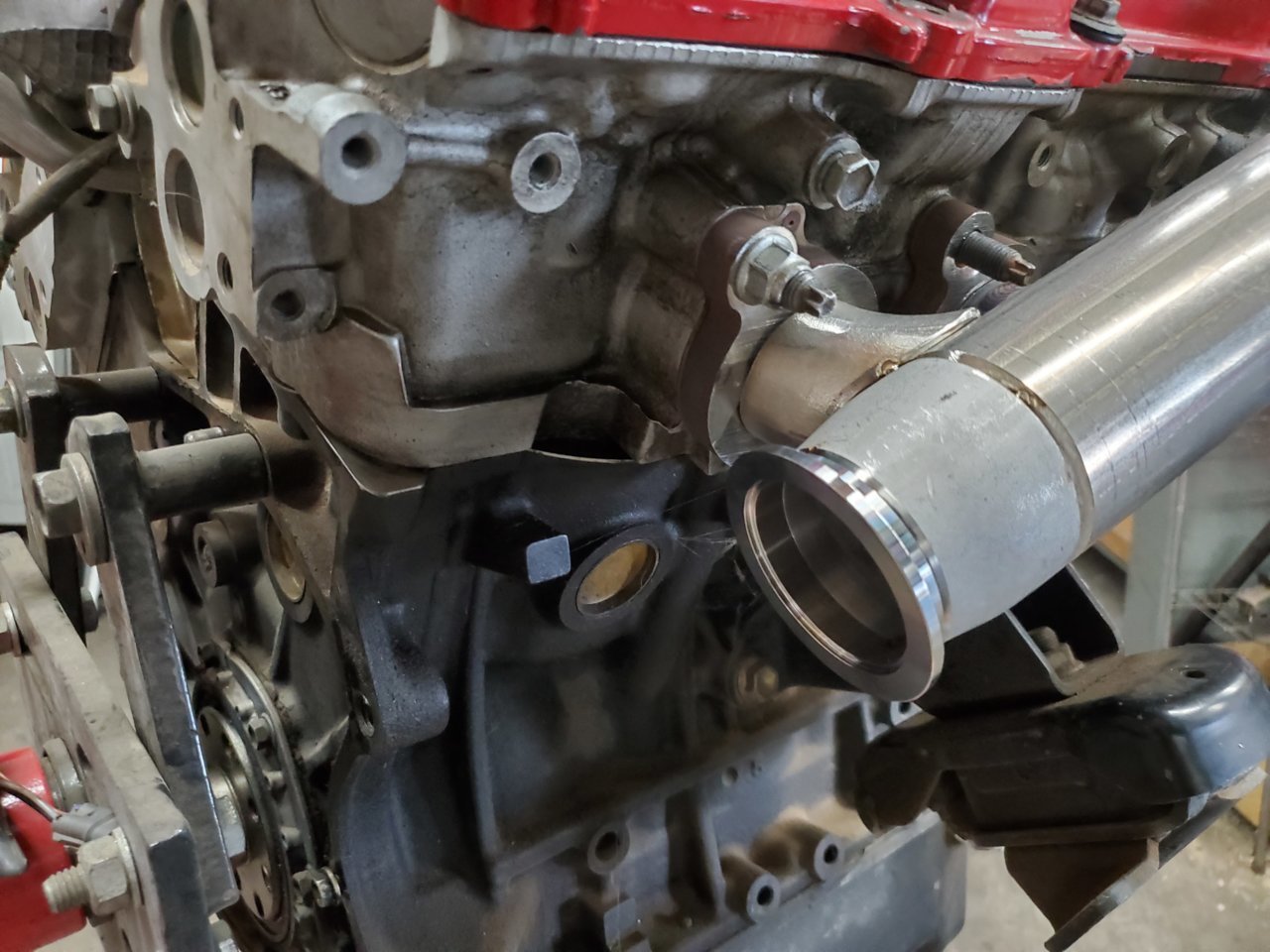

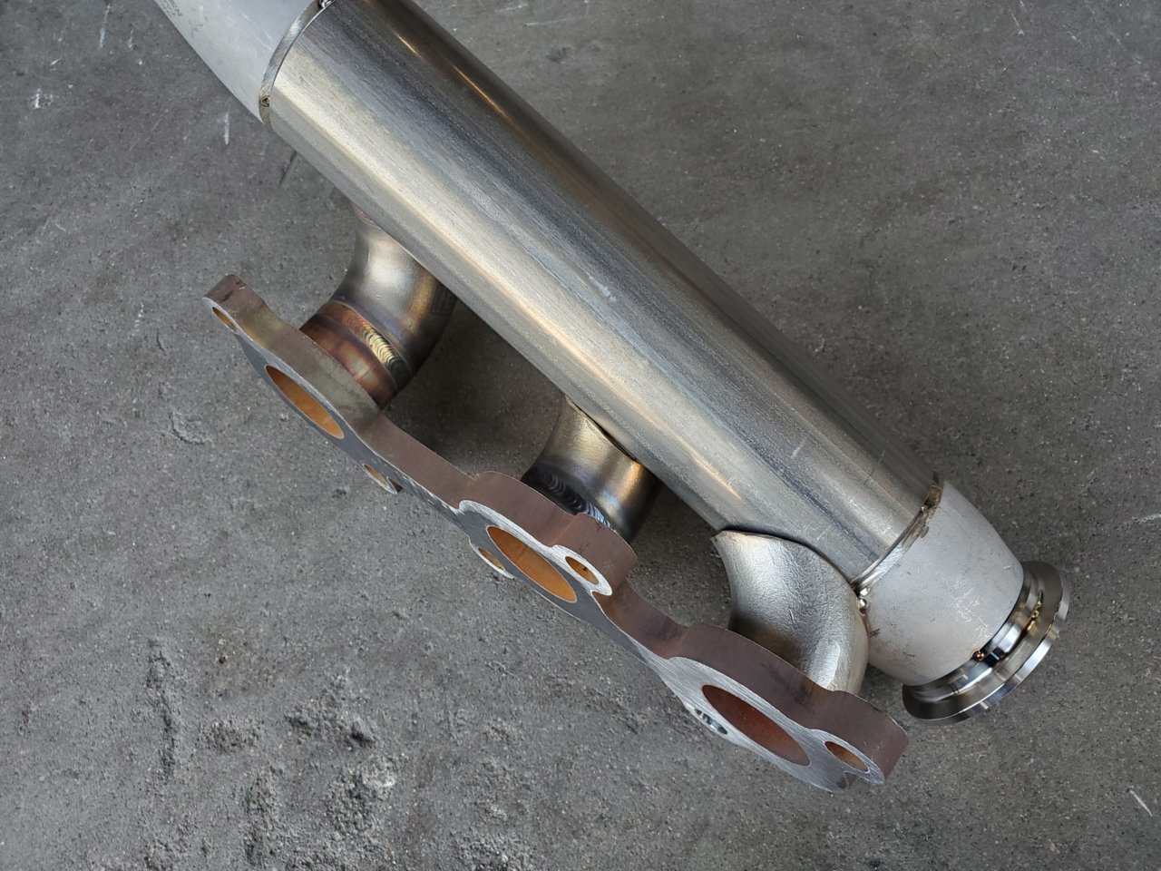

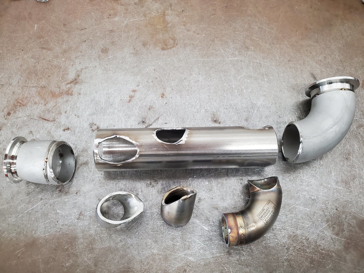

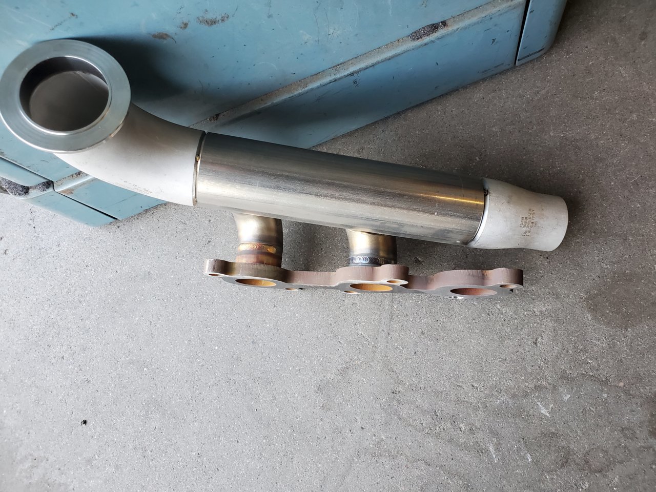

    Been goofing around with a different manifold concept in my spare time. Lumberjack style (it's a log)..
    20230829_144945.jpg 20230829_150008.jpg 20230830_113329.jpg 20230830_114016.jpg 20230830_114256.jpg 20230830_143941.jpg 20230831_095546.jpg 20230831_161249.jpg
    That's about where it's at for now. Need to remove the other one to make gate and final cross over.
    The other one has a better runner/collector but a smaller cross over. This one has not as good runners but larger cross over. Weird mixed bag, will be interesting to see any differences. Make no mistake, current setup rips!

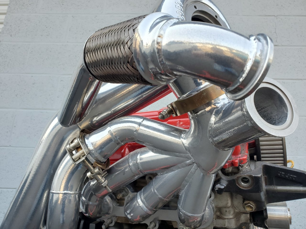

    Original version for reference. Cross over necks down. It was easier at the time. I wanted to make the same thing but with a larger cross over, but with the material on hand I figured I would try something else.

    That's a stout looking kit though, damn.

    Manifold needs to be named the hand of god. Looks like great stuff

    My last one was like this kind of. Sometimes it is a manner of fitment that takes precedence over want of style. Regardless, your manifold has been proven to work very well in many applications. Laminar flow from the crossing over bank will create good scavenging anyway.
    Plus your welds are mint! :cheers:
