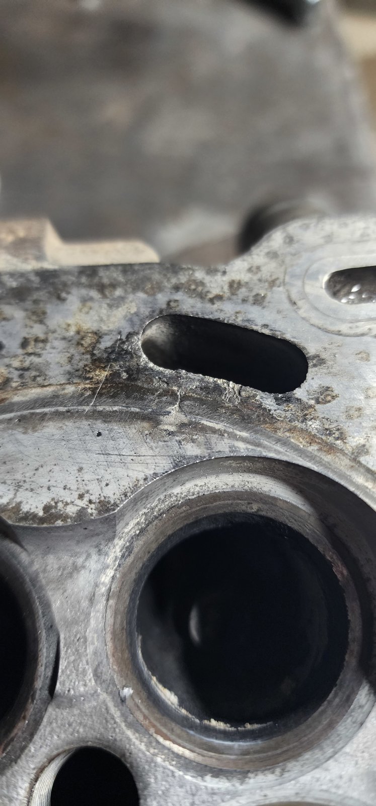

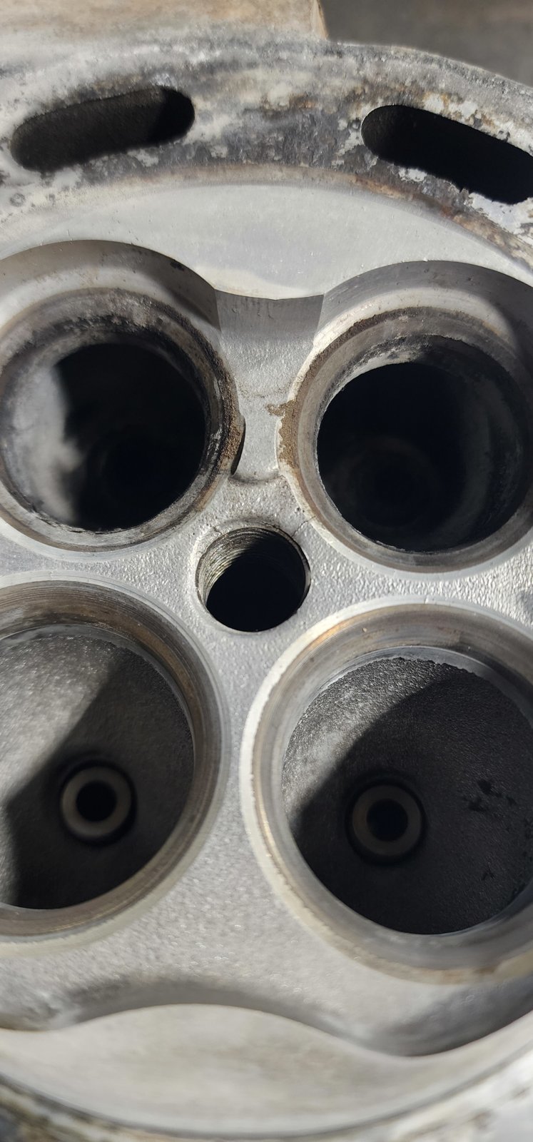

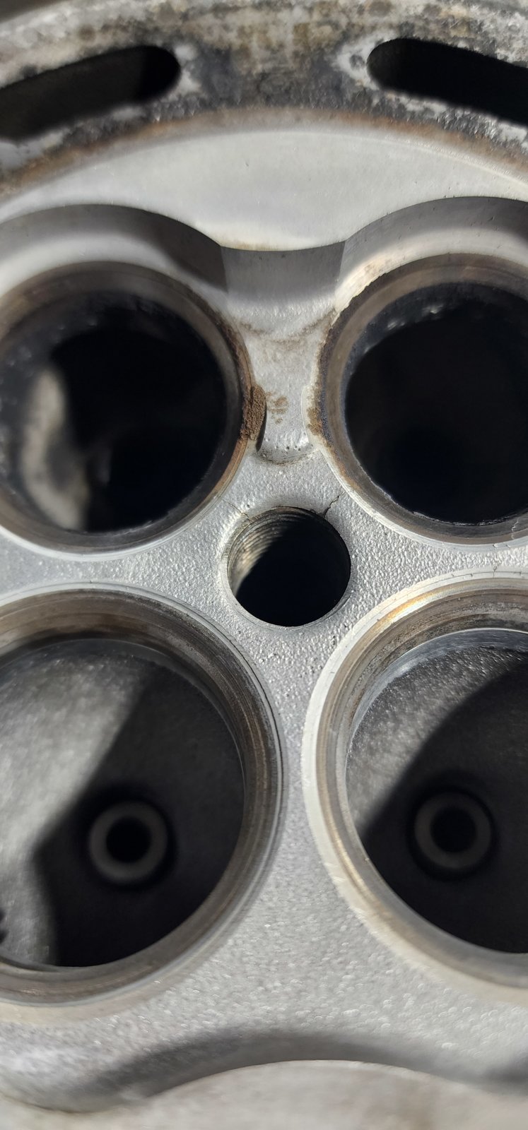

    Well cylinder head is trash. Cylinder 2 & 320231219_114218.jpg 20231219_114210.jpg
    Pretty sure this is where the leak into cylinder 1 was coming from. 20231219_112938.jpg

    Pretty normal for a 3RZ head unfortunately, not very strong in between the valves and plug. Mine cracked in the same spot.

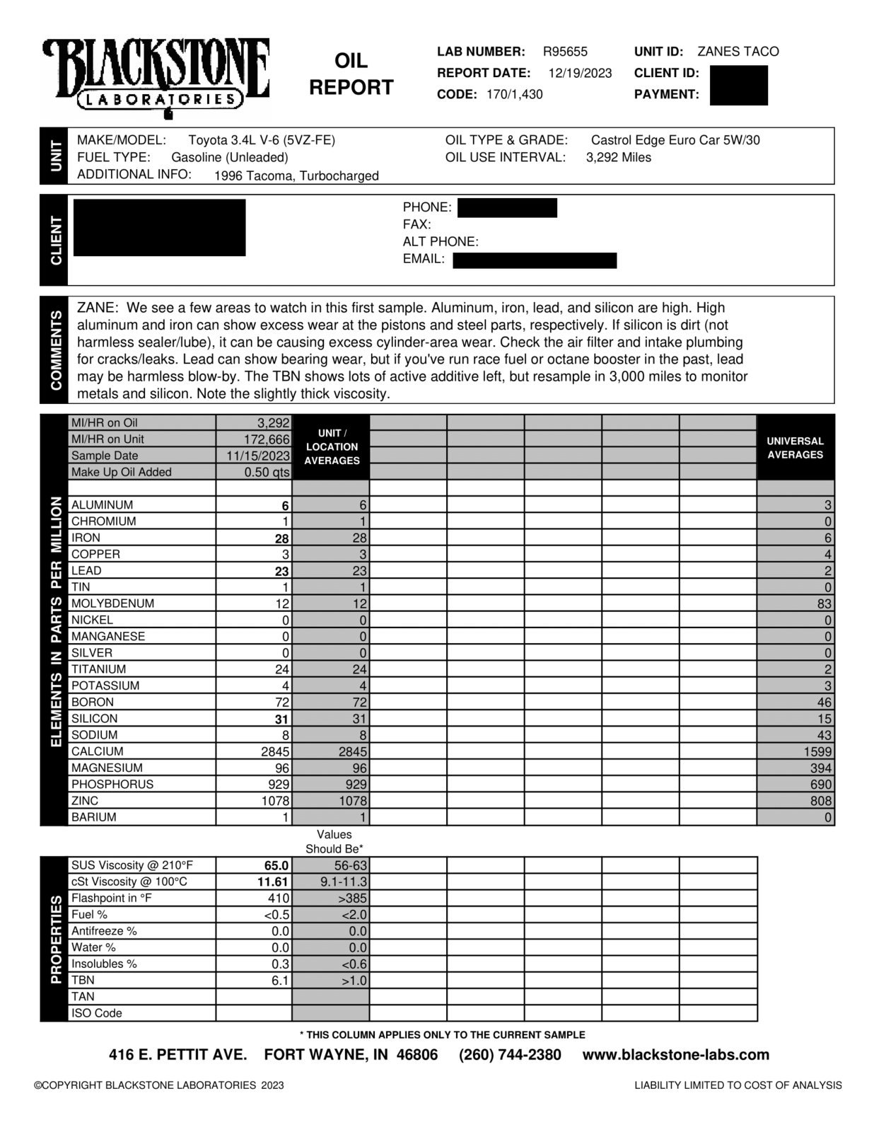

    Sidetracking a bit, and guys here want to weigh in on this?

    Well your engine is new. How many miles does that oil have on it from break-in?

    It's not a new build. It just had the turbo stuff put on it. And I resealed the engine while I had the oil pan off to weld in the turbo return and I did valve covers and the rear main at the same time. This sample is from the second change of oil since I installed all that. I did it shorter break in run with some Costco full synthetic 5W30 before this oil.

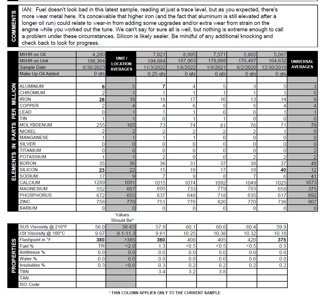

    If it's any help for comparison sake, here's my last analysis after doing the HT & turning up the boost

    I'm just now due for another oil change anyway, did a 3400mi trip. So we will see if anything has changed. I will also take the sample after the ol girl has warmed up this time.

    The higher numbers mostly don't scare me much on an engine pushing limits over stock. It's the lead that is the only real concern on mine since it can really only come from one place.

    I am quite curious to compare your next sample. The more data the better.

    Ah. Yea bearings aren't a good sign.
    Def just run it for another cycle and see where the trend points

    Blow by from race fuel?
    I'm about 3k miles with the turbo too so I wonder what would show up in mine
    Also wasn't expecting you to be using 5w30

    I've just been running regular 92/93 octane, no leaded fuel that I'm aware of. It's possible when I was doing the valve cover gaskets I got some sort of contamination in there but I don't think so. I don't put anything together dry unless it's absolutely required but I'm pretty sure my assembly lube doesn't have any lead in it.
    I am running a pretty severe spec of 5W30. Clearly it's not 5W-30 either they said it has more viscosity than it should. It's the same stuff I used to run in my turbo BMW that's supposed to help inhibit knock as well by reducing hot spots. I probably will change it on this next run. I might go for some rotella t6. But there's also a 5W-40 version of this oil too but I was kind of shocked to see how low the molybdenum is in it so it's got me considering other options
