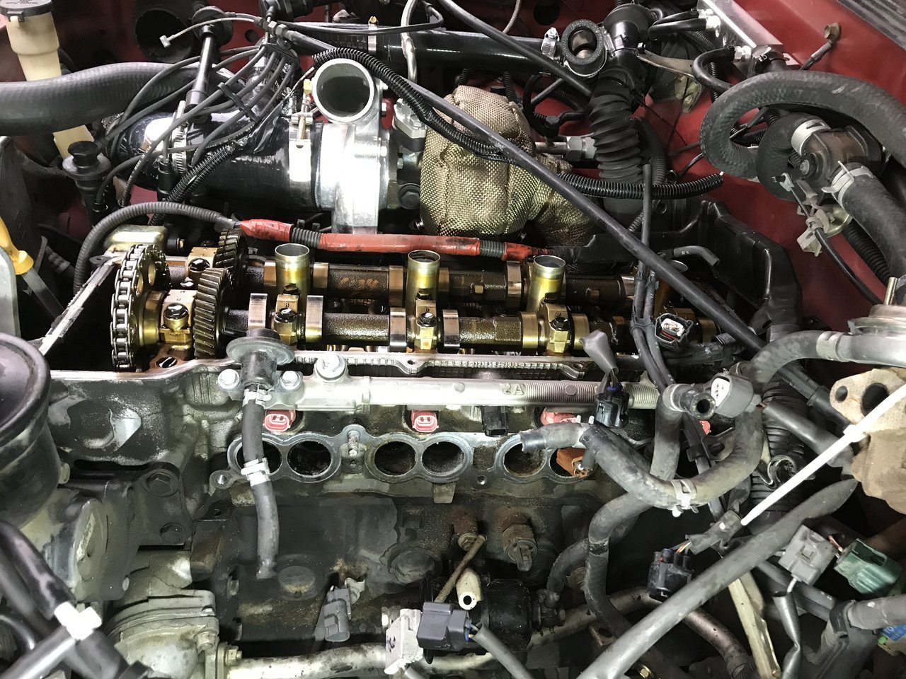

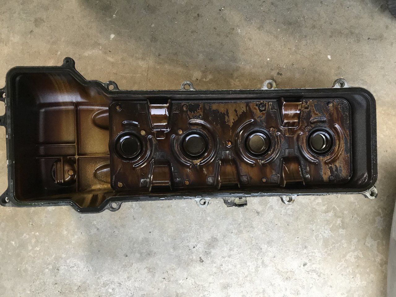

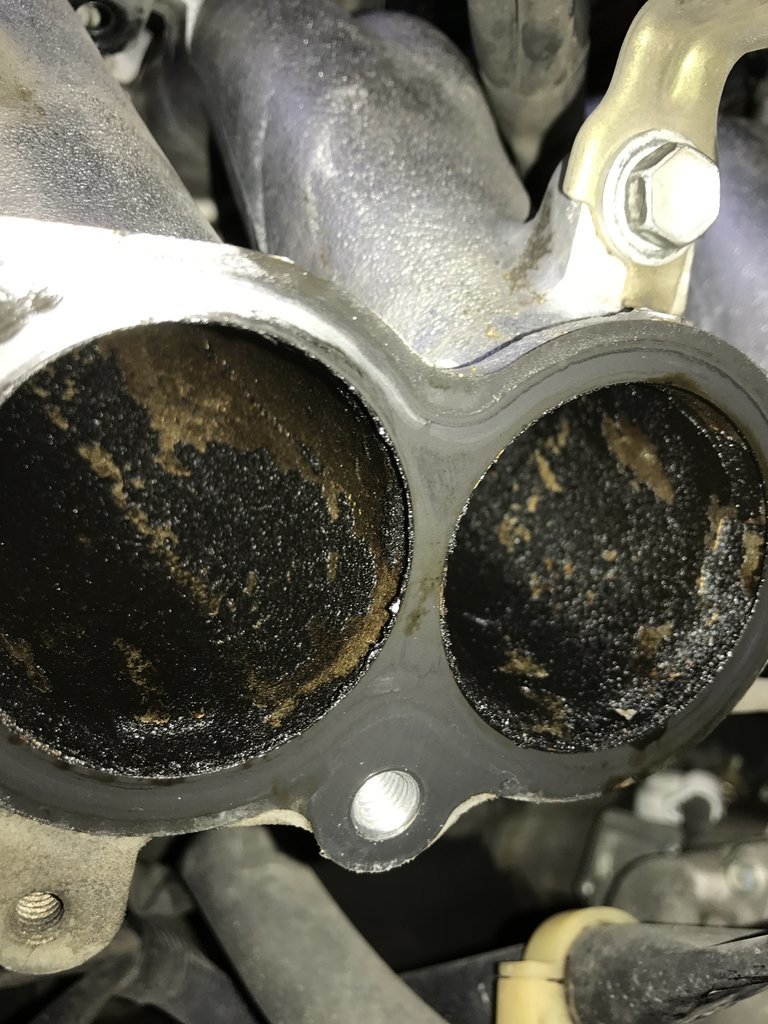

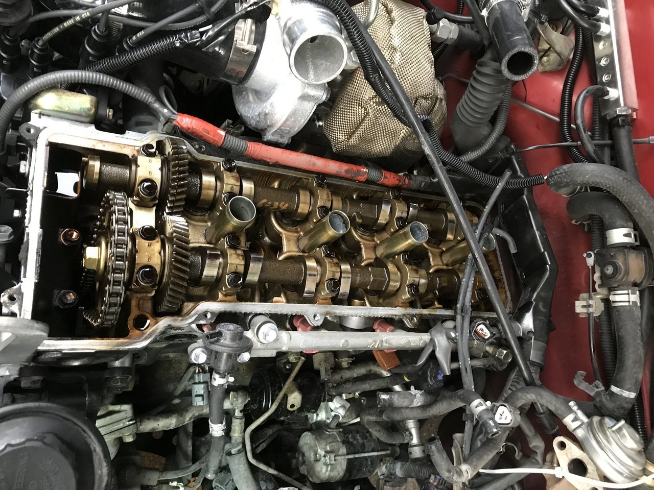

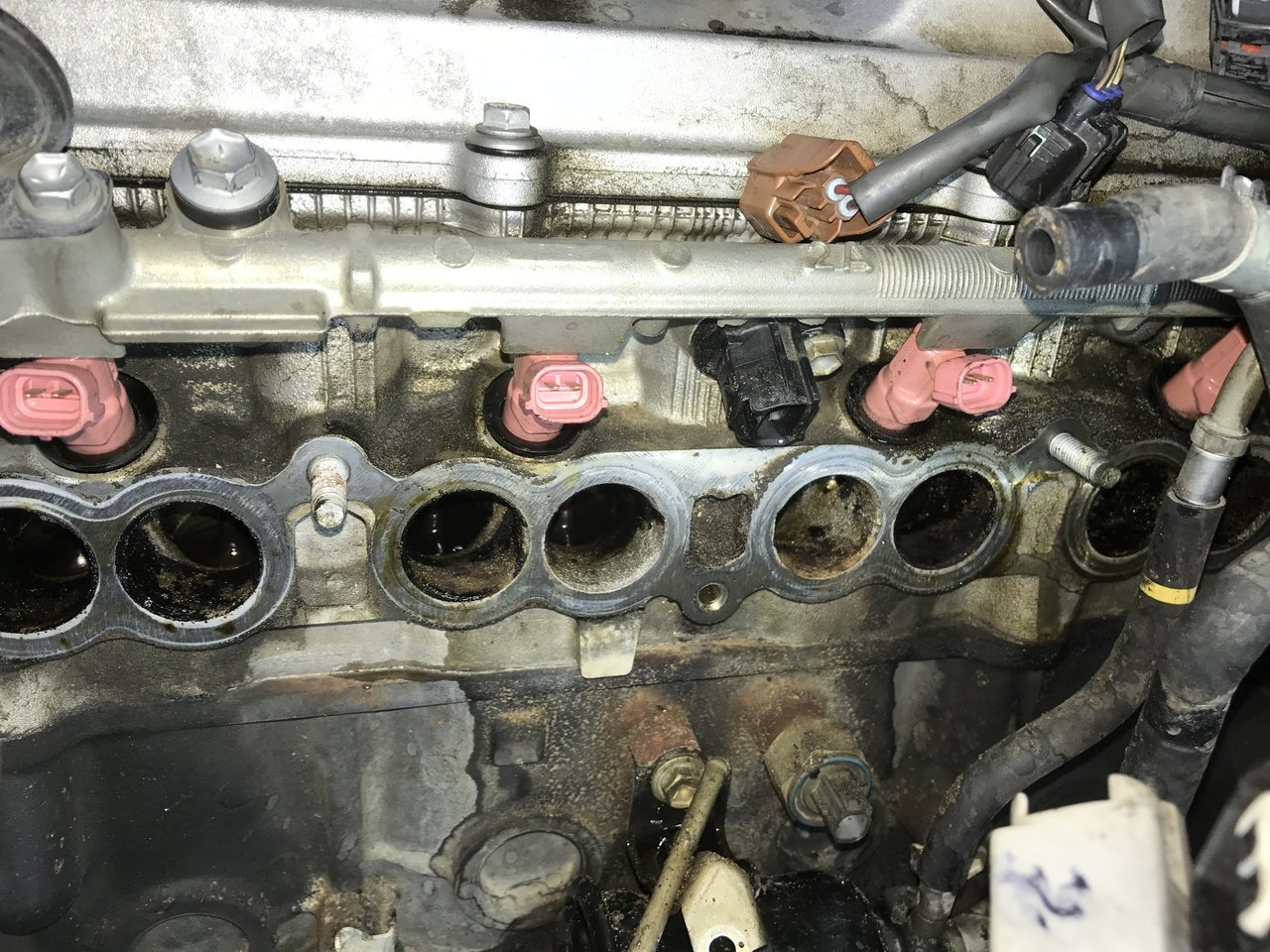

    IMG_5743.jpg IMG_5753.jpg IMG_5750.jpg I decided to clean the intake throttlebody and change the valve cover gasket and fuel filter today :eek: its a lot more involved than I thought IMG_5751.jpg IMG_5752.jpg Still maybe not to bad for 220000 miles
    Torspd and MadTaco461 like this.

    That oil and gunk is from your PCV. Get a catch can to reduce that. Get a very expensive catch can or a vented catch can to completely eliminate that.

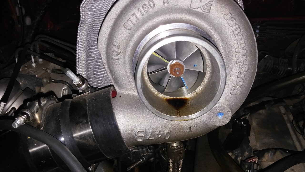

    :bananadead:20170705_210226.jpg i think something may be wrong with my return line... On a positive note, an oil saturated maf and o2 sensors couse be whats givin me some tuning troubles:bananadead::bananadead::bananadead::bananadead::bananadead::bananadead::bananadead:

    That's better than dry and seized :rolleyes:

    Does your drain line have an upward hump in it?

    are you asking if it goes like uphill before it gets back to the motor? if so no; I'm kinda wondering if there could have been something blocking it (like a dirt dobber :anonymous:) since my buddy just had it in his shop. so a rebuild kit is in my future yes? the seals are most likely toast?

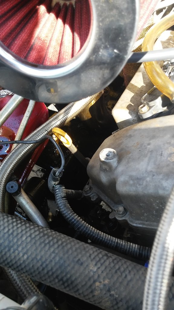

    The supply and drain should be as close to straight up and down as possible so extra oil is not pooling in the turbo but rather drains straight out of the bottom.
    Could also be from massive blow by. That oil looks old and looks like its thinned out from mixing with gas? Either way, check your PCV and consider a catch can.

    I have a catch can so i dont think its blow by

    Also oil is in the tail pipe

    Is it vented or a very expensive one? Otherwise its not catching much. Pack it full of stainless steal wool and try to isolate the two in and out ports.

    Could be bad seals on the turbo. Maybe needs to be rebuilt. Is your oil drain line oriented 90* from the ground, ie, straight up and down?

    vented to atm
    its about 45° 20170627_203303.jpg i know u can barely see it but u get the idea

    Here is how it was with no issues untill the line cracked before20170612_164412.jpg
