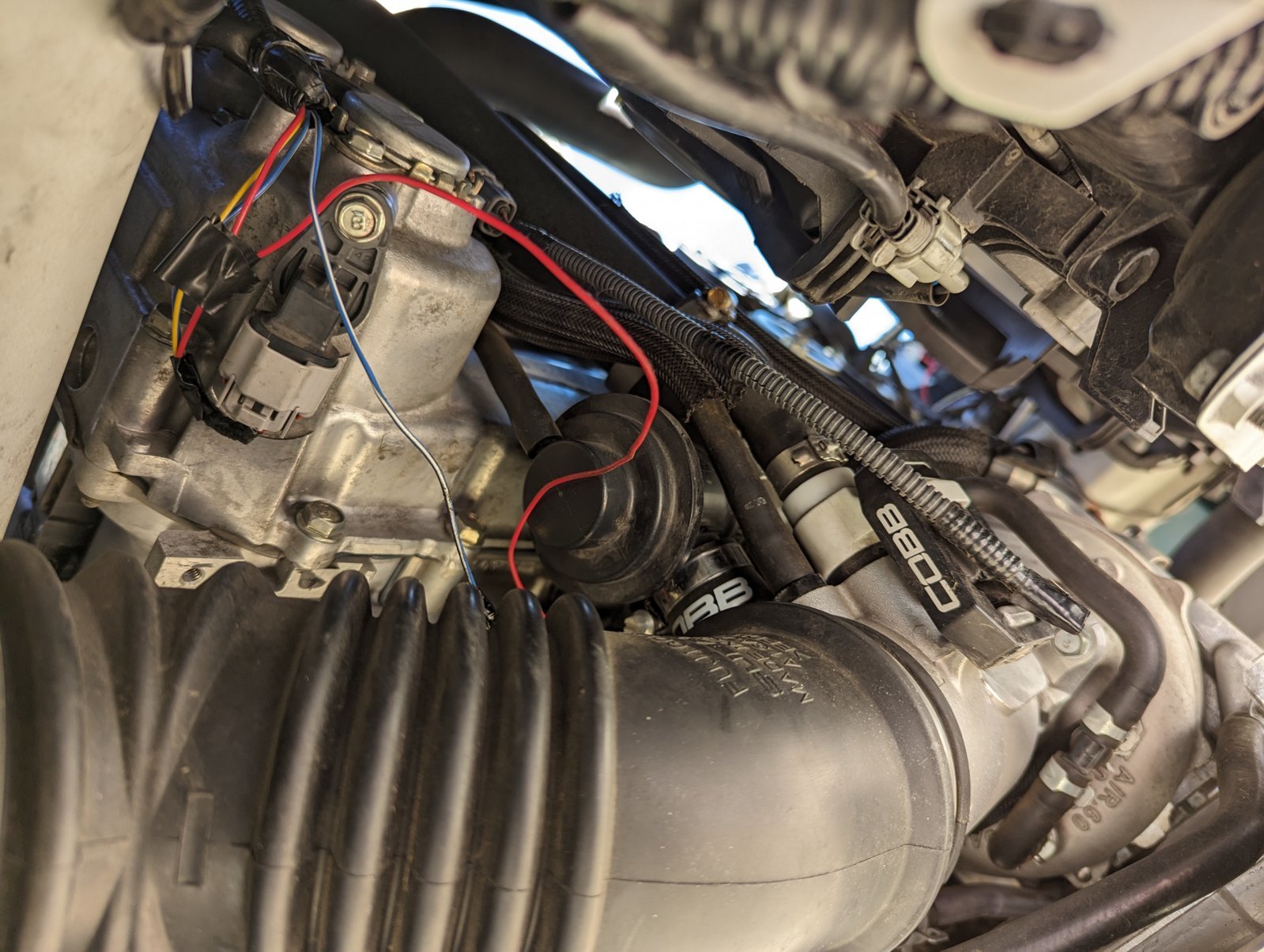

    Back on this note. Finally found the problem. So the ebcs gets power from the main 12v that goes over the engine harness. Well the 12v power broke at the crimp. I didn't want to unwind up to the crimp so I soldered to the nearest connector that uses the same 12v feed. Back to being boosty and no more cel. Guess Subaru crimp connections are kinda crap. Even Cobb did a write up on it for the EJ motors. This was before the solder, but I tapped into the exhaust cam sensor to make sure the cel went away.

    If it works, and the ecu is happy, then it works.
    What does the Subaru crimp connector look like?
    *Edit* For some reason I thought you were using Subaru connectors on your Taco. I looked lore closely at the photo.

    Yeah this was on my car. 25yr old engine harness on the taco still going strong even with all my patch repair wires on it.
    This is what a subaru crimp looks like when you unwind the wire harness. I just replaced it with solder.

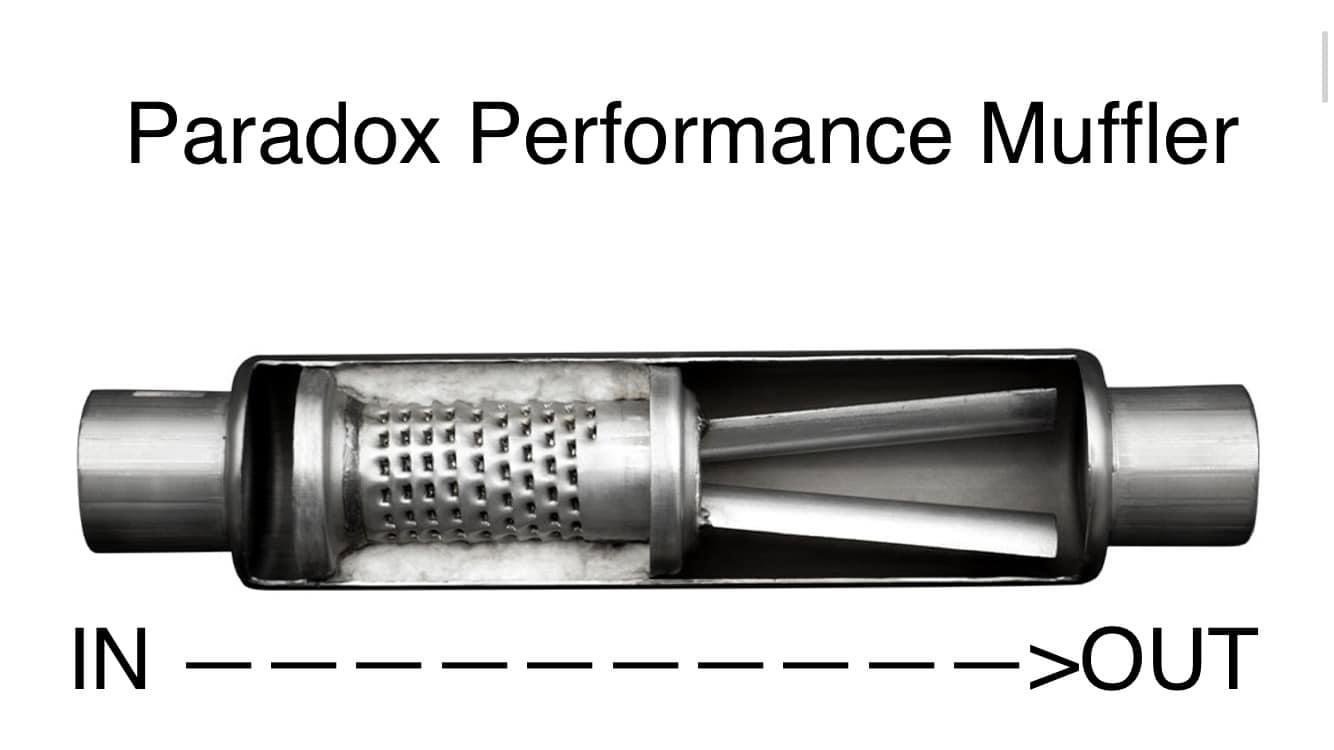

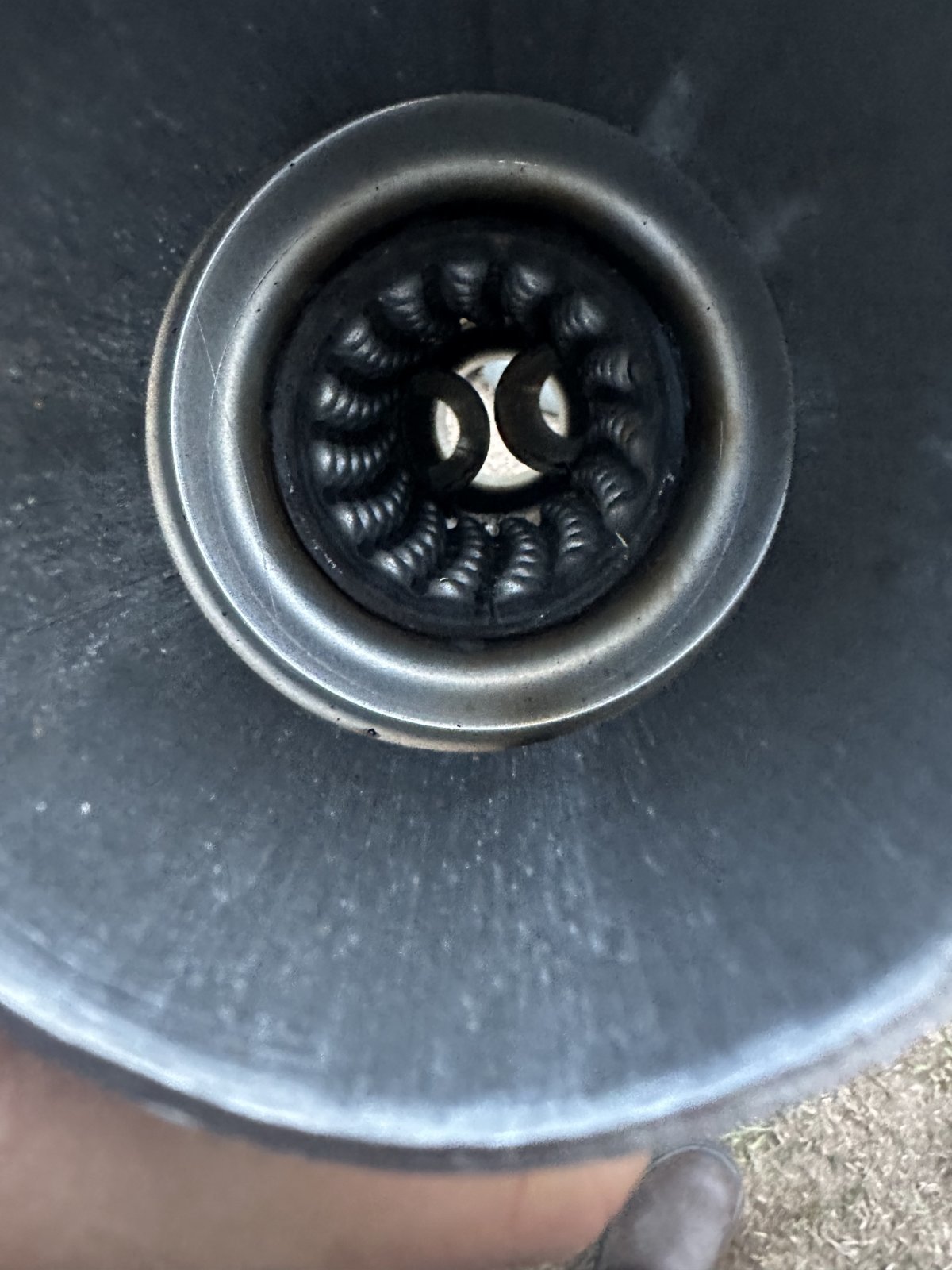

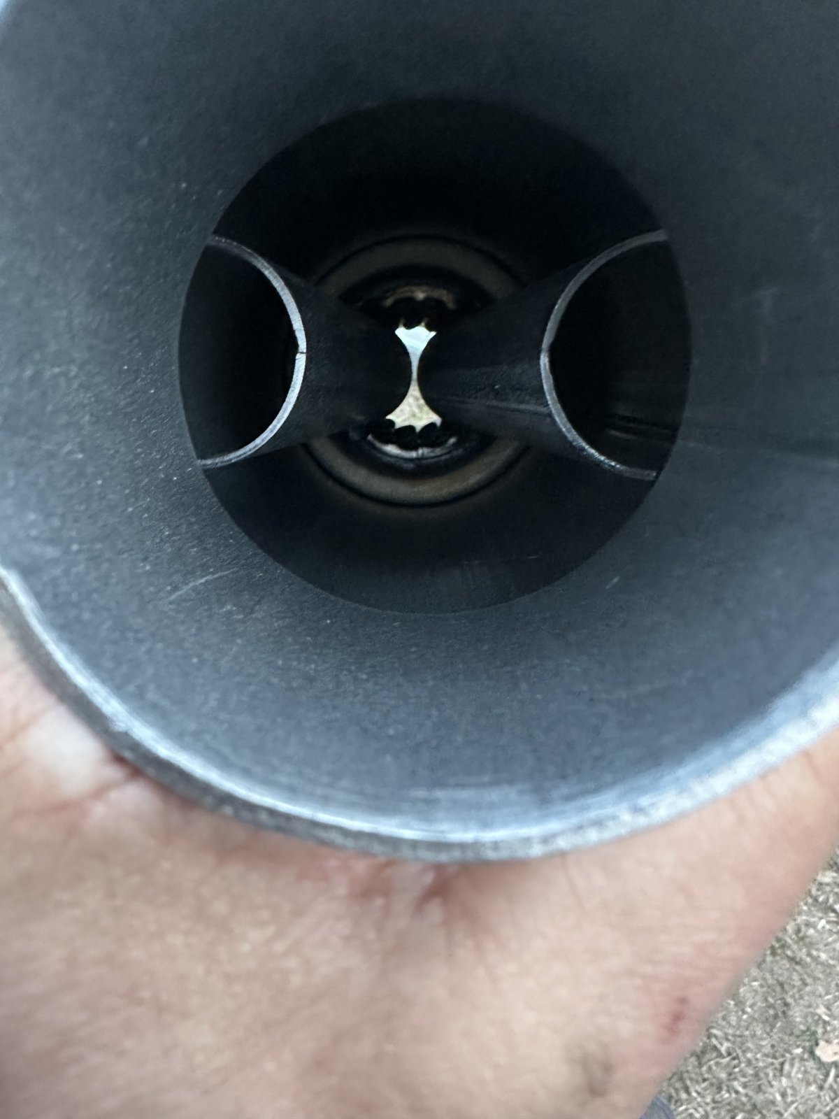

    Not trying to hustle this brand but am trying to hustle some posting. I will say this muffler surprised me. 3” downpipe to 2.5” muffler then dual 2.5” to 4” tips. Nothing fancy, no cat nor resonators. The muffler guy was probably more excited than me to fire it up when he lowered it down.
    Half glasspack and half…weird chambered space. The ends of the half pipe pieces are loose on the exit side. So there is potential of one coming loose eventually.
    https://paradoxmuffler.com/signature-series-performance-muffler/
    Remember this is a 1.8l inline four.
