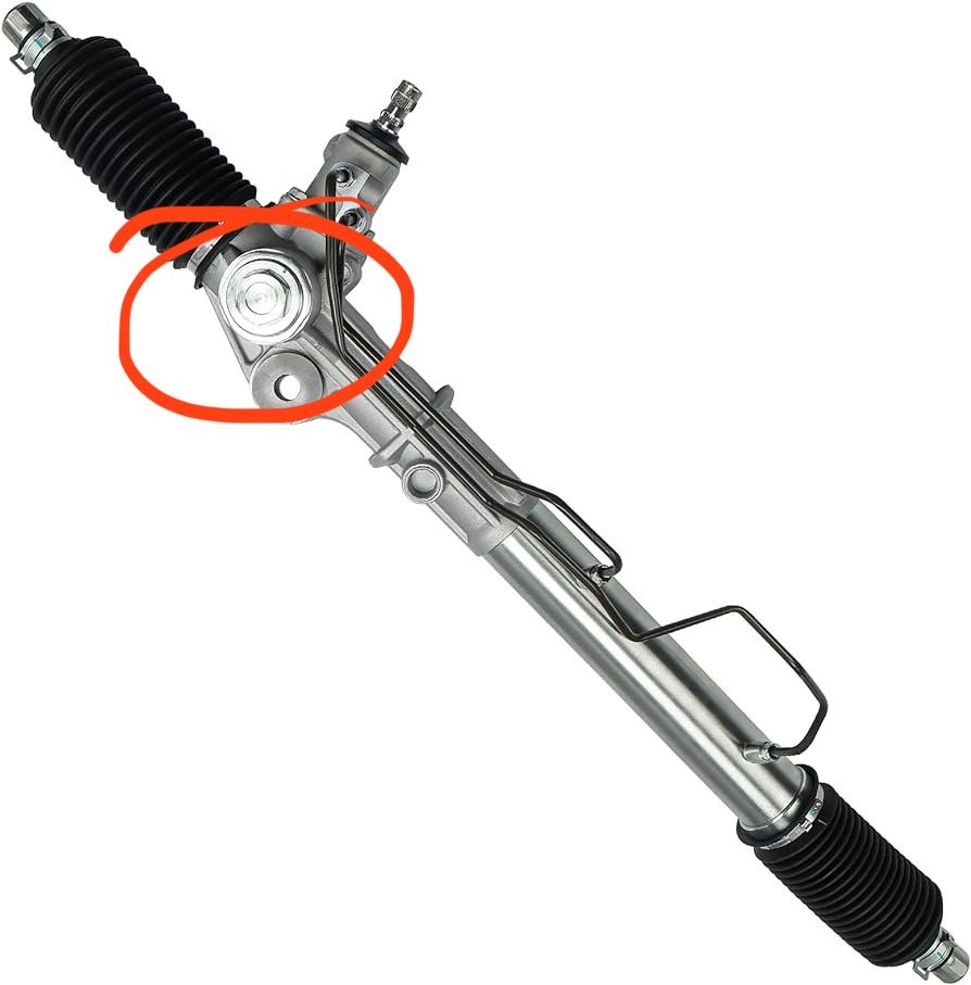

    Is a possibility too.
    Looking at this photo, I may be able to un-bolt the top section. Re-clock, then reassemble. Sounds easier than it probably is though.

    They might use a different thread pitch and internals. The parts inside dont need to do what OEM does. Just the external connection points.

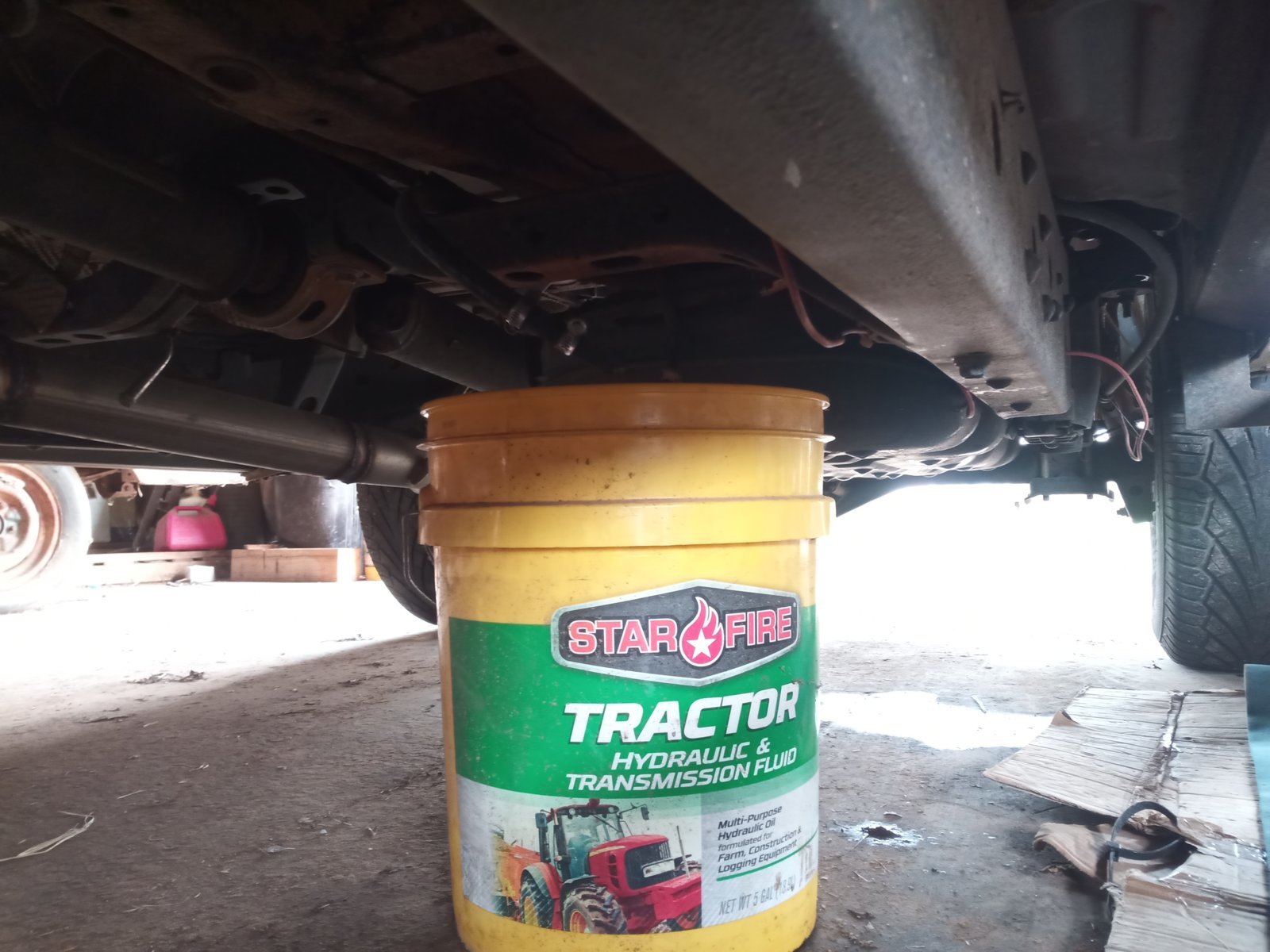

    Pour a gallon or so of methanol in with that E and try to slosh it around.

    There is a large hex and with a jam nut behind it. Mark the large hex and back it out. This presses the pinion against the rack is my understanding. I came across some threads on 4x4Pirate or somewhere years ago talking about tightening it on older high mileage R&Ps to get a little more life out of them. Back it out until you can feel the teeth slipping around (if it will) and then tighten back to mark.

    I thought about it, but I'm just gonna drop the tank and drain it, it was less than half anyway. The crappy thing is is that the stations I was getting e85 at swapped to circle K and I don't think they carry it... I think my injectors are too big for my piggy back to pull enough fuel for 93 octane. Gonna have to break my own still back out I guess lol

    Could just drain it via the fuel rail into a bucket. I’ve done this a few times over the years.

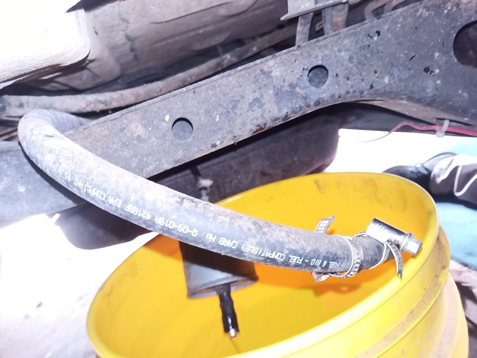

    I was way over thinking this, forgot that the fuel pump kit from urd came with an inline filter to add... Couple hose clamps later and I'm in business IMG_20240315_132937_086.jpg IMG_20240315_132924_121.jpg

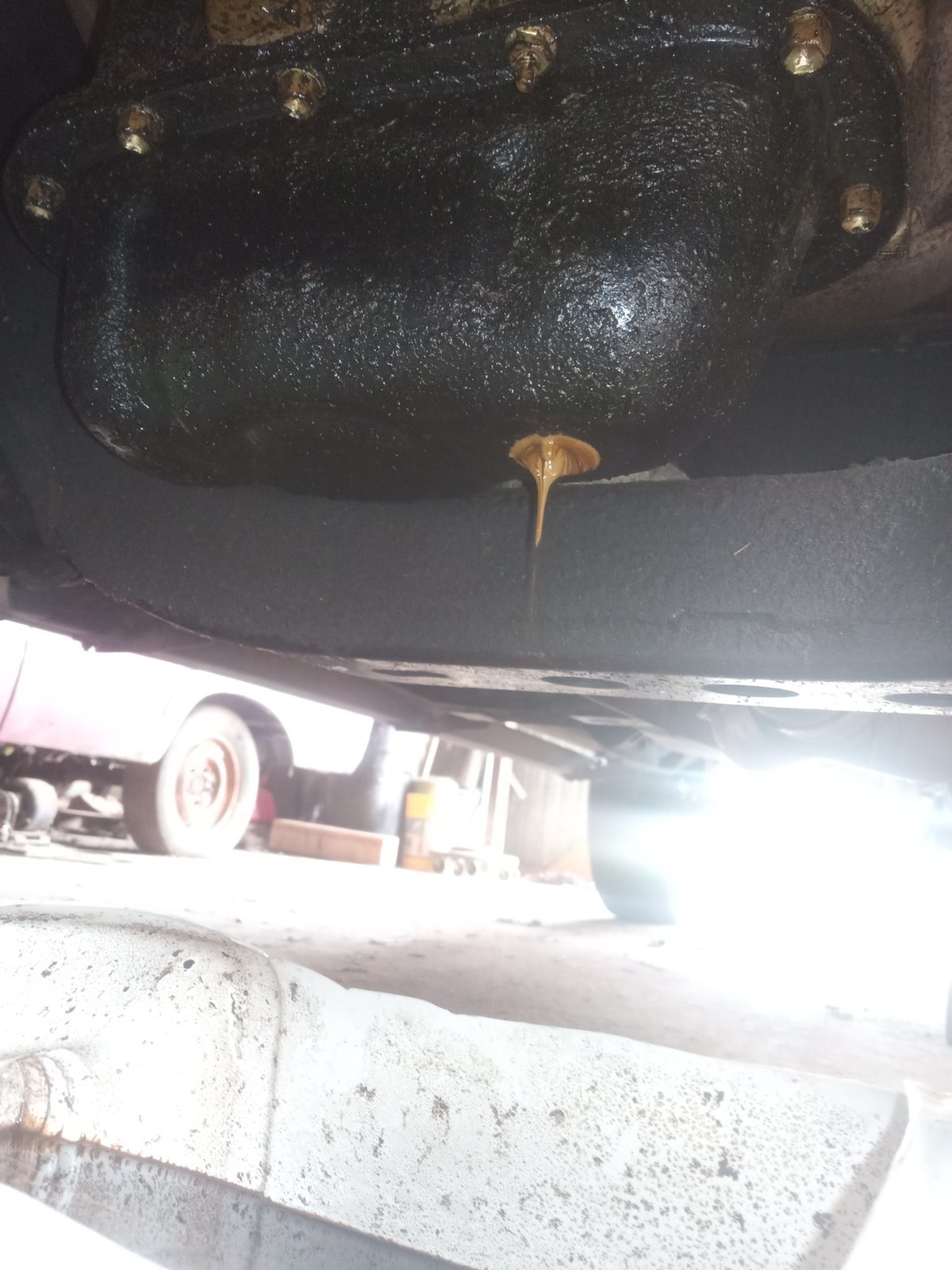

    Well, I put everything back together and it started to crank for a second then made a bad noise again... No bueno, bout to drop the pan I guess IMG_20240316_153157_948.jpg

    She is currently locked, it spun over ok for a little while, but I put a pull handle on the crank and it moved 1/4 turn or so and stopped. I scoped up through the oil pan and the rods I could see looked intact and straight... I've never in my life hope I have had a blown head gasket in my life, but that wouldn't explain the lock up too much, I guess I'll pull the plugs again see if I can turn it again and hope the sheer compression is locking me out

    Ohhh head gaskets is blown, coolant leaked into the cylinder and now there is water back in the cylinder and it won't turn... Could I be so lucky?

    Can't you just undo the rag joint and recenter the rack then put the rag joint back on?
    I'd imagine if the pinion slipped it might be damaged though.
