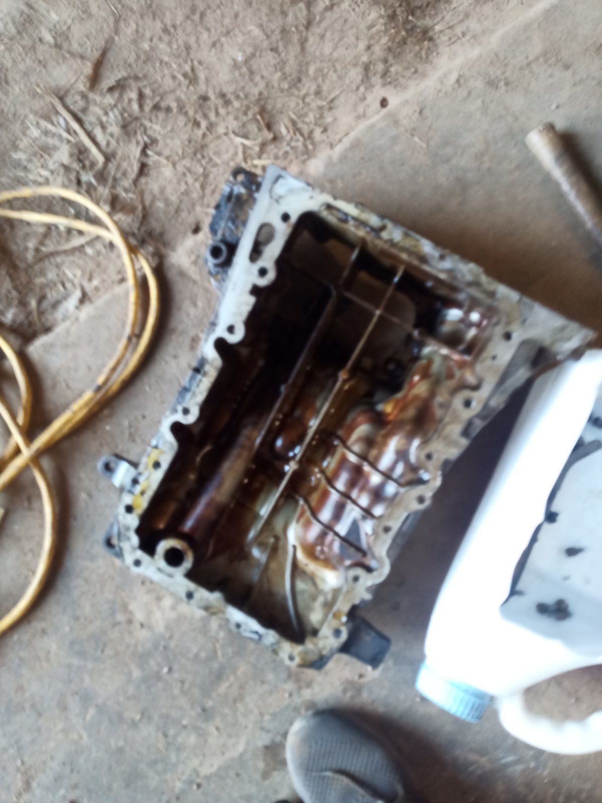

    Well, oil pan is off and everything looks fine... But it still won't turn all the way over, I can wiggle each of the rod caps and I don't see anything that looks like catastrophic failure anywhere. Is there something specific that should pop out at me? On an unrelated note, I have been window shopping 1kzte... IMG_20240328_174131_057.jpg

    Have you checked under the valve covers to see if there is a valve in the stuck open position?
    Either it either that, or the chain is binding.
    yota243 likes this.

    No, I did look at the chain through the oil filler neck and nothing I could see looked off but obviously, it's not making a full rotation so the problem could remain hidden. I guess I'll pull the valve cover next, I'm eventually going to have to anyway if I have to pull Pistons, I was just trying to take apart as little as possible...
    Torspd[QUOTED] likes this.

    Have you tried rotating it counter clockwise? Plugs are out?

    Yeah plugs are out, yes I can go clockwise and counter clockwise to essentially the same spot, but it will not pass, let's say cylinder 3 will go from at or near tdc to at or near tdc, but will not go past that point wgile turning either direction.

    I fear the worst could have happened.

    The dang starter is just too stout... I understand if the engine is running and you slam it full of water, but I can't believe just turning it over with the starter could cause that much damage. What is "the worst" btw. I mean I would have thought the worst would be a rod wound up outside of the block lol

    Could be a bent rod. Have you looked up in there?

    Yeah, everything looks good from the oil pan looking up

    My experience with my non-Toyota engine failures were valves contacting pistons. If you have the plugs out and there is water sucked into the jugs then it should blow out and be fine. The fact you can make almost a full stroke either direction is indicating a valve issue. My last incident dropped a valve and broke it in three pieces. 90% sure it was my fault.
    Have a peek down at the piston tops and see what they look like.

    Most likely a valve, as he stated. Probably not the case, but In a few rare instances, I have seen valve seats fall. That one is a tad trickier.

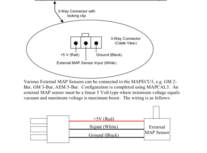

    Hey all, I have a MAPECU question. I'm SC'd not turbo'd, don't hold it against me haha
    I'm using an external MAP sensor (I wanted to use the built in sensor for barometric readings and compensations) and for some reason, even though I've selected the GM 2 BAR sensor, and it shows in the input/output tab MAP sensor selected, I've noticed 2 things:
    1. the pressure is constantly 12.7 psi in MapCal. It never changes, and I tried 2 different ports on the engine. Maybe I switched the +/-? Should the sensor measure atmospheric pressure and then calibrate itself to 0 so that it shows vacuum at idle and + under boost, like my AEM boost gauge does? The wiring is kind of confusing based on the picture from the manual....I interpreted the "cable view" as if you were holding the cable/connector and looking at it from the front (end you would insert into the female terminal on the MAPECU) so, as you plug it in, +5v would be on the right, but looking at it from "cable view" its on the left

    Well the + and gnd were reversed. Got the multimeter out and tested. Flipped the wires and now the pressure reads like my boost gauge. Should've done that from the start. Oh well
