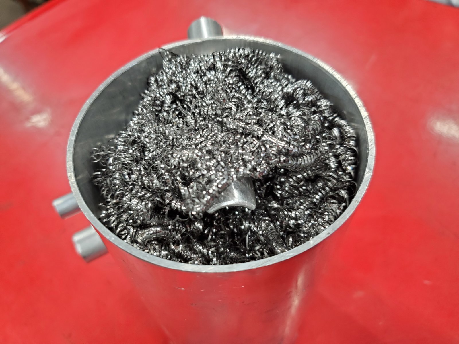

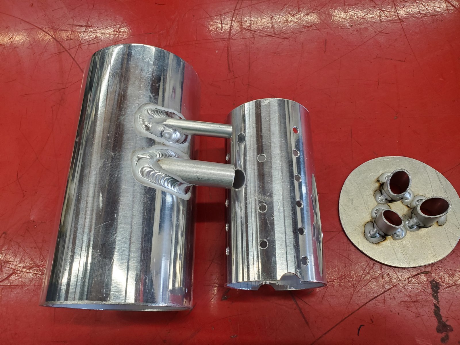

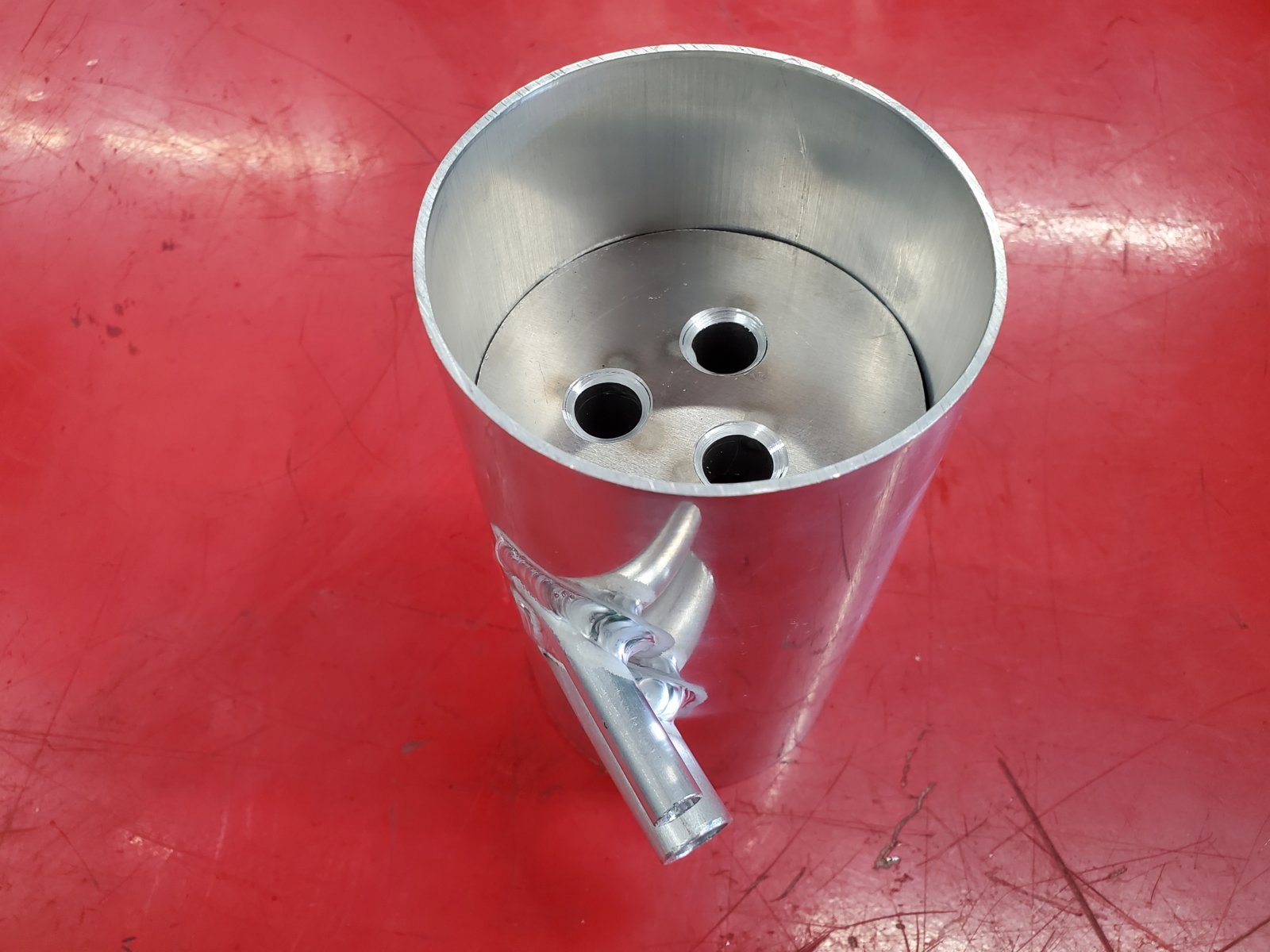

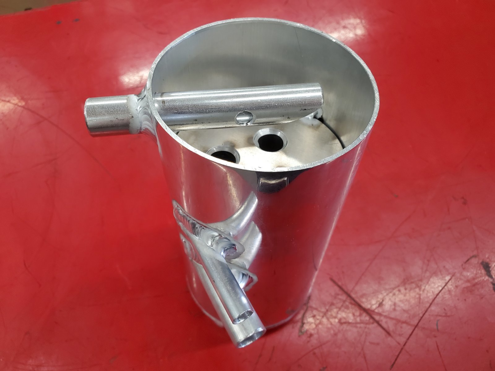

    Figured it was about time for a better air oil separator on my rig. This one should flow more and catch more than the quickie one I made awhile back. Just need some of that expanded stainless dish washing scrubber in the top before the cap and mount.

    Great job with the venturis and baffles.

    Thanks! Just trying to make the oil vapor hit lots of different surfaces while still maintaining air flow with what is laying around.

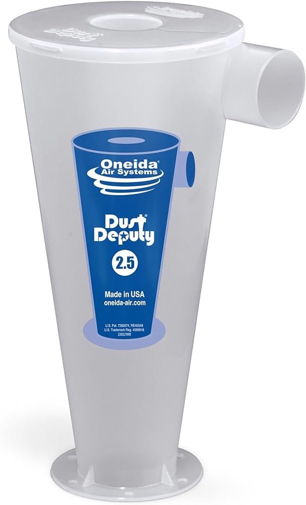

    I’ve got one like this on a 5gal bucket I rig up my shop vac. It collects maybe 90% of anything sucked up including water. If you’ve got the room to run something similar and scaled down I’d image it’d work wonders.

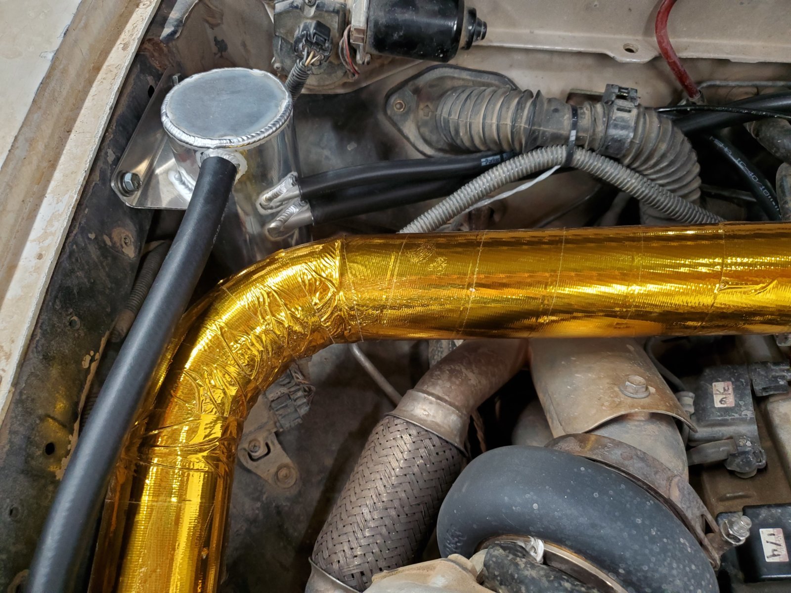

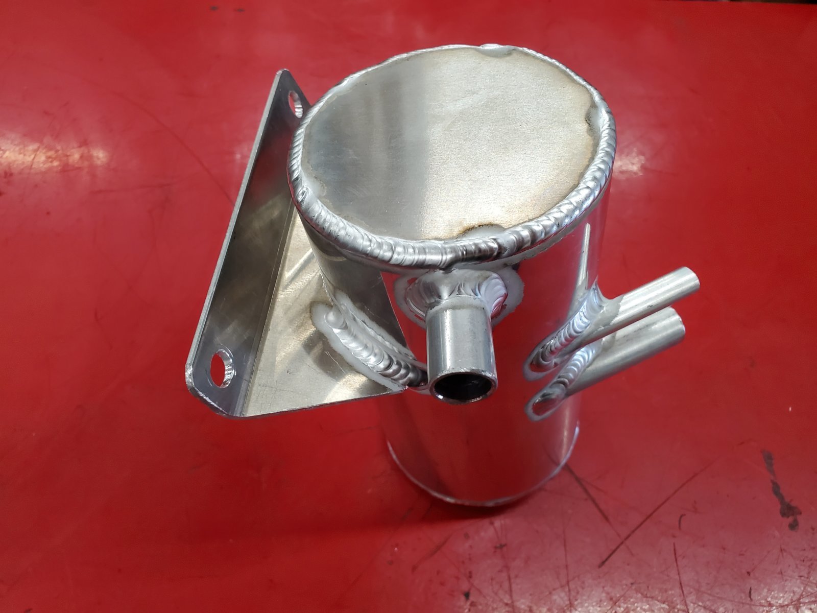

    Mine also uses the centrifuge concept, just more baffles after the fact.
    All done..

    Beautiful work!

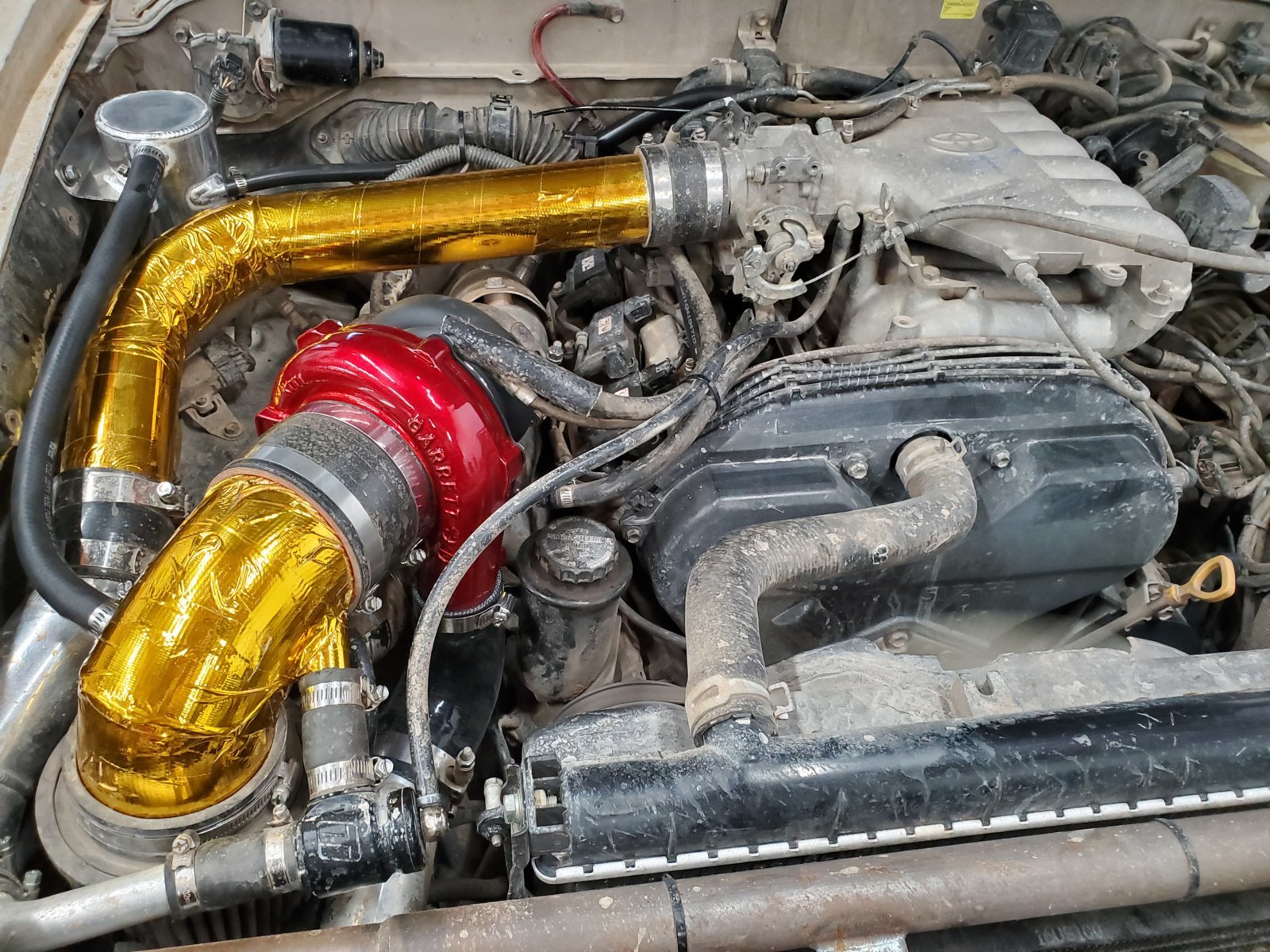

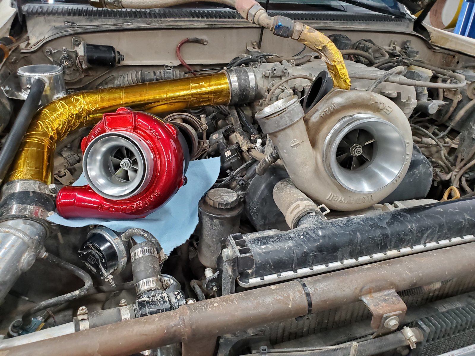

    Well, it rabbit holed.
    Had to take the intake off to weld the larger tube on for the catch can line. Figured while I had it off might as well throw the lil spoolie guy on there. Direct fit Gt3076r, just had to dent the oil drain tube a bit. Dang does it spool quicker! Nice little noise too.

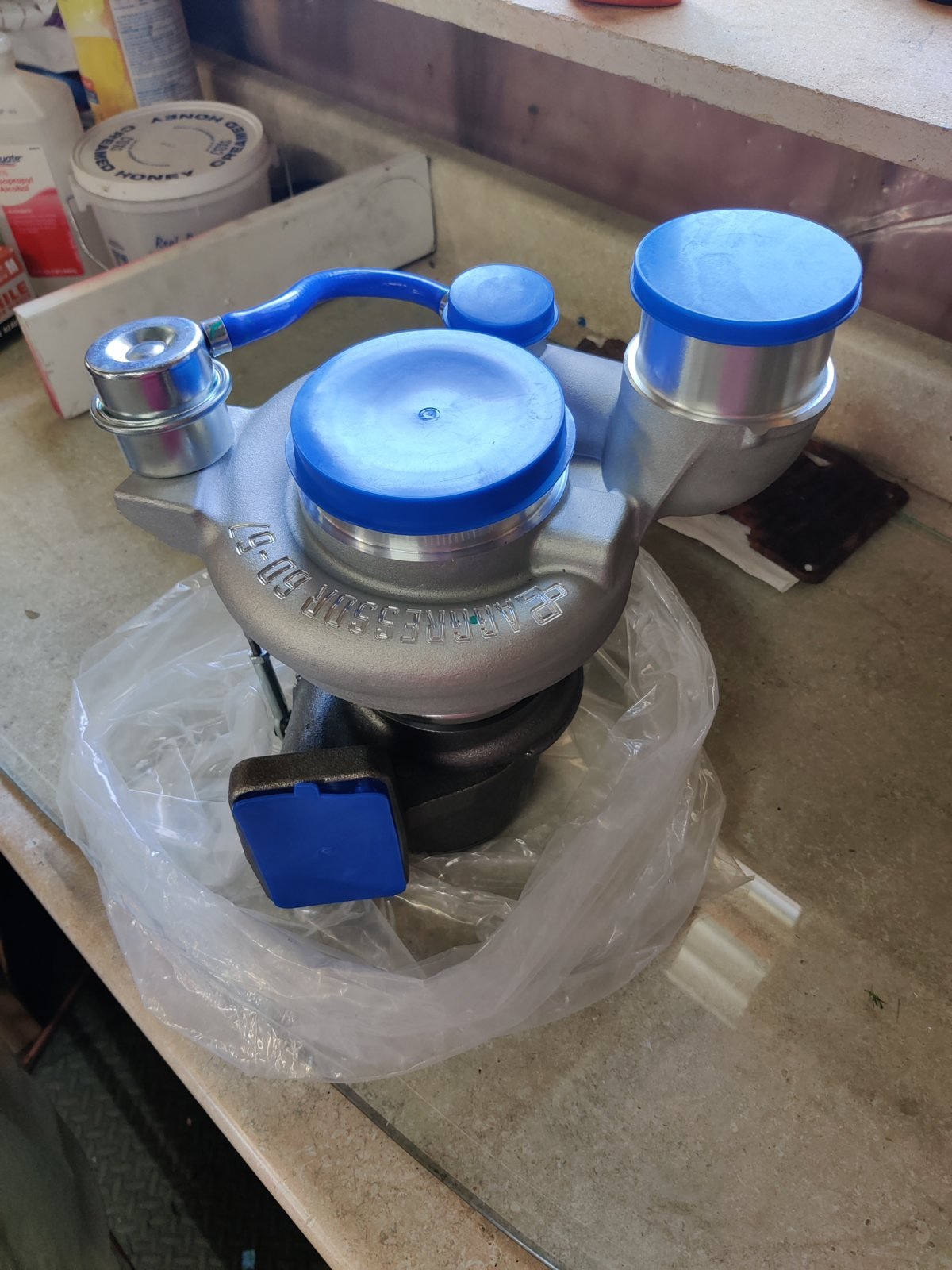

    Picked up some precious cargo for my dad's 3rd Gen Cummins today.
    Finally gave me an excuse to stop by the Power Driven Diesel shop less than a mile from my house. Those boys know their stuff
