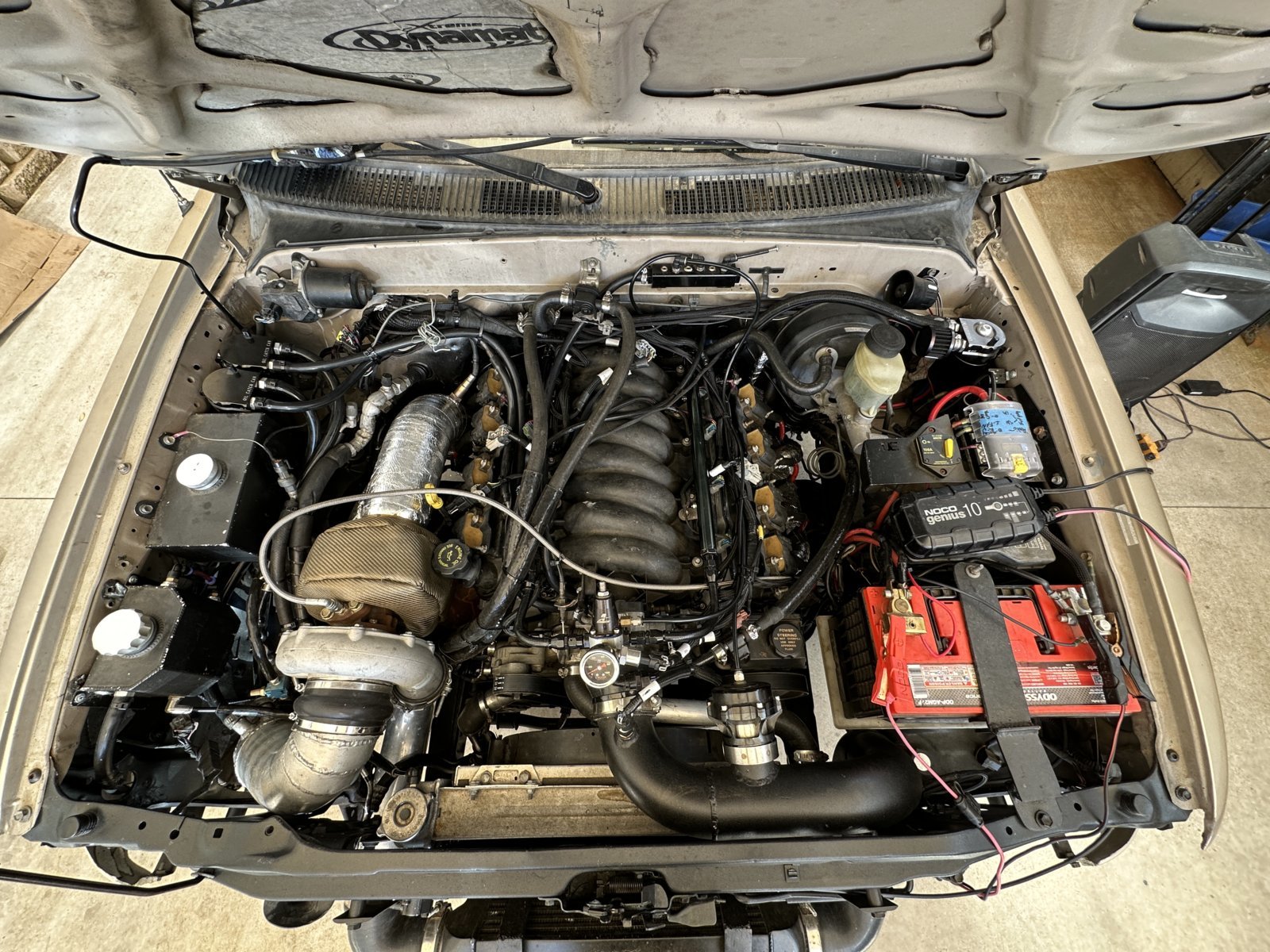

    IMG_3662.jpg Its me again, so since last time things have changed a bit, I ended up pulling the motor and building it with full forged internals and a stroker kit into a 6.3L and have about 60 miles on it. The added torque from the engine upgrade is quite substantial! And that is obvious when I am out of boost, I changed the WG spring since it came set at 12 psi and that was ridiculous not to mention dangerous since the tune isnt dialed in just yet and the fact that the engine is still in the break in period so I put the 3psi spring in and it was making about 2 psi max so I have swapped it out with the 6psi spring but I haven't given her the beans enough yet to see what it will actually make.
    This truck is so much fun! I really need to start gathering the components for the AWD setup sooner than later, and I still have to order a pair of turbos for my Camaro since I want to swap out the Centrifugal S/C it has currently so I can get more boost out of it, 16psi just isnt cutting it anymore.
    And yes I might have a problem, there is a really good reason for my screen name I cannot just leave things how they are for some reason, its nearly impossible to resist the temptation to upgrade things (As I eyeball my wife's Mazda CX-9 Turbo o_O) haha!!

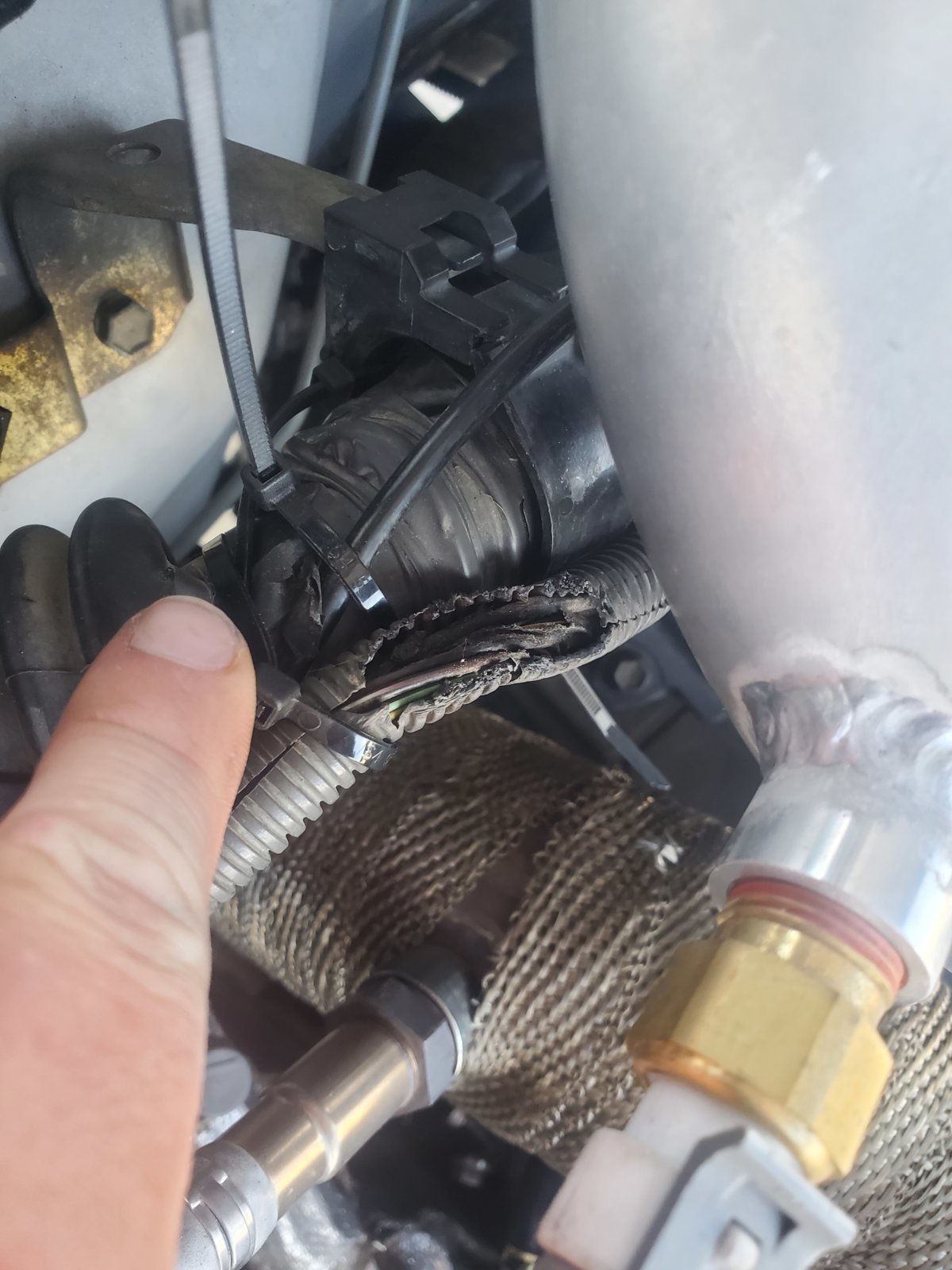

    Hey guys,
    I disconnected my battery last night to do some work. (I know it shouldnt flash my haltech)
    Never seen this before; my AFRs are all over the place since. Not feeling a difference in the drive. But spiking into the high 14s/15s at moments here and there. Been observing this all day. At idle it's low into the 12s and creeps up to the low 13s once stopped.
    I think im observing it if I give sudden WOT or throttle and don't politely increase throttle
    Not sure what happened or what's going on.
    I'm just getting home to plug into the ecu and have a look on the software so no update here.
    Boost leak? Dirty O2 sensor? Check vacuums? Input would be appreciated.

    Without more data my first bit of advice would be to just check the vac line running from the haltech to the engine

    Think I found the problem. Might of fucked up some wires. Found these fuckers laying on the down pipe

    That'll do it id imagine

    Pulled the sheath back. All the wires are clean/not burnt
