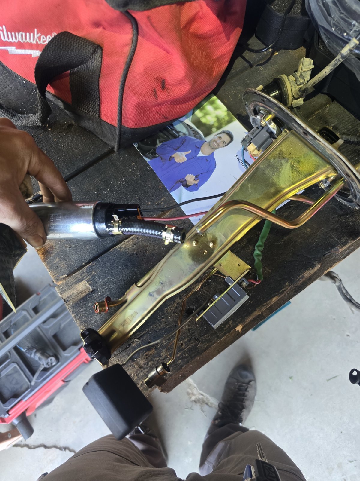

    Well, I think I found my problem... Pretty sure I hit the gas tank running up hamburger hill in Moab and dented it. It must have been just barely hanging on. 20240619_185300.jpg

    58,221
    FCQM+VG Cheney, Washington
    It's less Tacoma and more mod
    Ouch

    Appropriate placement of stock photo thumbs up guy :thumbsup:

    I do enjoy the easy fixes.
