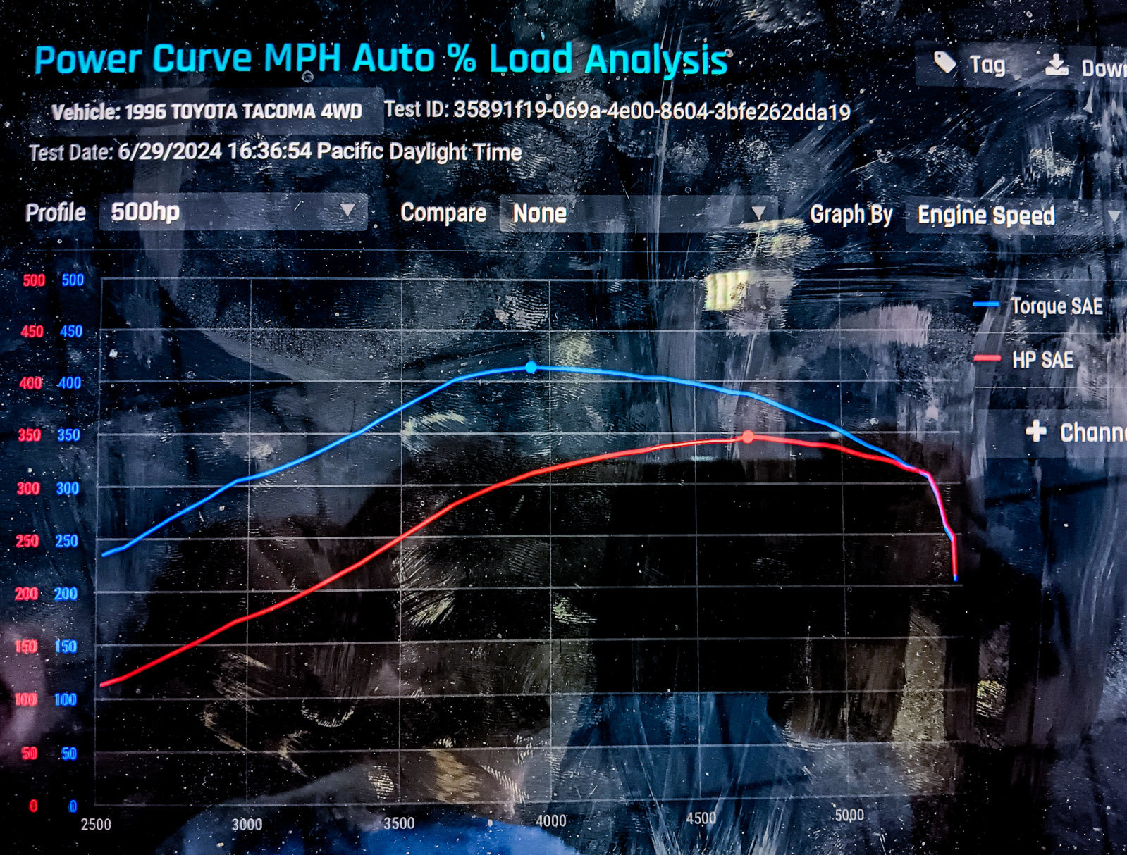

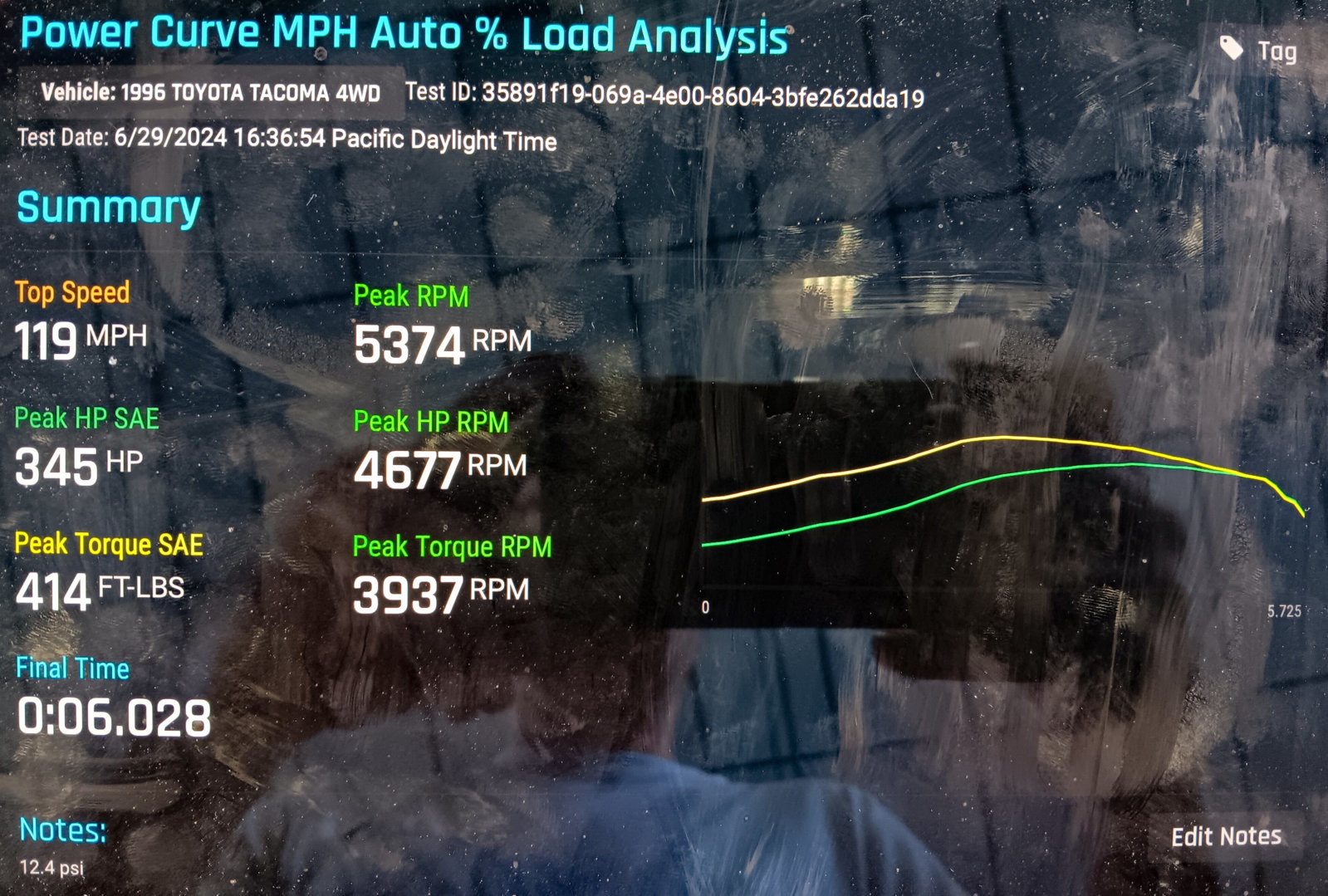

    I've decided to leave it there. I had previously been dailying it at 9-10psi

    I bet that surprised them a bit too! Bravo sir.
    If you watch closely, you can see the tire expanding with speed.
    Speedytech7[QUOTED] likes this.

    Thanks, yeah our Dyno operator was surprised too.

    That curve looks fun, and ~250 lb/ft at 2500 rpm is 1ge na numbers at the fly

    It's a hoot, definitely more power than I need but it's nice to cannonball up a mtn pass loaded up for camping without dropping out of 5th gear.

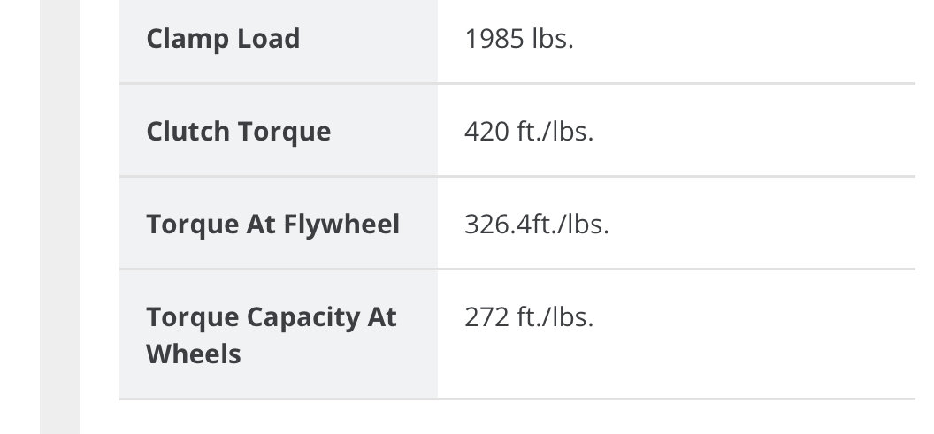

    @Speedytech7 Nice! Are you still on the exedy stage 1 clutch?

    Yup, still holding strong too, hasn't hinted at slip yet

    Wow, you really surpassed its advertised limits by a long shot

    Yeah, probably good it does rollers mostly cause from a launch I'd bet it would slip. Next clutch I'm getting from Clutch Specialties in GA
