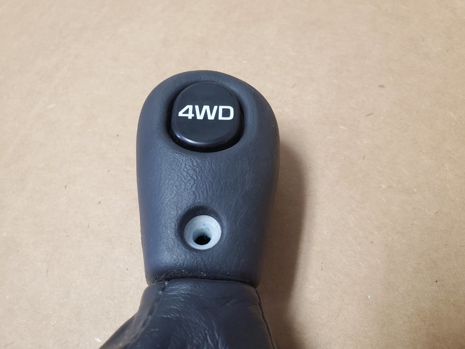

    Awd conversion??

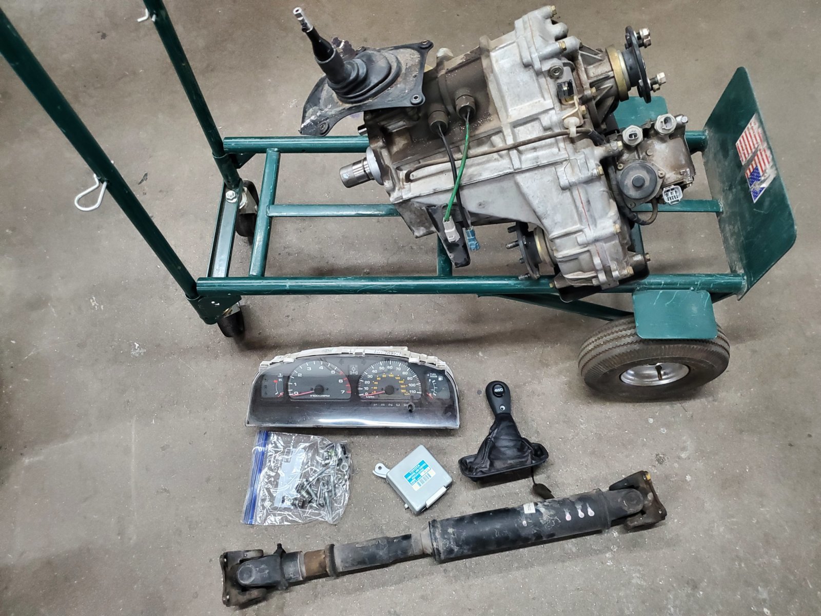

    Yep. Just acquired some of the goods today. Probably get a spare rear drive shaft so I can just swap it all in at once. Will build the wiring harness in a similar fashion.

    I don't really know much about the all-wheel drive systems on these trucks. Do you still have the four-wheel drive advantages and 4lo & such?

    Yes, all that. Check out Multi-mode transfer case. 2wd, Awd, 4hi, 4lo. Got this out of a Limited 4runner.

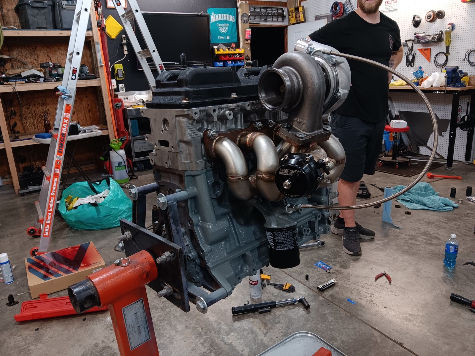

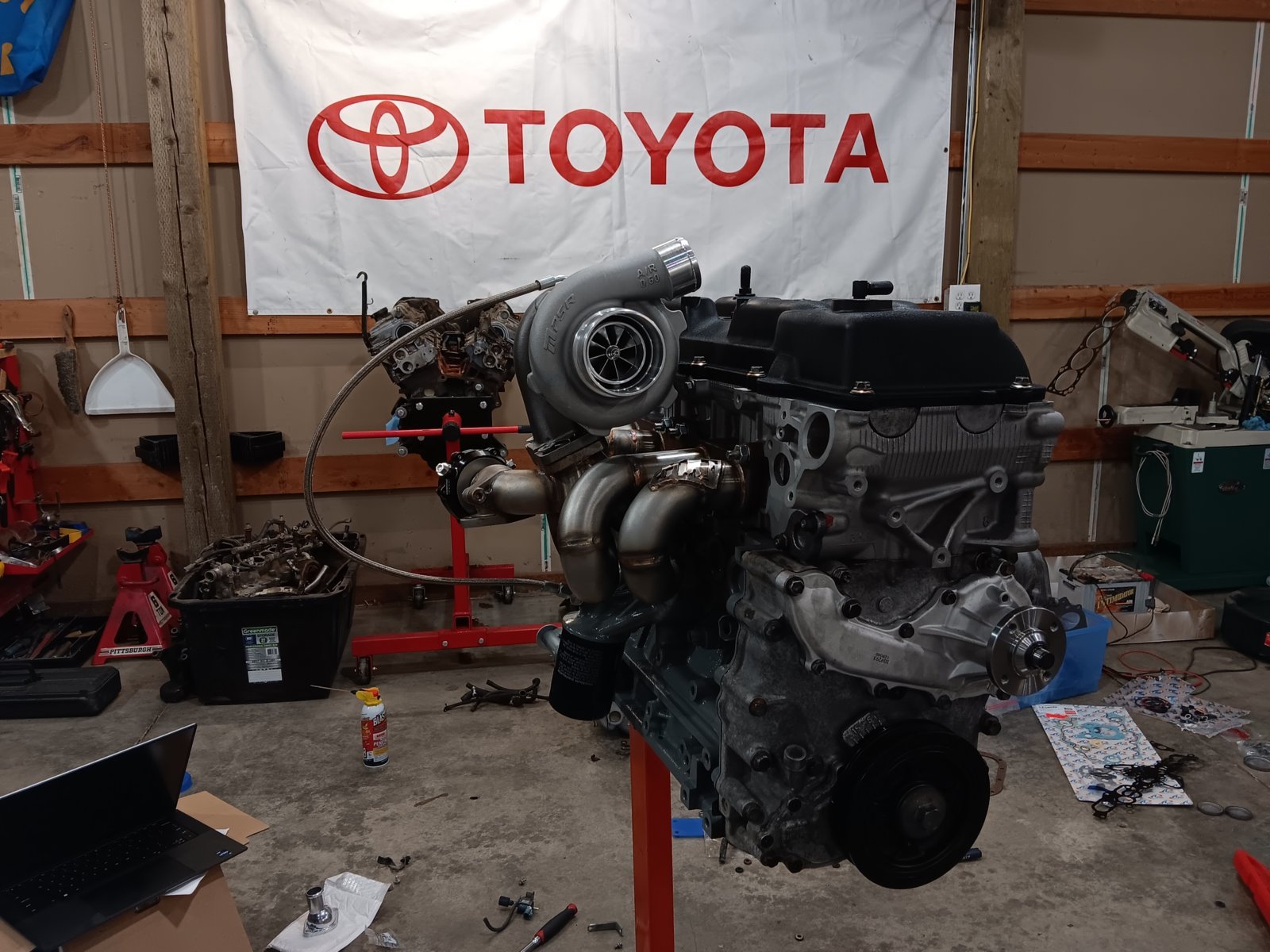

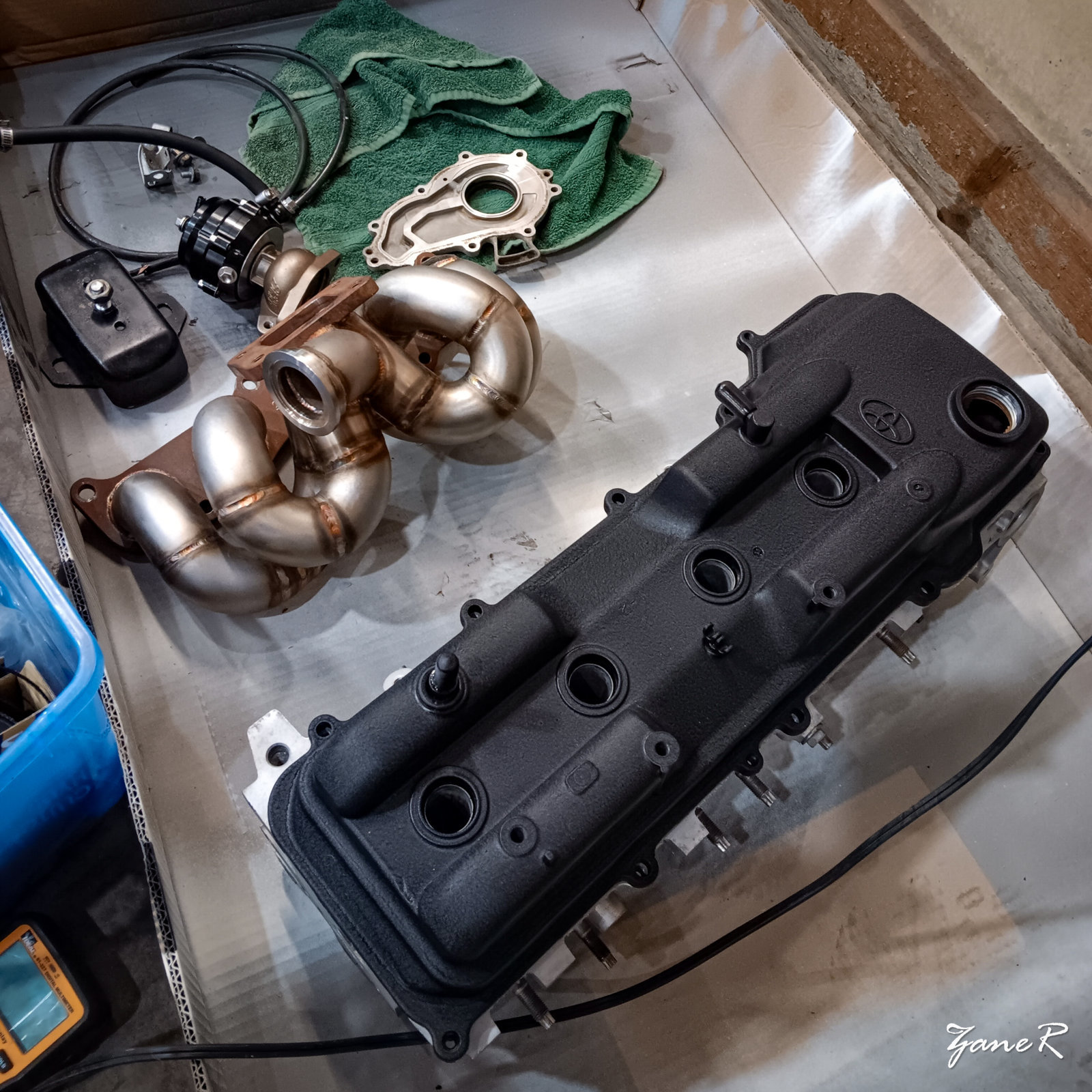

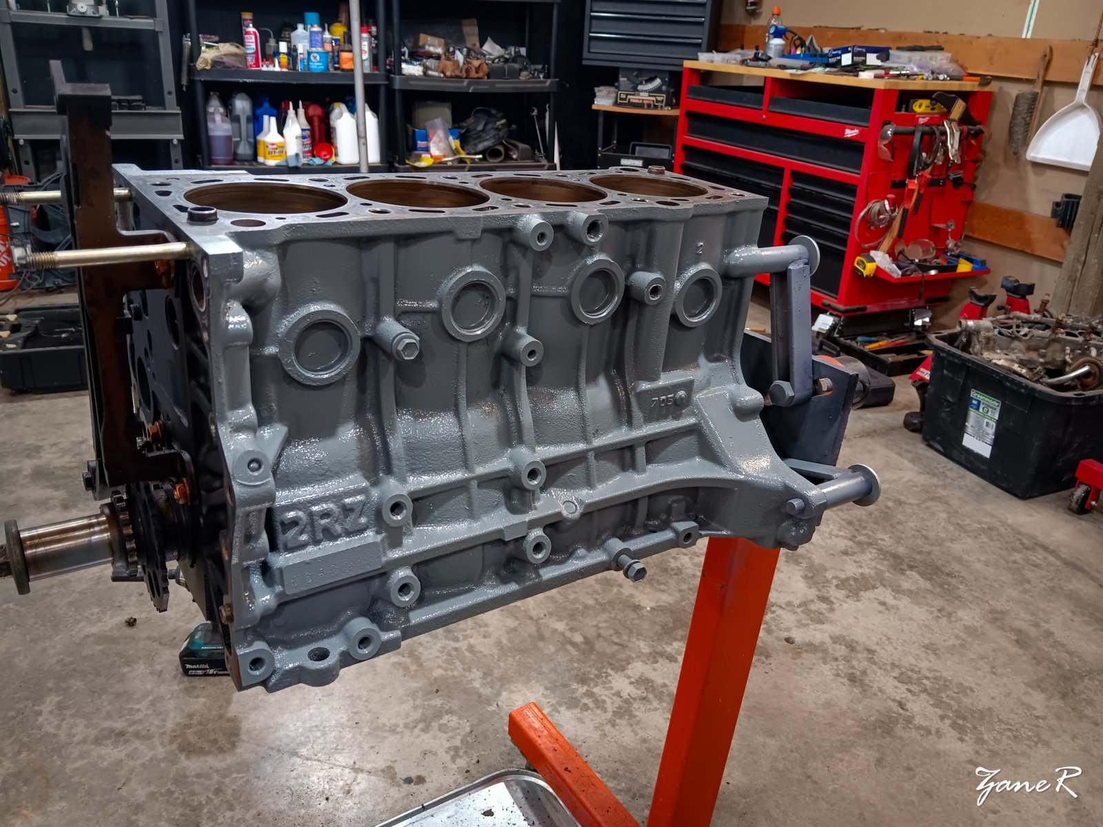

    This little beater is almost ready for its debut.

    Are you planning on doing anything different for the PCV system? What's your target boost?
  15. Aug 14, 2024 at 11:44 AM
    Speedytech7
    Feb 20, 2014
    #123587
    58,224
    FCQM+VG Cheney, Washington
    It's less Tacoma and more mod
    Yeah it's going to an open catch can on this one. Target boost at first will be 8psi. We are hoping to eventually push it to 15psi. But neither of us have fully tuned an RZ engine before so gotta work our way in.

    Air to water intercooler or air to air?

    This is most likely getting an air to air, we are still trying to figure out how to package it since it is going in a 91 Toyota pickup with a solid axle swap. If it ends up tighter when we thought it may get a water to air.

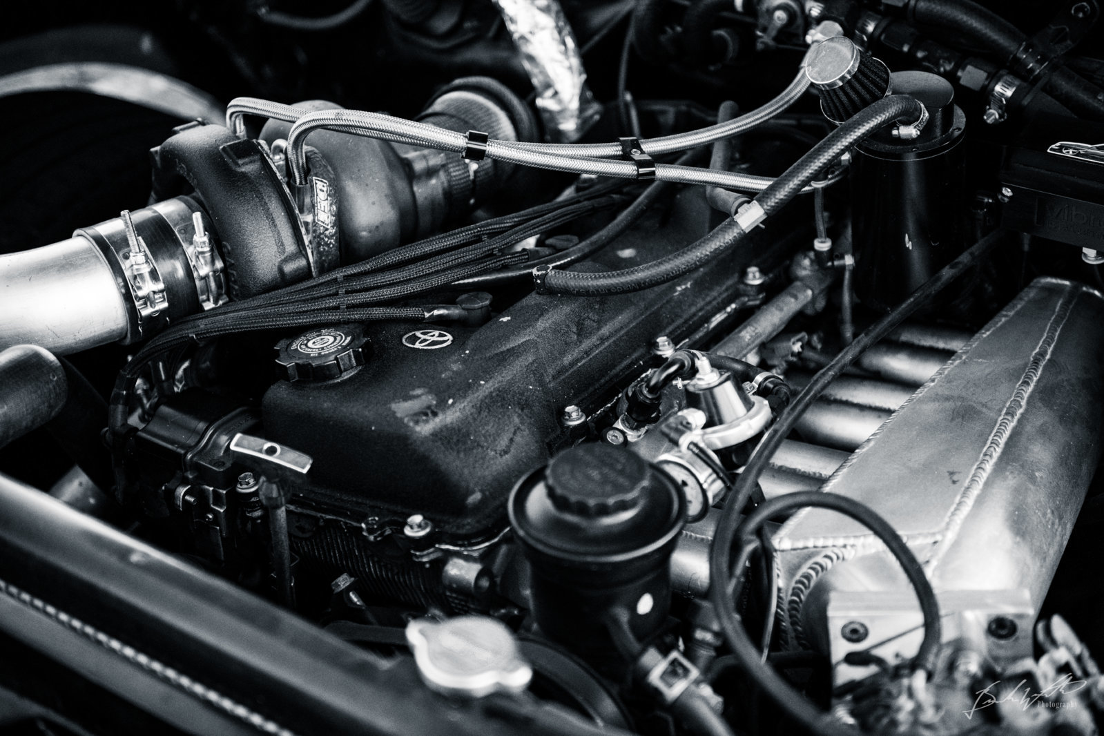

    Call me ignorant, but as soon as I pull my TB to valve cover line out it runs like poo. N/A at this time.

    Do you not cap the ends? So many questions.
