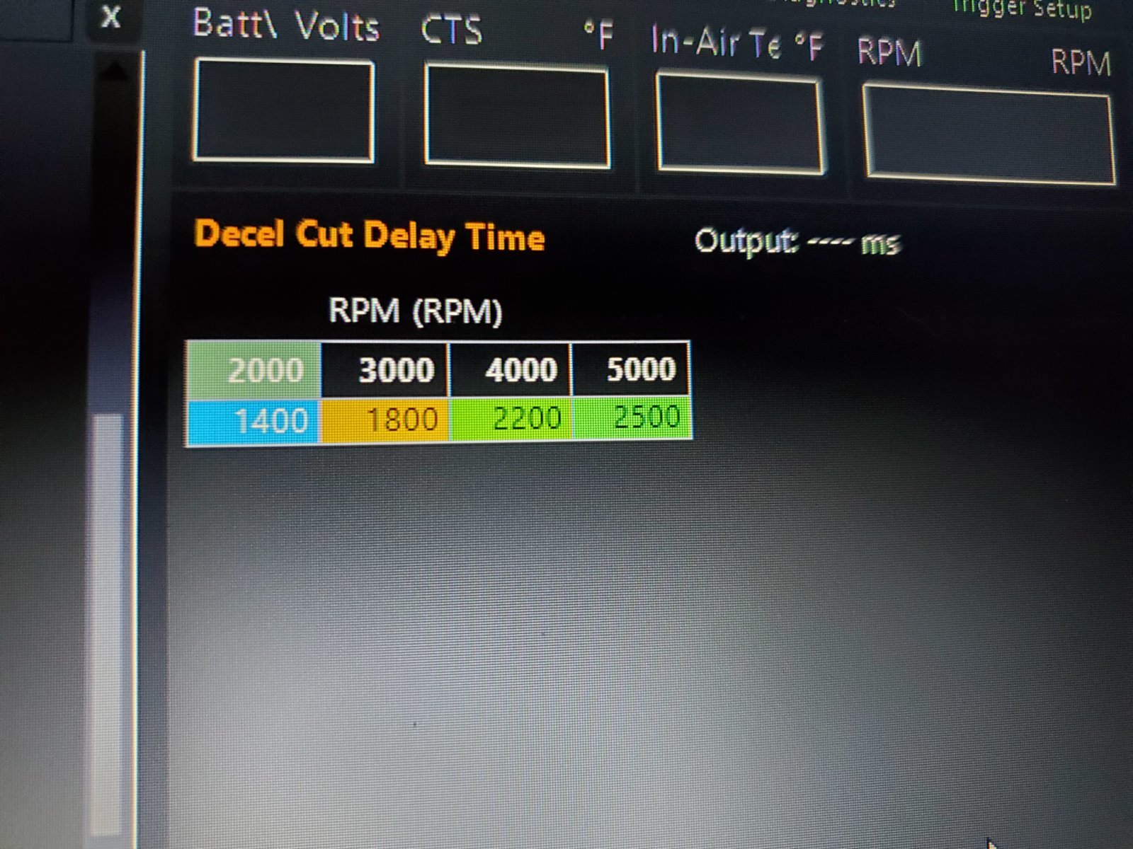

    I kinda had a similar issue. Do you notice it going rich (or anything else)? For me it was going rich in the situation you described. Long story short, try messing with Decel Cut.
    This is how it was set previously.

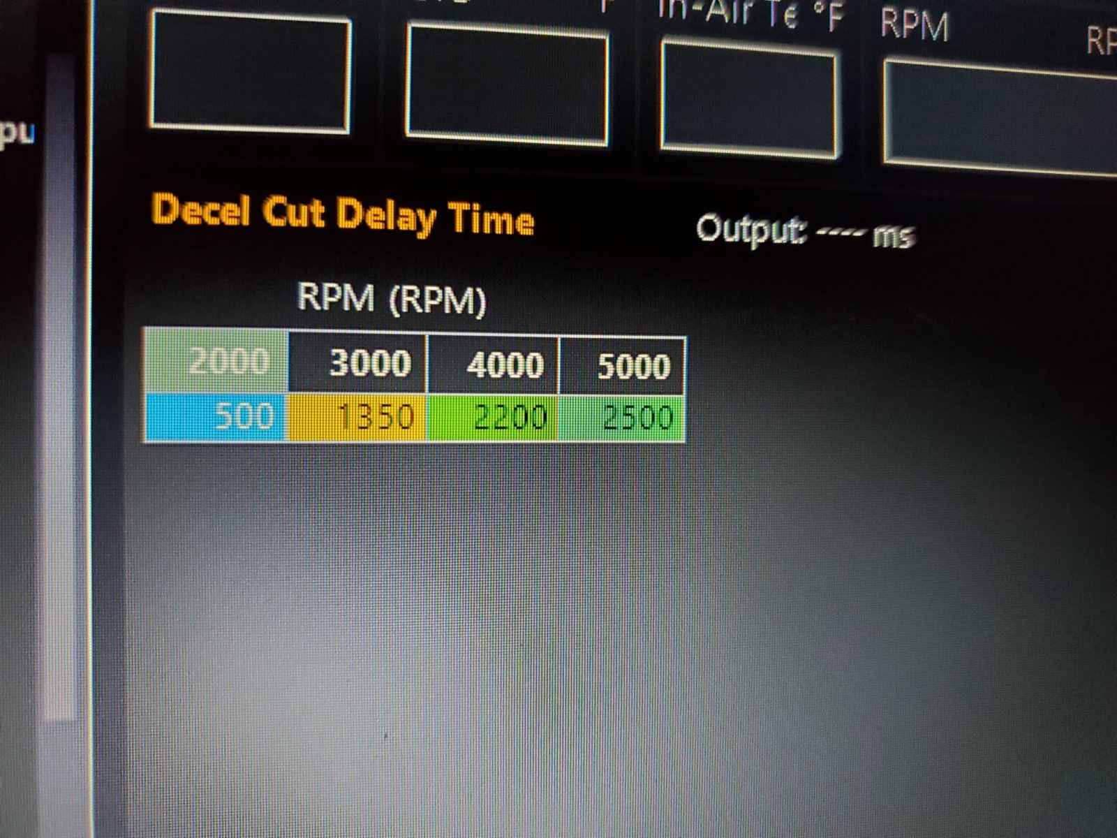

    After reading a hair they mentioned using lower numbers in the lower Rpms. This thus far has worked much better for me.

    I can sit here with my foot barely on the gas and ac on and it’s steady but as soon as I take my foot off and try to let it idle it starts acting stupid and jumping all over the place. Anyone have some pointers? I adjusted the decel fuel cutoff values to what @Jon64l suggested but still having the same issue
