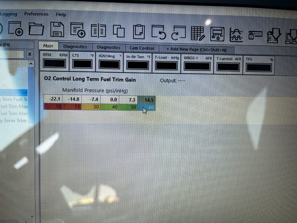

  11. Aug 21, 2024 at 5:29 PM
    BassAckwards
    BassAckwards Well-Known Member
    May 3, 2016
    #186002
    27,953
    2009 Tacoma AWD Turbo 2TR-FE
    Full-time AWD & BorgWarner EFR 6258
    These right? I did try setting the first two cells on the left to zero bc I thought this could cause it too, but it still did the same thing
  12. Aug 21, 2024 at 5:30 PM
    Speedytech7
    Feb 20, 2014
    #123587
    58,555
    FCQM+VG Cheney, Washington
    It's less Tacoma and more mod
    Yeah but that map is under defined. I built that map out with RPM and manifold pressure. I would probably take a log of what's going on when it's acting up so we can look at all the factors at once
