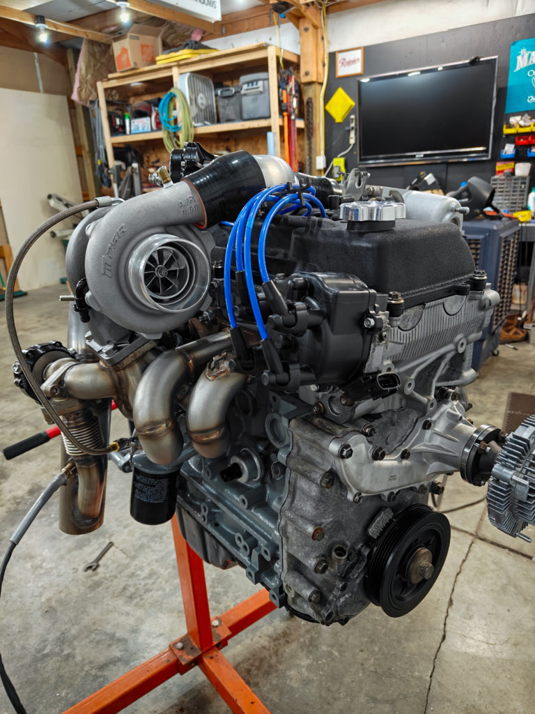

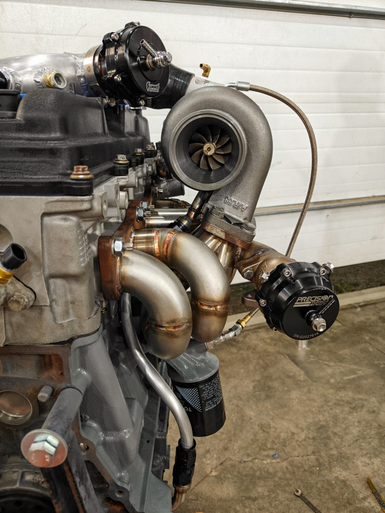

    Curious on what temps will be non intercooled out the gate.
    Nice pipe fitting and welding. That your handywork?

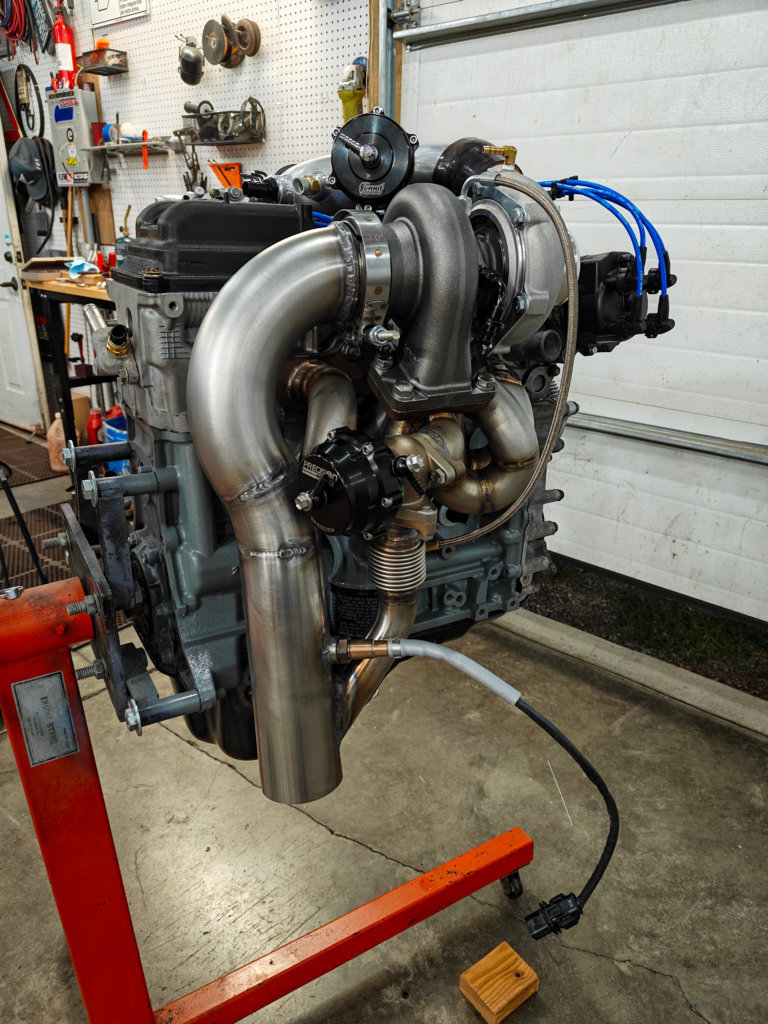

    That's my buddy's Jayson's handiwork, he loves exhaust work. We've been joking that we're putting way more effort in this truck than it is worth.
    So of course it's getting a full stainless 3 inch exhaust...

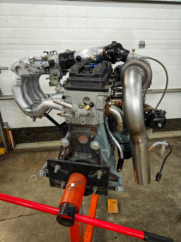

    Just got done with a test drive. It hits 3.5psi in 1st gear without even stabbing the throttle. So uh, yeah we are gonna need a bigger turbine housing haha.

    It's a Pulsar 3067 ball bearing turbo with .63 turbine AR. Might need a .82 though haha, it's a bit too spool happy

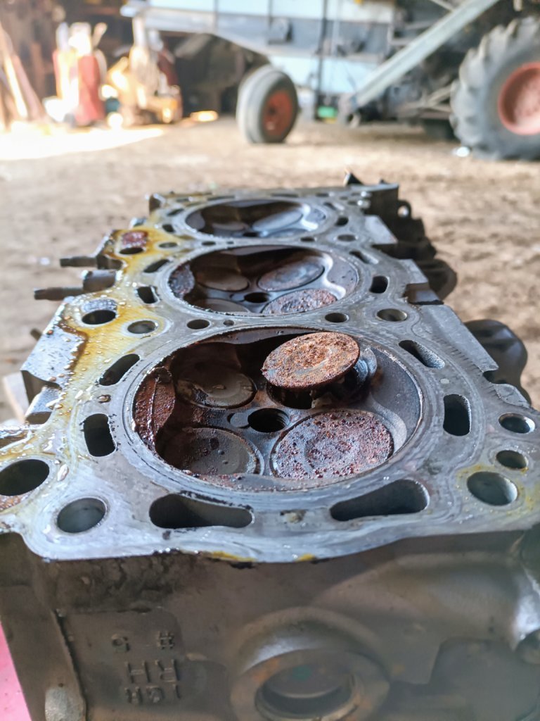

    Compression is pretty low for some reason

    Less likely to detonate.

    Did it take a drive in the ocean?
