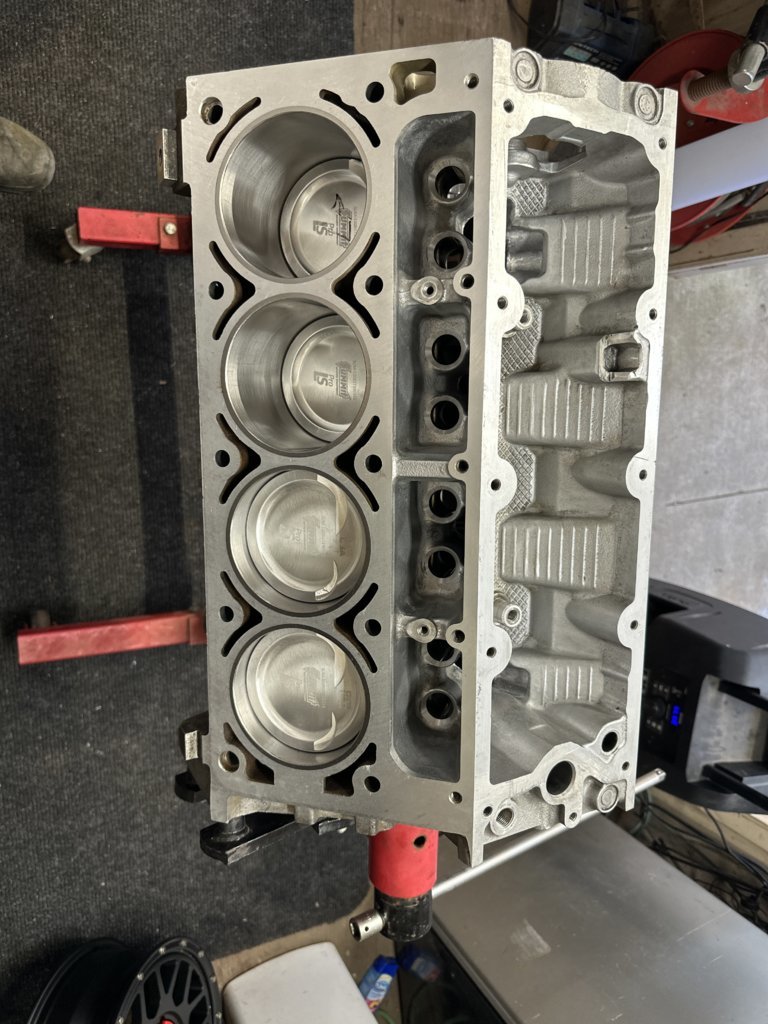

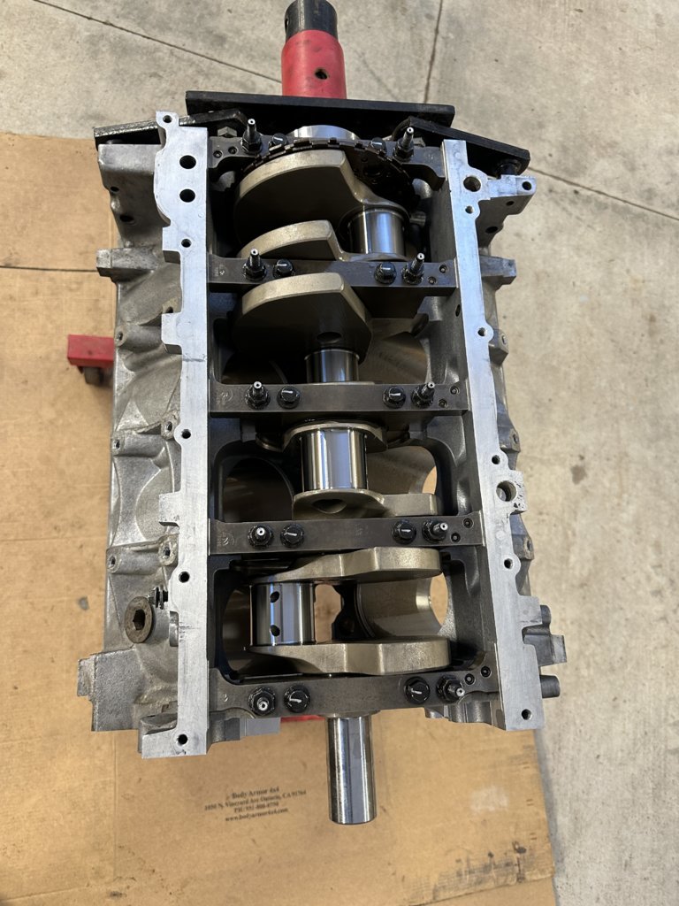

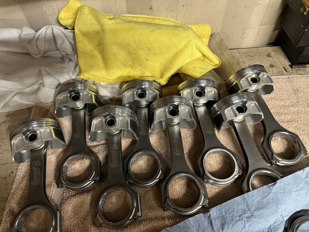

    Well, I decided to go ahead and forge the setup so I can finally turn as we all will eventually! Don't lie to yourself guys, we have all either been there or will be there sooner than later, yes that means ALL of you reading this. or you wouldn't be in this sub-forum.
    I went from a 5.7 (LS1) and figured I might as well go ahead and stroke it while I'm in there since the cost of a forged rotating assembly is negligible in cost. and it needs machining anyway so why not! The new setup increased it to a 6.3L or a 383ci. so not its got a ton more torque at the cost of RPMs but that way it "should" live longer since Im not spinning the balls off of it to make power.

    What's your final drive ratio? With that added torque, it is going to be a tire ripper more than ever.

    Indeed it will, it is a big difference in low end torque. Almost acts like an I-6 engine as far as Tq. curve goes. I think Im running a 3.7 gearset. At 80mph Im still under 2K IN 6th gear with a T56, 6th gear is .50 to 1 so a double overdrive is nice if you have the power to carry it in the lower RPMs.
    And I meant to say turn it up! Sheesh, words matter.

    That's the ratio that we put in my friend's BRZ with the 6.3L. Not sure the weight difference between yours and his, but man his still rips through the gears. Easy enough still to take off in 3rd if he wanted. I think his engine is around 430 brake torque, N/A. Which I imagine yours will be near that ball park.
    8 psi should get you around 630-700 whp.
