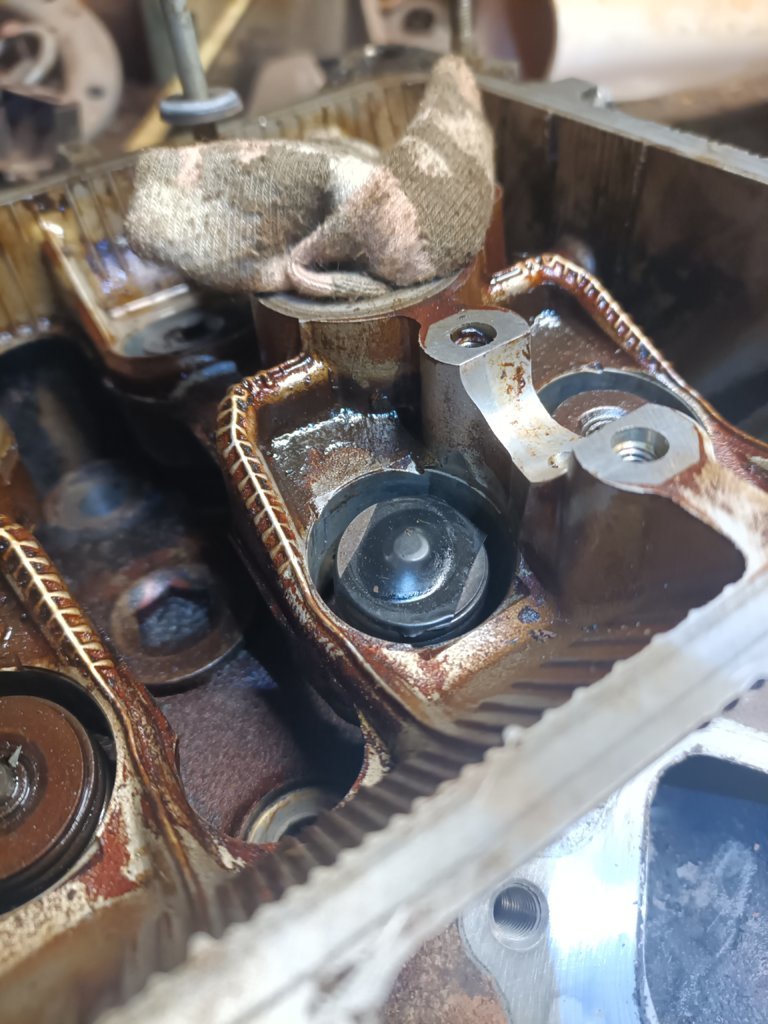

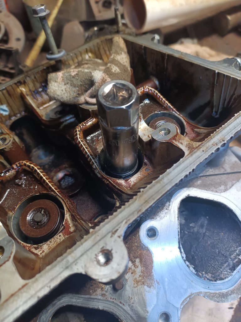

  8. Nov 29, 2024 at 12:30 PM
    yota243
    yota243 Well-Known Member
    Aug 22, 2012
    #85267
    21,655
    E.J.
    north Alabama
    turbo 05 prerunner trd off road DC
    Bw s256 turbo with 3 in glass pack dumped pre axle raptor liner bed and top rails and fenderflares and rocker panels. Hunter side steps. Plasti-dipped upper fenders and emblems. satin black spray paint here and there inside and out. 5100's set to 1.75" up front . C channel front bumper. Maxxis bighorn 255/85/16
    So if you don't have the right tool... But you have a socket a hammer some electrical tape, you can remove and reinstall valves. I knew I could get that stuck valve out; I cleaned it and put it back in, and it moved freely. I had to do a little thinking and trial and error to get it back with those keepers. I'm just gonna start putting everything back together (if I can remember where everything goes, and hope for the best)
    IMG_20241129_105331_416.jpg IMG_20241129_105319_477.jpg IMG_20241129_105444_724.jpg
  9. Nov 30, 2024 at 8:51 AM
    Speed Freek
    Speed Freek Tacoma Whisperer!
    Dec 17, 2008
    #11676
    4,739
    Jason
    Vista, Ca, Lake Havasu, Az.
    98 Tacoma V8 (LS1) swap
    LS1-T56 swap, Z06 ported heads, cam, Titanium valves, Kevlar clutch. Now building a forged stroker (383) and all the ponies! Old setup was rod-knockin on heaven's door...
    That's how I take the keepers out, I just put a rag under the valve face to help it stay put and give it a whack with a mallet on top of a socket and they pop right off. Well I would do that when I didnt have an actual spring compressor handy, getting them back together is a bit trickier without the proper tools.
  10. Nov 30, 2024 at 10:33 AM
    yota243
    Aug 22, 2012
    #85267
    21,655
    E.J.
    north Alabama
    I was surprised how well that worked, the electrical tape had just enough stretch to let the stem come through the retainer and bounce the keepers back in place

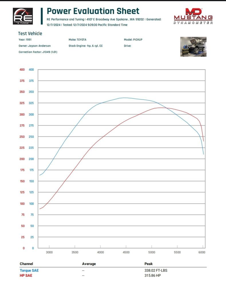

  15. Dec 9, 2024 at 6:49 AM
    Speedytech7
    Feb 20, 2014
    #123587
    58,552
    FCQM+VG Cheney, Washington
    It's less Tacoma and more mod
    Went back to the dyno with my buddy this weekend. Graph has my new power superimposed over the old. Not too shabby for a mostly stock 5VZ eh? Thing just wants to make torque all day
    Brake Weight, Torspd, Brice and 7 others like this.
  16. Dec 9, 2024 at 11:12 AM
    MadTaco461
    MadTaco461 BRO runner
    Dec 30, 2009
    #28470
    13,436
    CA
    99 turbo 5 lug long travel
    Kinda stock
    That's stock block. Still for some self tuning that is great power.
    Torspd and Speedytech7[QUOTED] like this.
  17. Dec 9, 2024 at 11:15 AM
    Speedytech7
    Feb 20, 2014
    #123587
    58,552
    Stock engine minus injectors really, same head gaskets it came with in 1996 even haha. Tuning credit goes to @2RZNoShi1, he had things to contend with for sure like keeping the head gaskets and rods in it (little power dip nearish to peak cyl pressure/torque) and my peaky boost control. He had his turbo 2RZ build there as well. I'll let him post the graph for that.
    Torspd and MadTaco461[QUOTED] like this.
  18. Dec 9, 2024 at 11:25 AM
    MadTaco461
    Dec 30, 2009
    #28470
    13,436
    CA
    Kinda stock
    That's still awesome. Not many people get that much power on the stock motor.
  19. Dec 9, 2024 at 12:13 PM
    2RZNoShi1
    2RZNoShi1 Well-Known Member
    Sep 15, 2024
    #457068
    162
    Jayson
    91 SAS Pickup
    Turbo 2rz swap Haltech 750 3067 pulsar turbo 750cc injectors Solid axle swap 5.29 gears with 35's
    Once we get @Speedytech7 onto a 3 port boost controller, I'll have a much easier time fixing that peaky boost. It takes so much time to get any changes dialed in to be consistent because the resolution is WAY too high on the control. Makes it very reactive. I probably would have been comfortable adding a bit more boost and ramping up the timing way up too a bit more if the boost cooperated better, but still pretty happy with the improvements overall! My turbo was a little lazier with the 3 port since it takes a lot more duty cycle to change the boost, but made for a really smooth graph. Turbo 2rz-fe on 15psi(peak, more like 14.7 average)
    Torspd, PhoS, jubei and 5 others like this.
