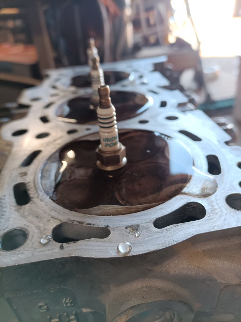

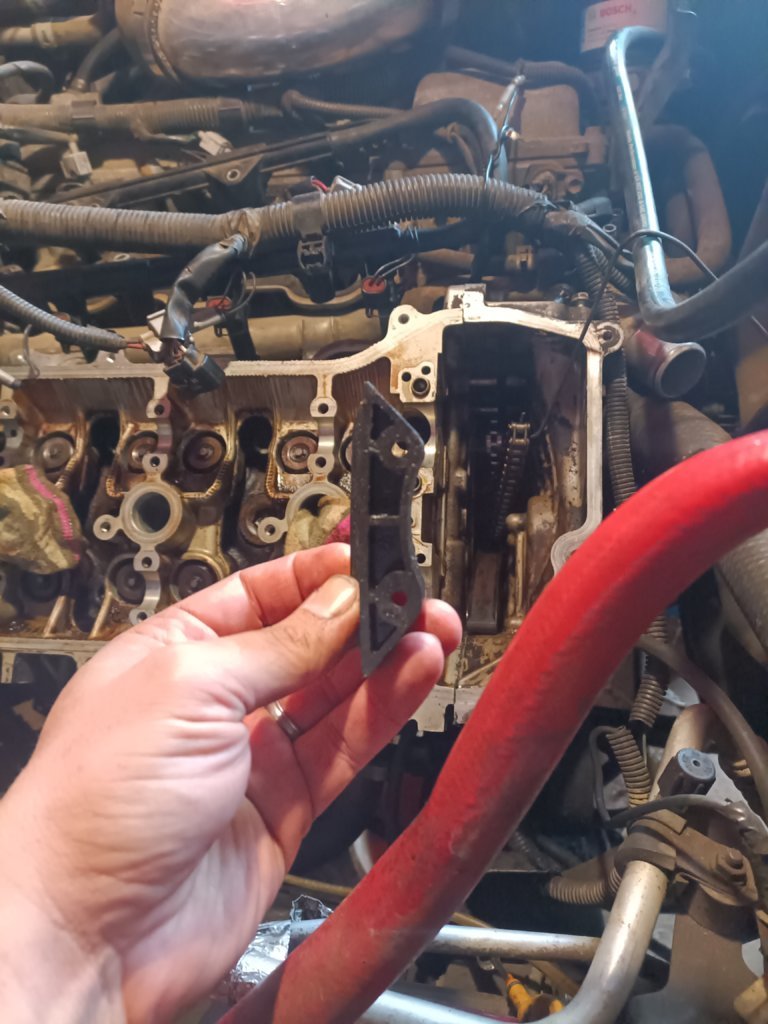

    Got the head back on and torqued, then I found this guy...IMG_20241226_152612_019.jpg

    Is that a tensioner?

    Well it's stationary; it goes on the two pins you can see behind it and to the right. I suppose it's more of a guide as the part that actually applies tension is opposite of that in the cover... But I dunno what it's proper name is

    Have to pull the timing cover to get to where that guy goes.

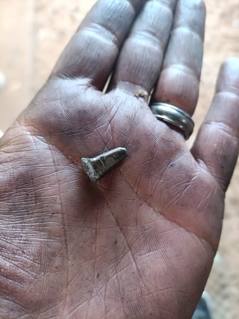

    That's what you think... I just pulled the head again. Now the game we are playing is, where did this tooth come from? I'm afraid I'm about to burn this thing to the ground...IMG_20241227_151929_058.jpg

    Aluminum or steel?
