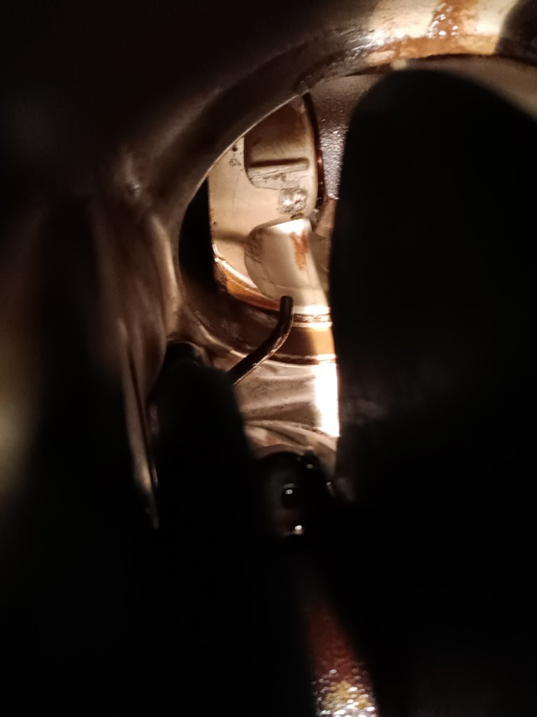

    Good question, its cast so I assume aluminum, but I didn't try a magnet came out when I was trying to get the timing chain lined back up after letting a little too much slack fall down. I assume it's off a bank two sprocket

    13562-31010 DAMPER, Chain Vibration

    Doesn't really look like a tooth to me, they have square flat edges. Anything missing from the big chain sliders?

    Dunno how I missed this the first time, but it appears piston #6 has had better days. Looks like a small crack and a little contact with the counter weight, enough to prevent the full rotation of the crank... So the driver side head is coming off now.

    Bent rod?

    Has to be. Great find.

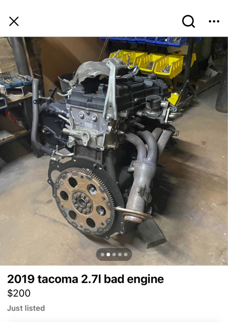

    Are you planning to build an additional engine?

    My new truck has the V6 so no swap, but go through it and resale. I bought lots of shiny tools the last time, no use in letting them sit.

    There's actually an extended cab with powertrain yanked and left, front fender damaged for sale for like $1500 (EVERYTHING else intact). I'm thinking could put this in it, I've got a 4x4 trans sitting for a auto swap I never did. $2500 in I could make a penny.
