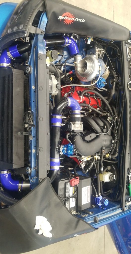

    For that matter, I have been reluctant to push past 18 psi on my OEM plastic manifold.

    Due to the ACIS flap only being held by two small screws into a plastic shaft, coupled with what I had heard a lot of from other Japanese branded cars with plastic manifolds, I just wanted to error on the cautious side. I have never had it pressure tested.

    Those are some pretty high compression ratios you'd be approaching. I think the HG gonna be your weakness up there. Assuming you don't have like O rings done? 20psi is probably more realistic. Did you do anything to the heads?

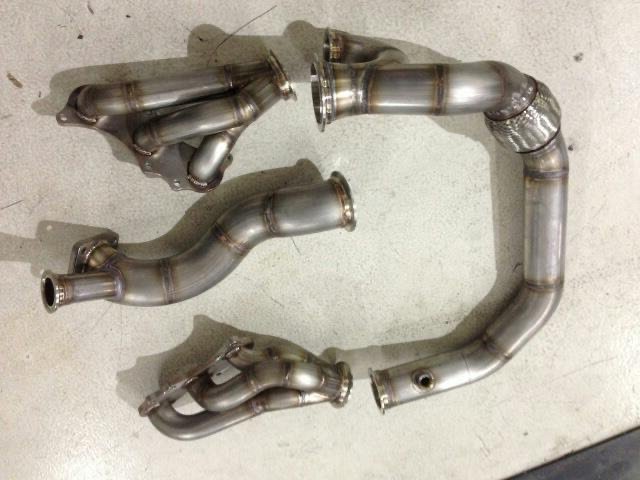

    I've got Cometic gaskets made for my 96.5mm pistons. I wasn't sure if you could o rings these motors with the darton sleeves installed, has anyone done it? So 20 psi is realistic with the plastic manifold. I have an extra one we could pressure test sometime at a buddies shop lol. I talked to a guy in New Zealand last year that was willing to make custom aluminum manifolds for $1500.

    I'm the 3rd owner of this setup with some changes to it. The pipes I've been told were made by Powerfab performance in Texas.

    My old friend Alex's handy work.
