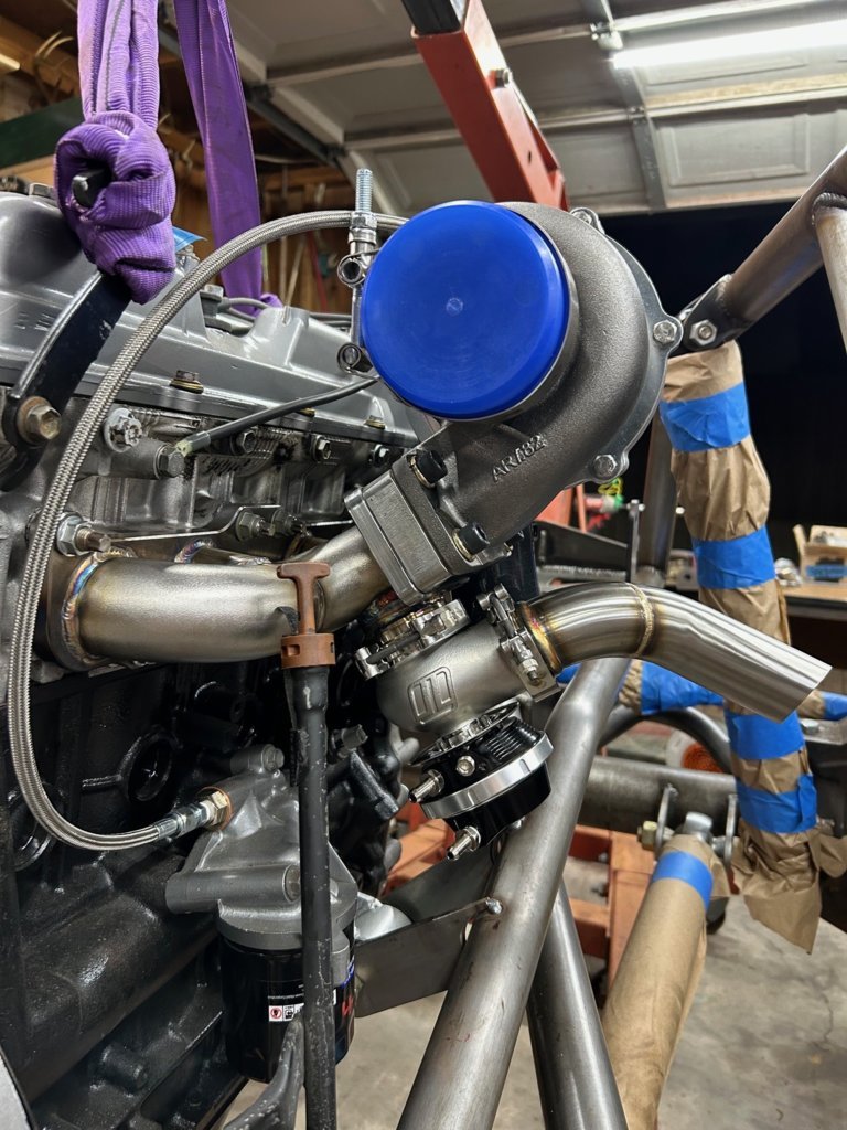

    I think it may work out with the 2.7 reducer to the 2". I should be able to sneak the intake tube behind the radiator, clearing the SPAL fan and in front of the accessory drive. I need a few more pieces to show up. The 3071 came in last week and the GLFab manifold came in yesterday.
    Got it mocked up last night, added a yellow 5lb spring to the WG to bring the pressure to 12psi. Spacer on the flange is in to clear the coil packs in front of the air filter.

    Id suggest a 5psi spring and a 3 port boost controller to turn the boost up to 12psi. That way you have an easy option to turn it down. I run a 5psi spring in mine and easily turn it up to 15psi

    Dec 7, 2009
    #27162
    1,396
    Houston
    I have a TS manual boost controller as well. I'm still a ways off from firing this up, but I can definitely remove a spring and plumb that in easily.
