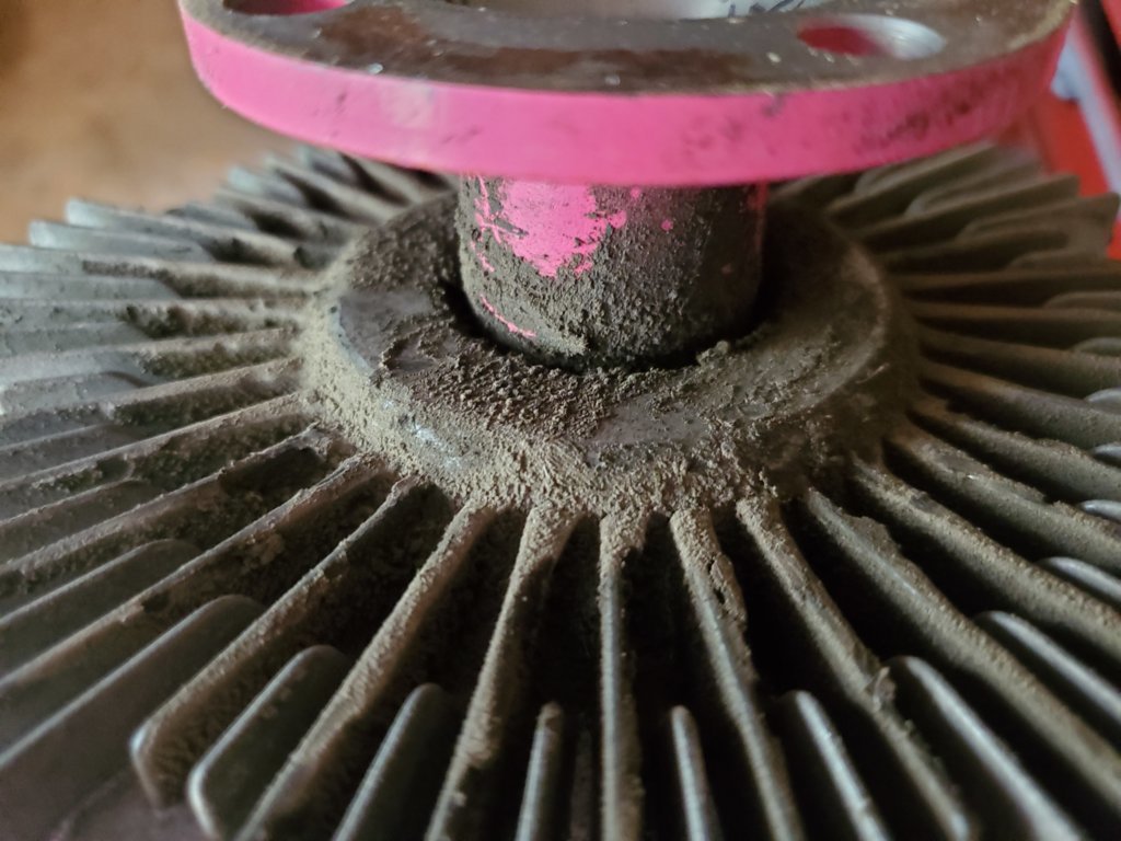

    I appreciate all the feedback on this. I just realized maybe the fan clutch is going out. Havnt seen the guage move.
    I just compared spinning the fans between my 4runner (very cold Ac) and the 2nd gen taco, taco spins much more freely. This is probably the problem.

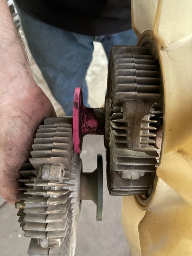

    So I just swapped the fan clutch out with one from a 5vz. Same bolt pattern for fan blade and mount. Only physical difference is back spacing. 1gr is about 1/4 or so longer.
    Ac feels way better at idle so far. Not a perfect comparison because sun went down. The old clutch was definitely loose compared to the "new" one. This atleast gives me time to get fluid for the old one. IMG_3443.jpg

    No signs of the fluid leaking out?
  13. Jul 2, 2025 at 7:49 AM
    Jon64l
    Jon64l Well-Known Member
    Jan 12, 2016
    #174799
    1,649
    Jon
    2000 4runner, 1996 Tacoma
    I suppose there is..

    Further inspection should show more.

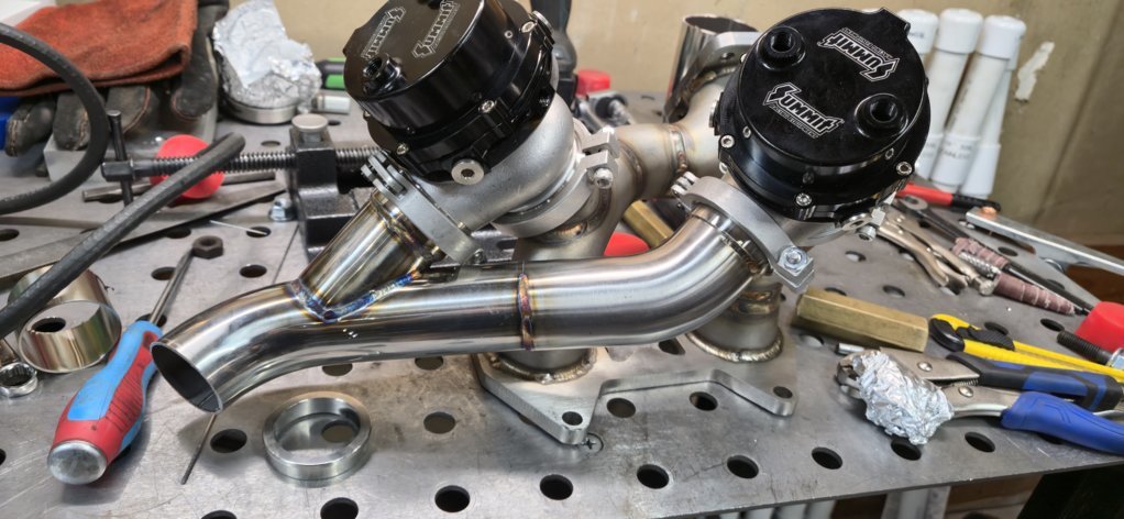

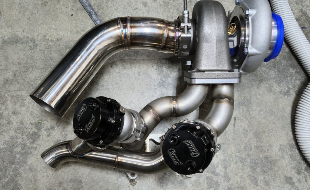

    Made more progress on my t4 divided single turbo setup for my RX7 yesterday. Pretty stoked on how it's turning out. Next week back on the Tacoma turbo setup!20250703_182859.jpg 20250703_182406.jpg

    Google for “fan clutch fluid mod for Land Cruiser” or something like that. Should have several old threads pop up on ih8mud. They use the silicone base shock/diff oil for RC cars to play with viscosity to alter fan speeds. Mine was gettin my weak several years ago and I put in a few squirts of Danco silicone sink lubricant from Lowe’s. Problem solved. It definitely sounds louder than before adding it. Maybe should’ve done just one squirt.
