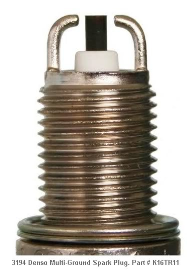

    With a twin ground plug below, the idea is the spark will jump to the closest ground, as that ground wears out, it will start jumping to the other, basically choosing the path of least resistance. Its possible that it can jump to both depending on the amount of power send by the coils, but generally speaking it will choose one side or the other. This should double the life compared to single ground. They are not common and basically designed for engines like the 5VZ.
    When coil on plug was first developed, it was very expensive. So to get the performance without the costs, manufacturers only put coils on one bank of the engine with a wire to the other side. The two corresponding cylinders that shared a coil were in sync and the coil sparked every two strokes, on both cylinders (2 and 4 or compression and exhaust stroke).
    Of course this halved the life of the spark plug so it wasn't too expensive to add a second ground to the plugs. Coils eventually became affordable enough to have then on all the cylinders so the age of the twin ground plugs was short lived.
    Now there are some fancy pants multi ground plugs, primarily made by Bosh, that magically increase power, MPG, and penis size. Don't run those.
