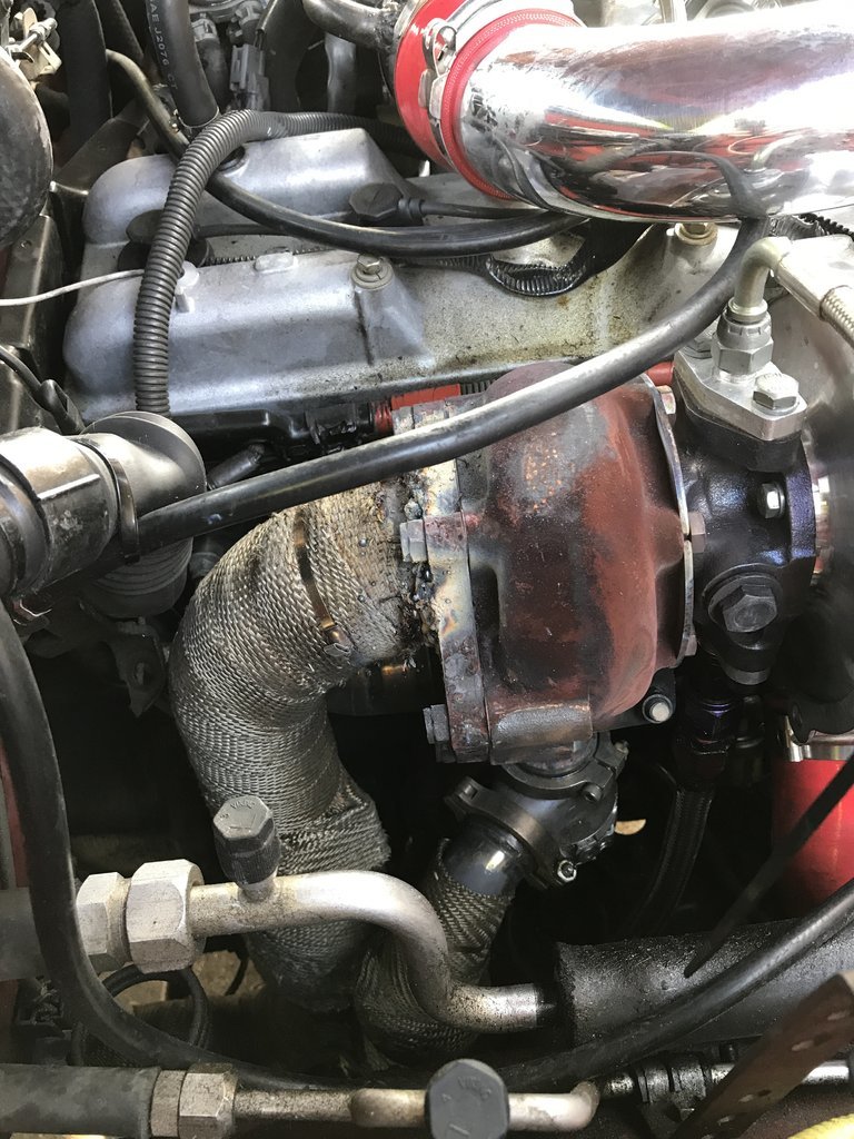

    Hopefully got the oil return fixed. It doesnt look great but function>form right? #lowesturbos #sweat4dayz

    Welds look good but i cant take credit for that. The other 2 fittings that were the 1st 2 times welds looked good too haha

    Hey so is my seal shot now u think or did the oil just build enough pressure to bypass the seal and possibly not damage it?

    Well the seal is more like a piston ring. With the gap up top. As long as you have good oil flow out of the turbo, and no PCV pressurized air pushing back up through the drain hose, then your seal is probably still good. Once you get it back up and running then you'll know pretty quickly if your seal is no good. Since we all discussed the clocking of your Center cartridge we are all in agreeance that it is at the proper degree, so that aspect is at least ready to go.

    Awesome, and i was kinda worried that i blew oil all thru my intake but it just went out the down pipe so i dont gave to take everything off

    Clean it down, then run it. Then inspect again.
