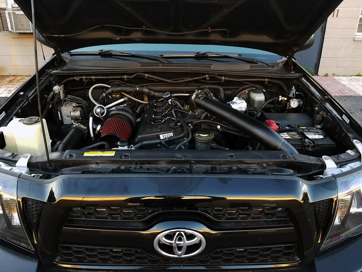

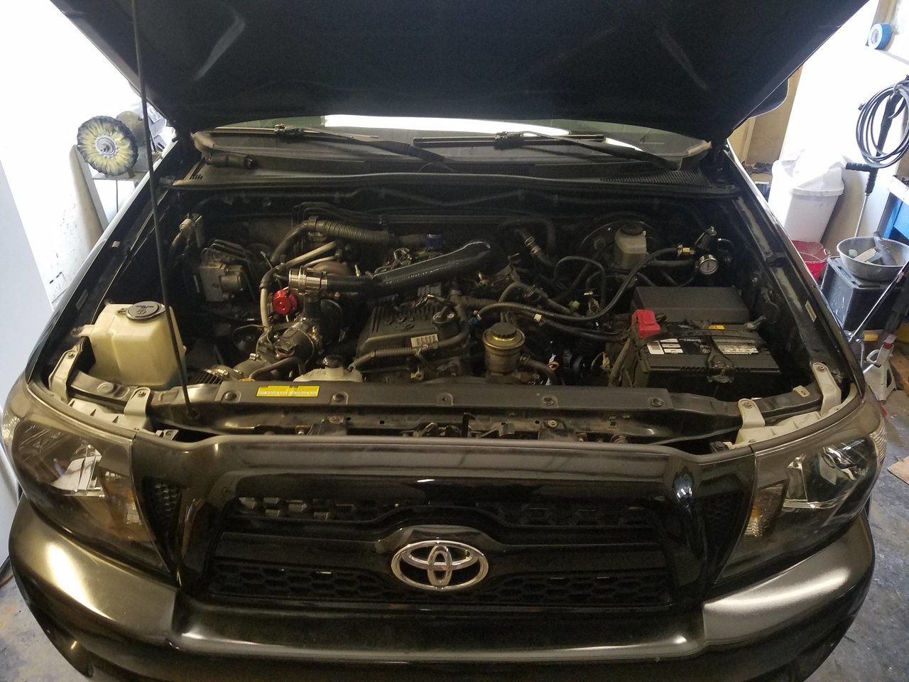

    Before and after. First time was still after heavily modifying the ozboost shit-kit to see if it can work
    boostedka, yota243 and MrCrowntown like this.

    Thanks @Torspd
    I just went on youtube and found those videos before I saw your post.
    Torspd likes this.

    Damn. That looks like a jumble of knocked off knock-offs.
    The quality difference is clearly evident, once done right.

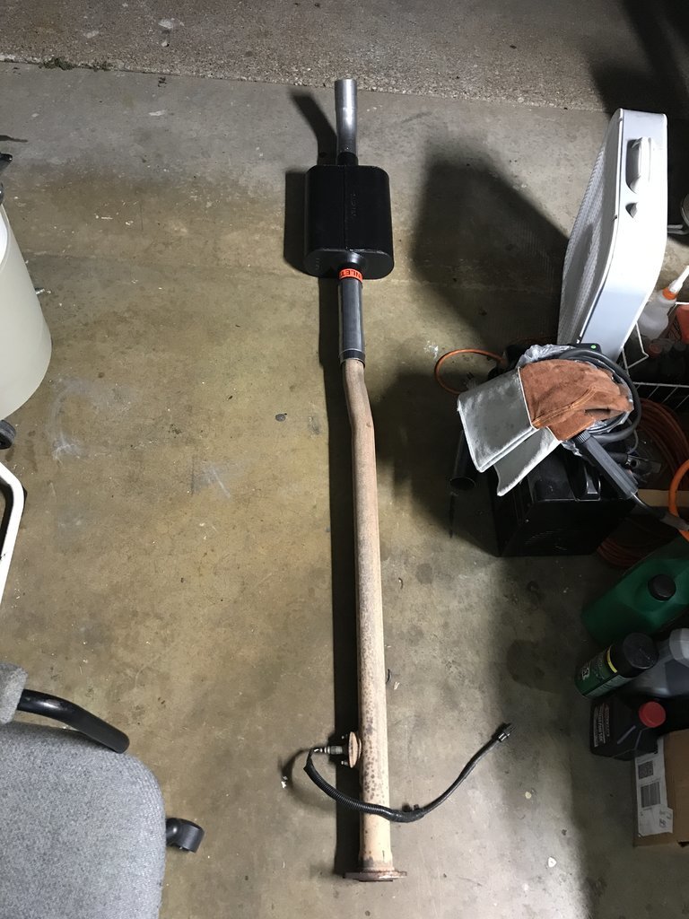

    This will be the new cat back as soon as I weld it up tomorrow. It will be turned right side up just turned down at the muffler. I hope that's legal :DIMG_5871.jpg
    MadTaco461 and boostedka like this.
