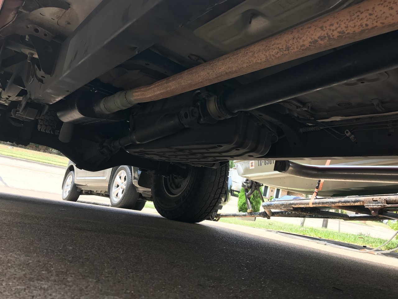

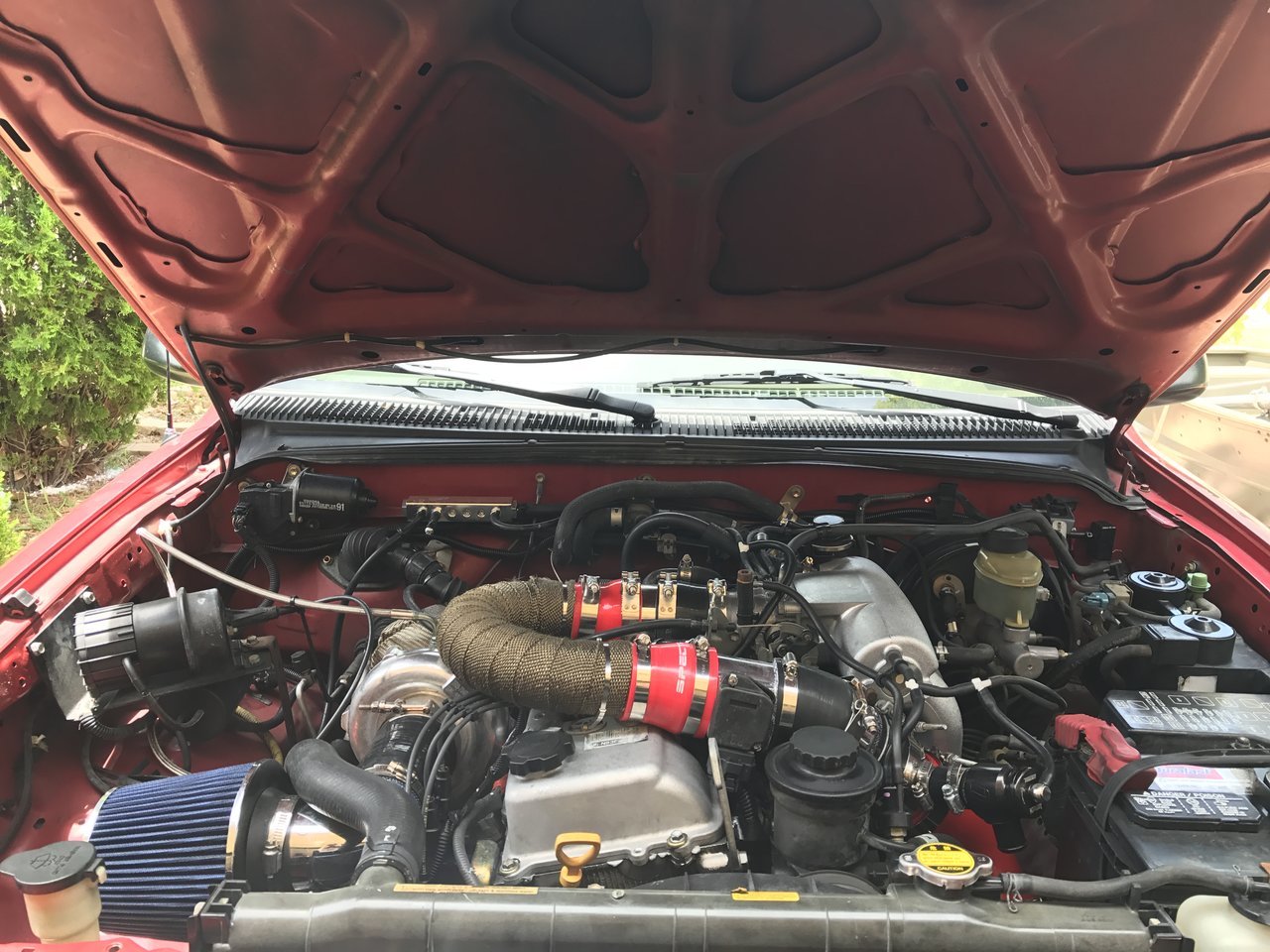

    Wrapped the intercooler pipe (suggested by boostedka thank you) and welded up the exhaust today. I really like the sound of the super 44 deeper aggressive sound but not raspy and not obnoxiously loudIMG_5873.jpg IMG_5875.jpg

    Clampco T-bolt, and/or bead roll the end of the tubing. If you cannot bead roll it, add some weld around the end, to make a lip.

    What I did to keep pipes from blowing off was I just put a few tac welds on the end of each of the IC pipes to give the clamp something to grab onto. I didn't have a bead roller. It's worked well so far.
