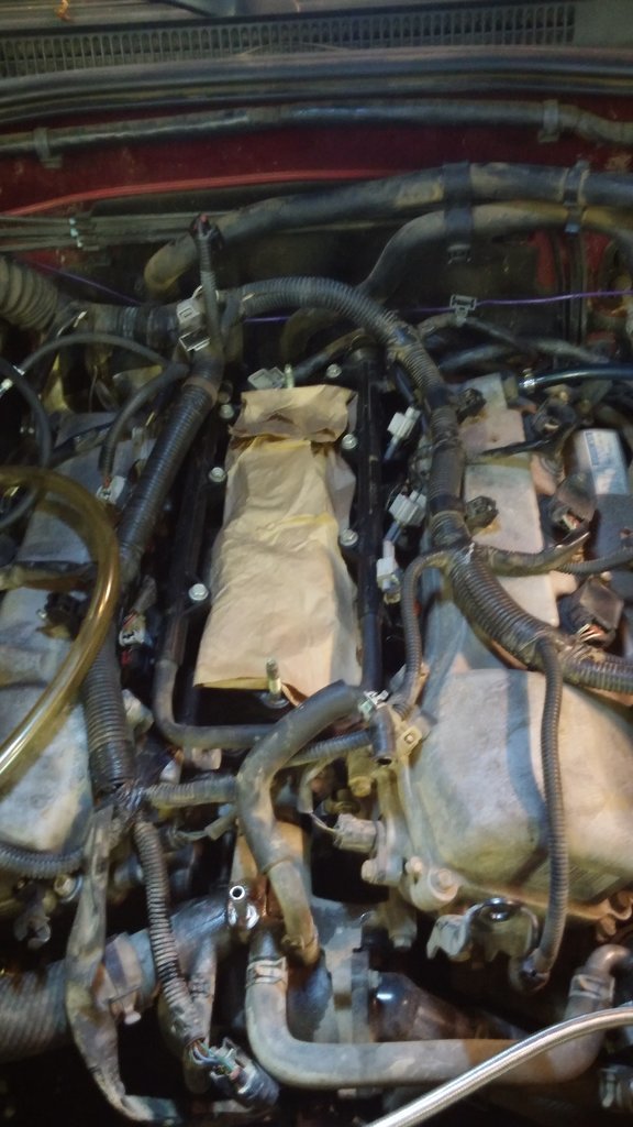

    Vacuum leak at the injectors :anonymous:
    MrCrowntown and MadTaco461 like this.

    E.J.
    north Alabama
    turbo 05 prerunner trd off road DC
    Bw s256 turbo with 3 in glass pack dumped pre axle raptor liner bed and top rails and fenderflares and rocker panels. Hunter side steps. Plasti-dipped upper fenders and emblems. satin black spray paint here and there inside and out. 5100's set to 1.75" up front . C channel front bumper. Maxxis bighorn 255/85/16
    Pro tip
    Cover ur intake runners and u wont drop stuff down them as easily

    So the orings on the urd injectors are well o rings, and the stock injectors had a big rubber collar; james said the new injectora just sit in there and the fuel rail hold em down to seal but obviously somethin didnt work right for me. Any cheat codes floatin around out there.

    Does the bottom of the aftermarket injector match that of the original injectors, where it slides into the rubber insulator? Take pictures.

    it does not slide into the rubber insulator. I don't have a pic but this is what the urd o ring looks like
    [​IMG] and the stockers have a flat sided o ring kinda like this

    If your aftermarket injectors look like the one on top, then you will always have some vacuum leaks.
    I will ask, did you swap the lower o-ring off, for the squarish insulator?

    no and gadget just emailed me back and said that I needed to do that... does anyone have like 6 of those spare isolators laying around?

    You don't have the ones which were with the OEM injectors???
