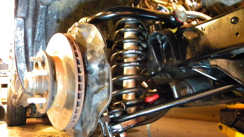

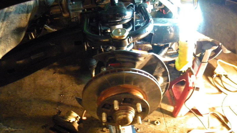

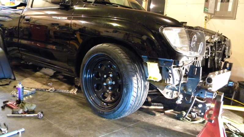

    Here's what I did last night
    Pulled apart the passenger side suspension, Taking off the UCA and ball joints.
    I picked up some UCA that change the geometry of the front taking stress off the ball joints when the truck is dropped as much as it is.

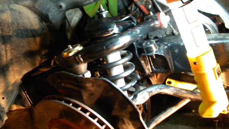

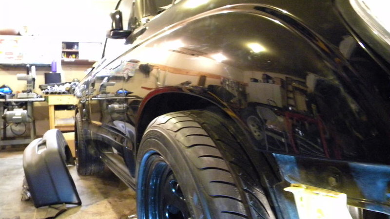

    Tonight:
    Finished bolting everything together with new balljoints, UCA, low pro bumpstops and flipped lower Balljoint. I picked up a can of VHT Epoxy all weather, and sprayed it on all my suspension components, we'll see how well it holds up. Everything went together real well, I'm just waiting on some steering rod ends and new poly bushings for my swaybar.
    You can see how much tire clearance I have. Almost none!;)

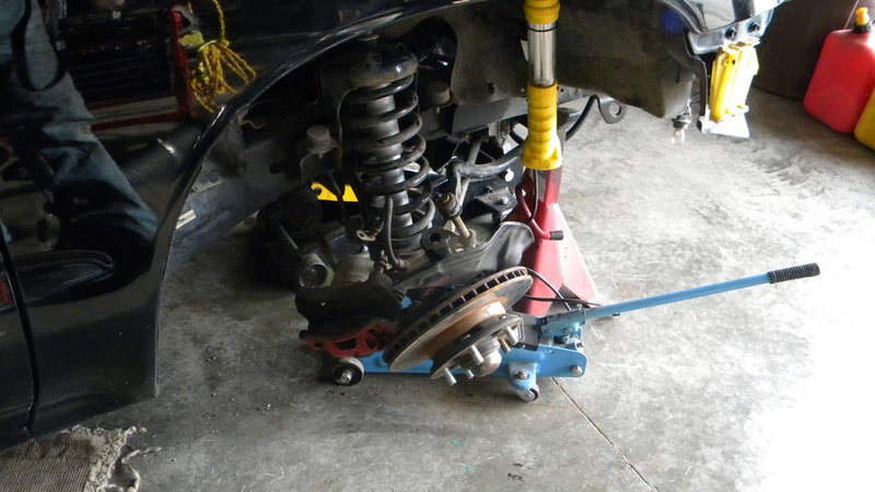

    Ordered all new poly bushings for the leafs, and swaybar. Today, im going to tackle the other side!

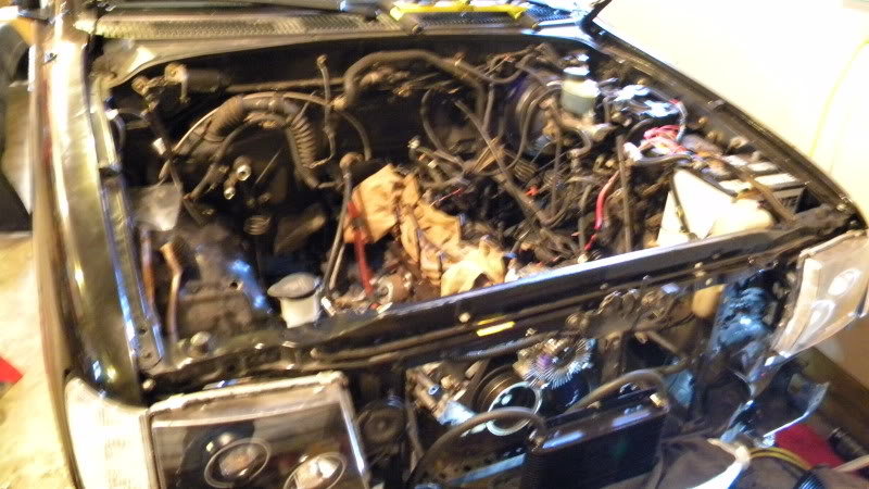

    Finished the drivers side today! Removed the AC system and started cleaning my block. Will post pics in the morning!

    Dropped the head off to get cleaned up today.
    Will paint block tonight and fix my balljoint issue. I promise pics this time!

    Clean-er! Minus AC!! Woooo
