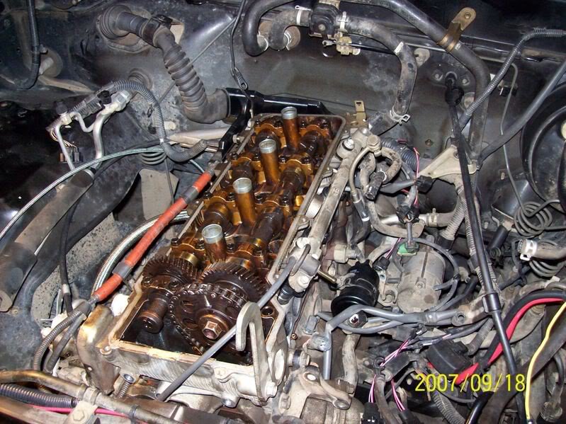

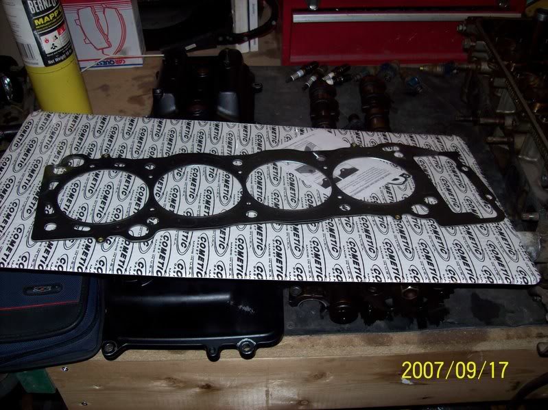

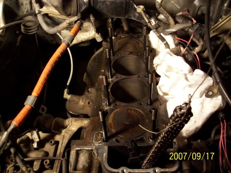

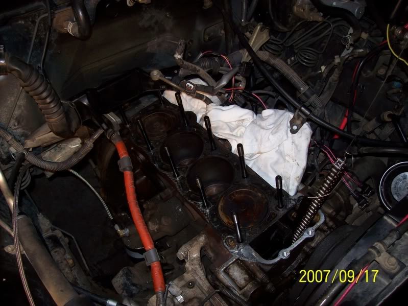

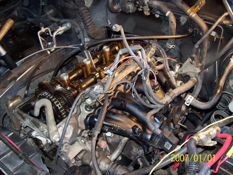

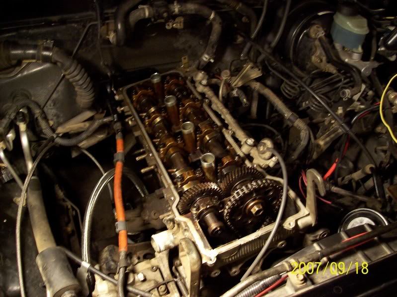

    K, update for the night. Got my ARP studs and Cometic 1.5mm Headgasket
    Studs Installed, the ones nearest the timing chain had to be cut to clear the cam gear
    Head Installed with cams

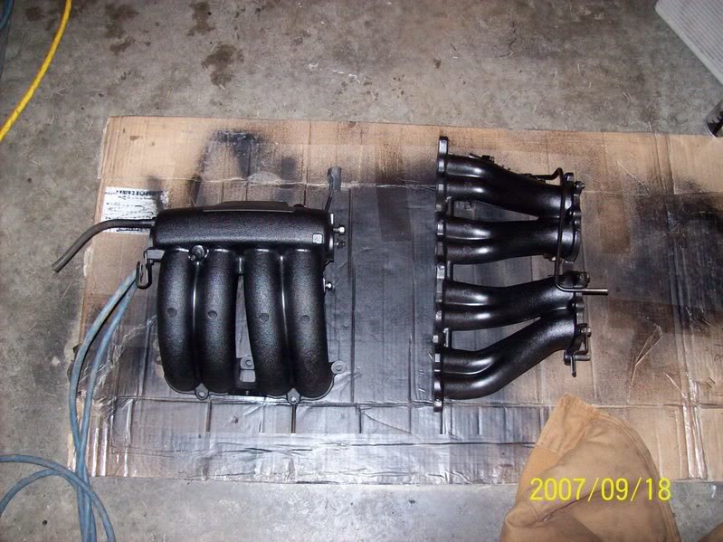

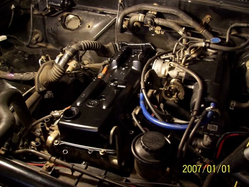

    Painted intake plenum

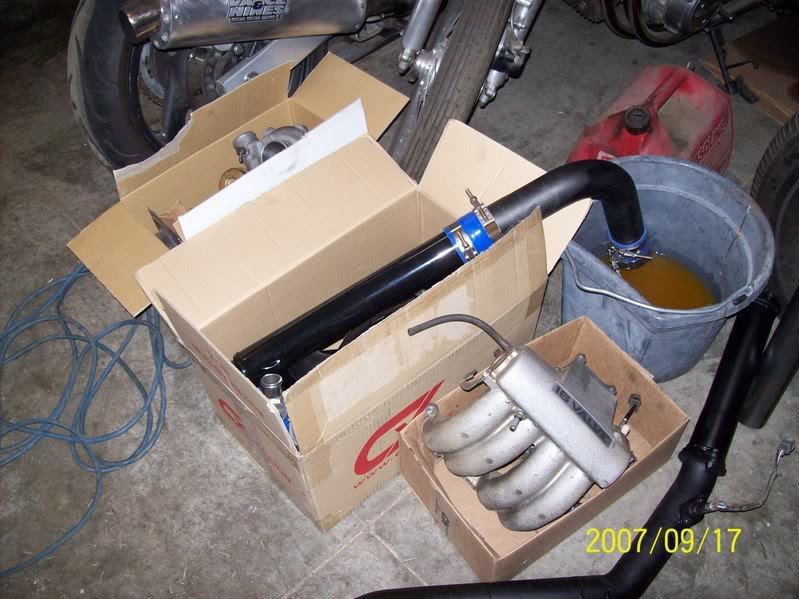

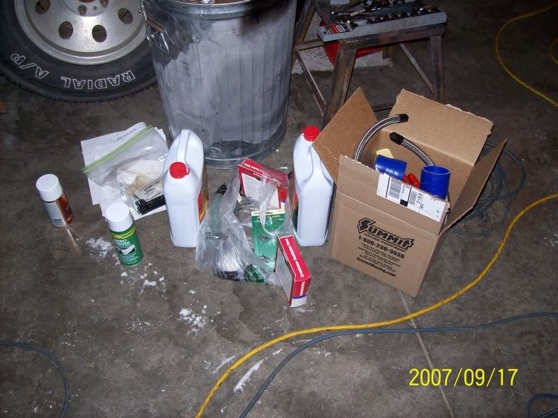

    Misc. Parts

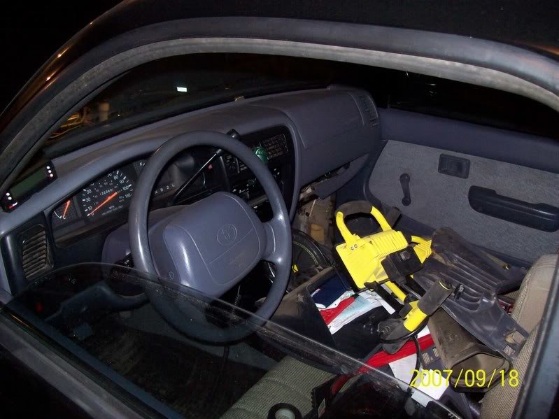

    My ohhh so messy interior
    It should be running by sunday night. Maybe not boosting, but running!

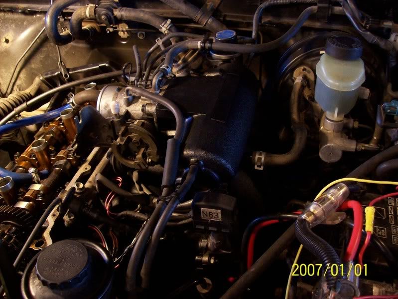

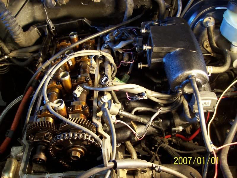

    Half of the intake plenum installed, routing wiring harness
    Rest of plenum, painted black

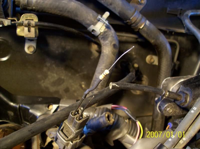

    Removed EGR, soddered 10k resistor in plug

    Painted valve cover, coil packs mounted

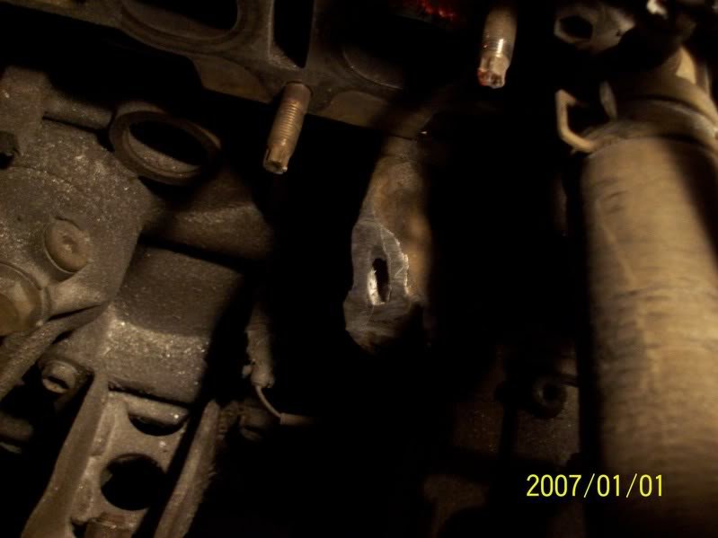

    Had to remove a bolt and grind down the AC compresser mounting bracket, in order to clear the manifold

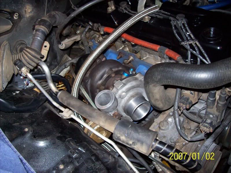

    Manifold on
    Plugs, wires, throttle cables installed
    TURBOOOOOOO!!!
