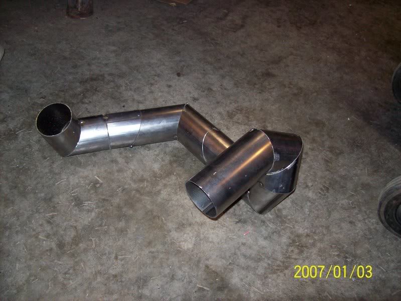

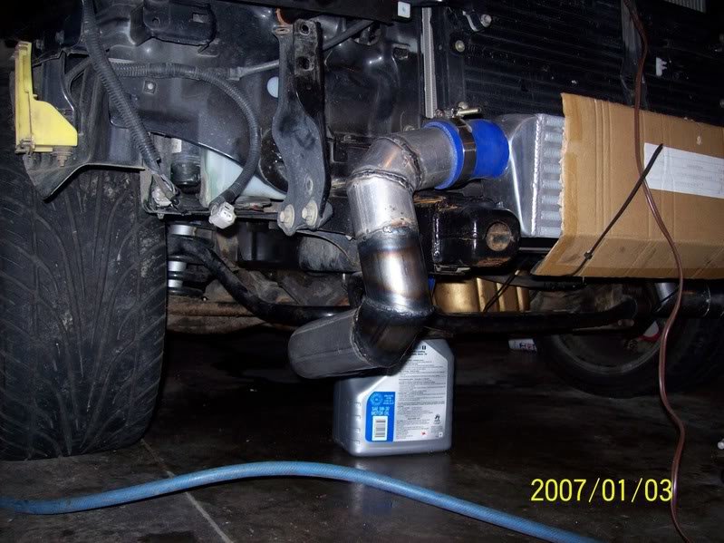

    Not any lower than the bumper. Im gonna finish TIG welding that pipe and i'll get more pics of it on the truck.

    Ok...Hard to tell from the pic. :)

    Yeh, it is. This took a while just trying to line everything up, but it should look good when its done

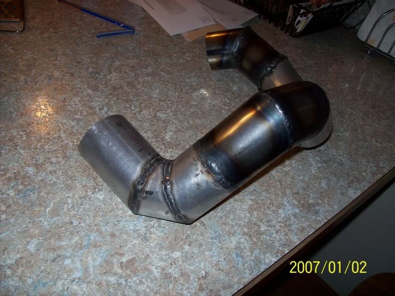

    Finished TIG welding the inlet into the intercooler. Will get pics later tonight!

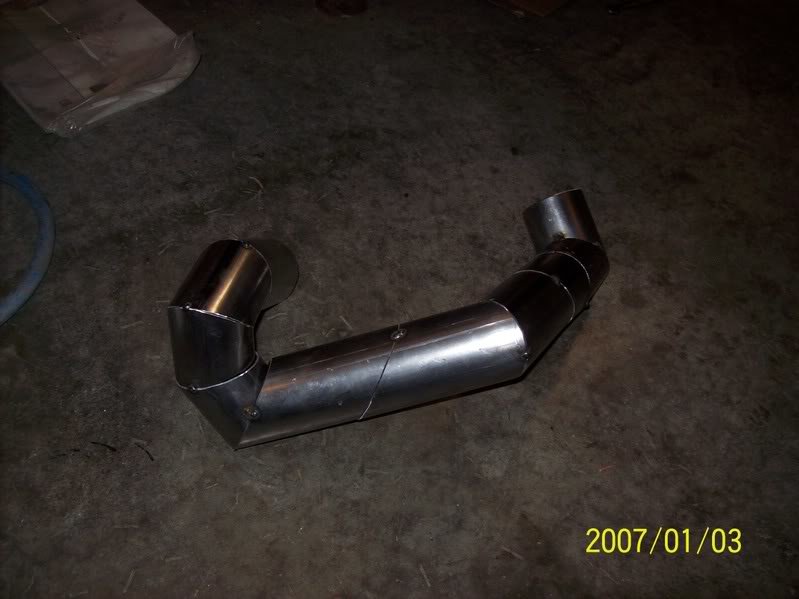

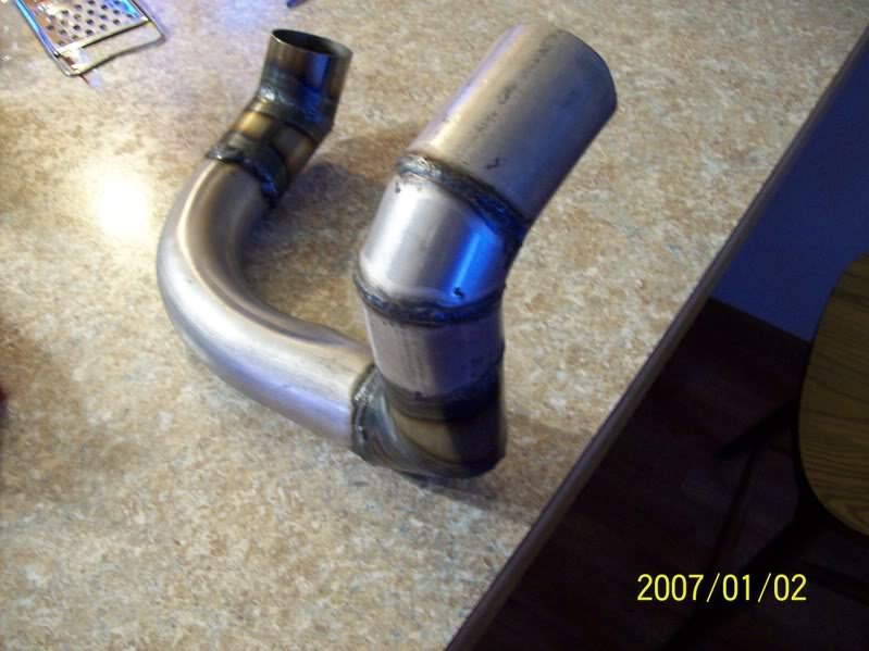

    Here is the passenger side pipe routed to the intercooler. Finished TIG welding it today.
    Drivers side tacked together:

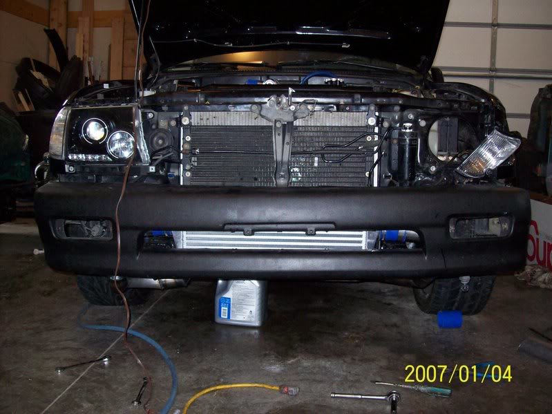

    The truck, sitting as of tonight:
