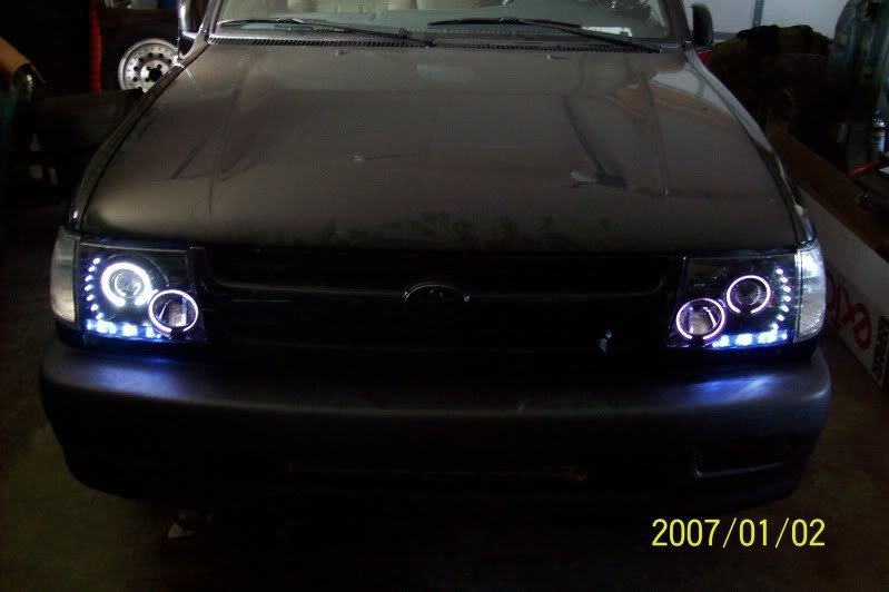

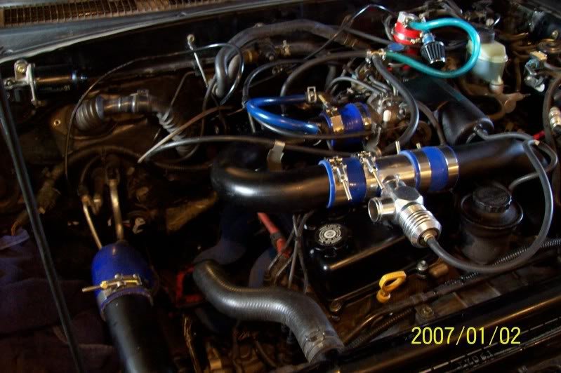

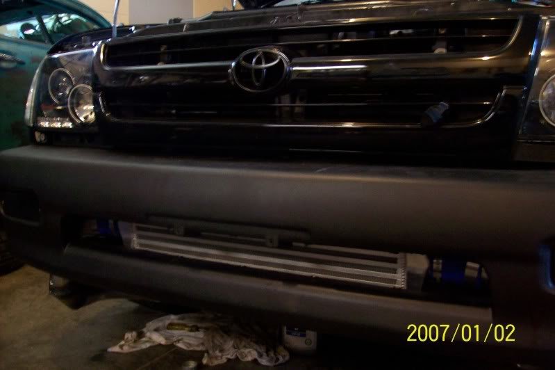

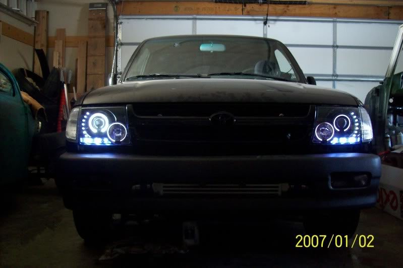

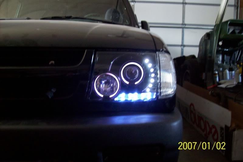

    Here are some pix as she sits
    Halos are not as bright as they should be due to lack of power

    Those are some damn good lookin headlights you got there.
